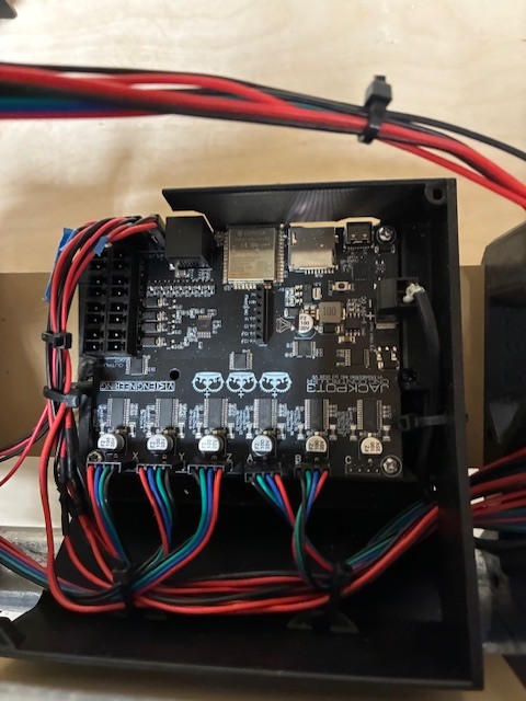

Sorry it took so long to respond. After a lot of rebuilds all limit switches are working in addition to i cleaned up the wires and that helped with the communications proble I was having. I did have two switches pluged into the wrong sockets. I am now at a point where I want to do a test cut but it isn’t clear if I am suppose to operate the machine from ESTlCam or import a g-code file to the Fludinc Web page. Also, on calibrating the belt the instructions say to make corrections to the config.yami file, I have been unable to locate this file. I am including a cleanded up image of my jackpot3 board

You want to connect it where the power supply goes into the Jackpot.
The layout of the Jackpot3 board indicated a row of 24V and 5V outputs am I looking in the wrong place?
Those are for triggering things. If you are adding a fan you want it on whenever the board is on. Directly to the power supply is best. Just piggyback it into the power plug.
