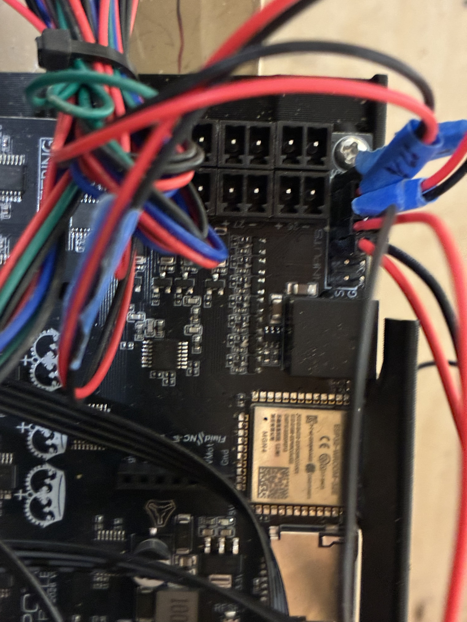

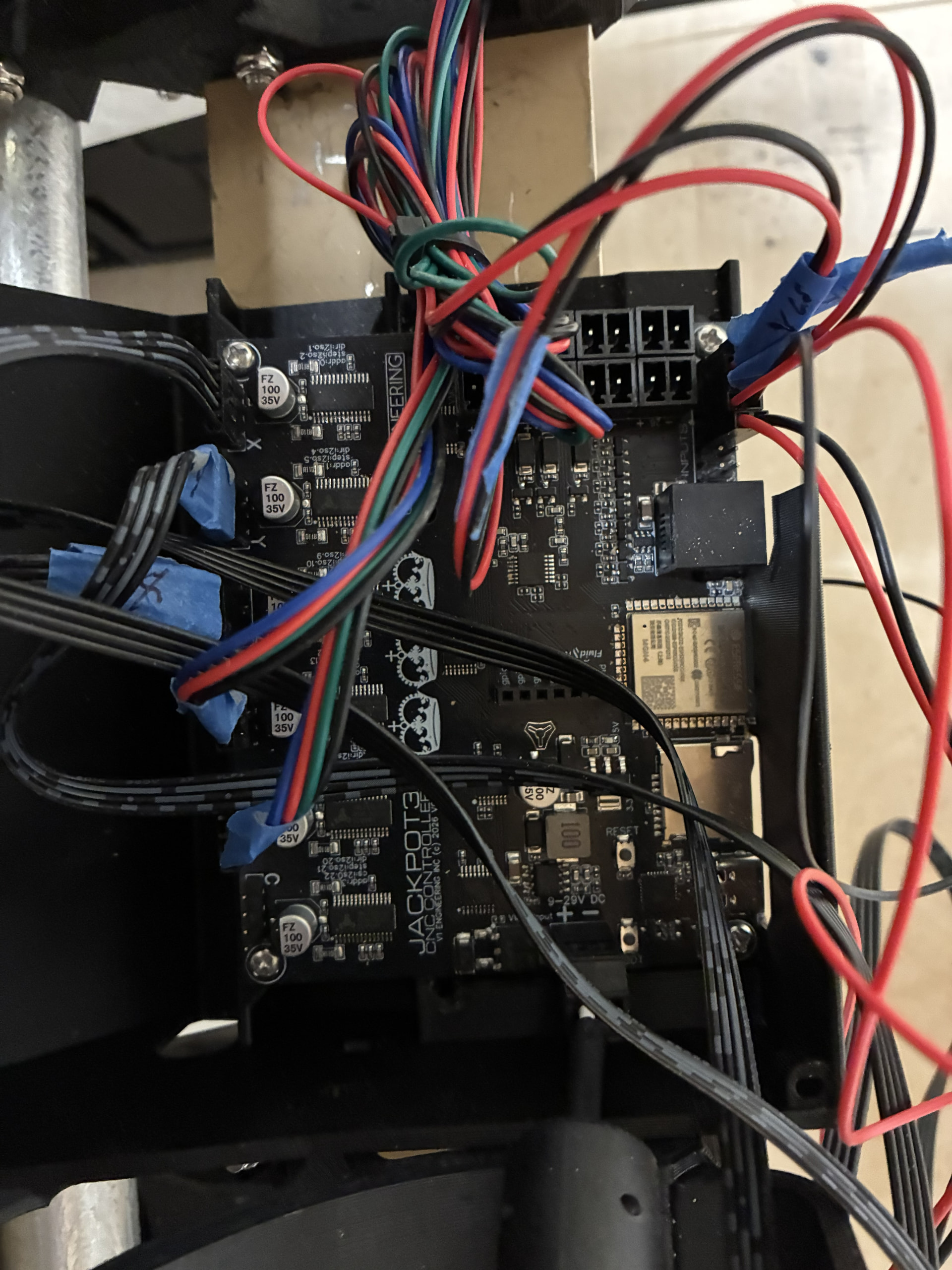

Can you post a pic of your board wired up please?

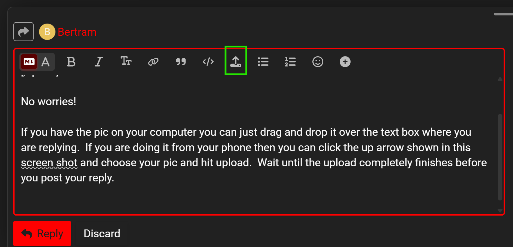

not sure how to post pictures, I am new at this forum stuff
No worries!
If you have the pic on your computer you can just drag and drop it over the text box where you are replying. If you are doing it from your phone then you can click the up arrow shown in this screen shot and choose your pic and hit upload. Wait until the upload completely finishes before you post your reply.
IMG_0960.HEIC.zip (991.5 KB)
IMG_0959.HEIC.zip (2.3 MB)
Here you go…
Your endstops appear to be wired correctly. Its very odd to me that you showed them open without triggering them, and then closed when you triggered. That is opposite of what you should have seen with your meter. Also if that was the case then you shouldn’t be able to home at all, it should stop as soon as you try.
