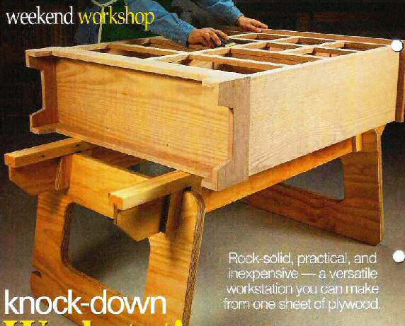

Okay, I’m going to try building the table with steel studs, and skin it with quarter inch hardboard. That should keep it fairly light, and the studs won’t warp, ever. If my math is right(hold onto your butts) I’m pretty sure I can build a 5 by 9 foot table with 5 10 foot studs and 5 4X8 sheets of hardboard. I’ll make the table fit onto a set of my shop notes saw horses.
Yeah sounds right. I got away with 4 sheets.
I chose to put the studs across the x (shorter axis with the steel rails). that way if the table sags or anything it shouldn’t matter as much. The wheels and material will/should follow the curve, If you do it the other way you might end up with a high or low spot…Hope that makes sense and my logic is sound.

Started the table. Put up a couple pics in the gallery.
