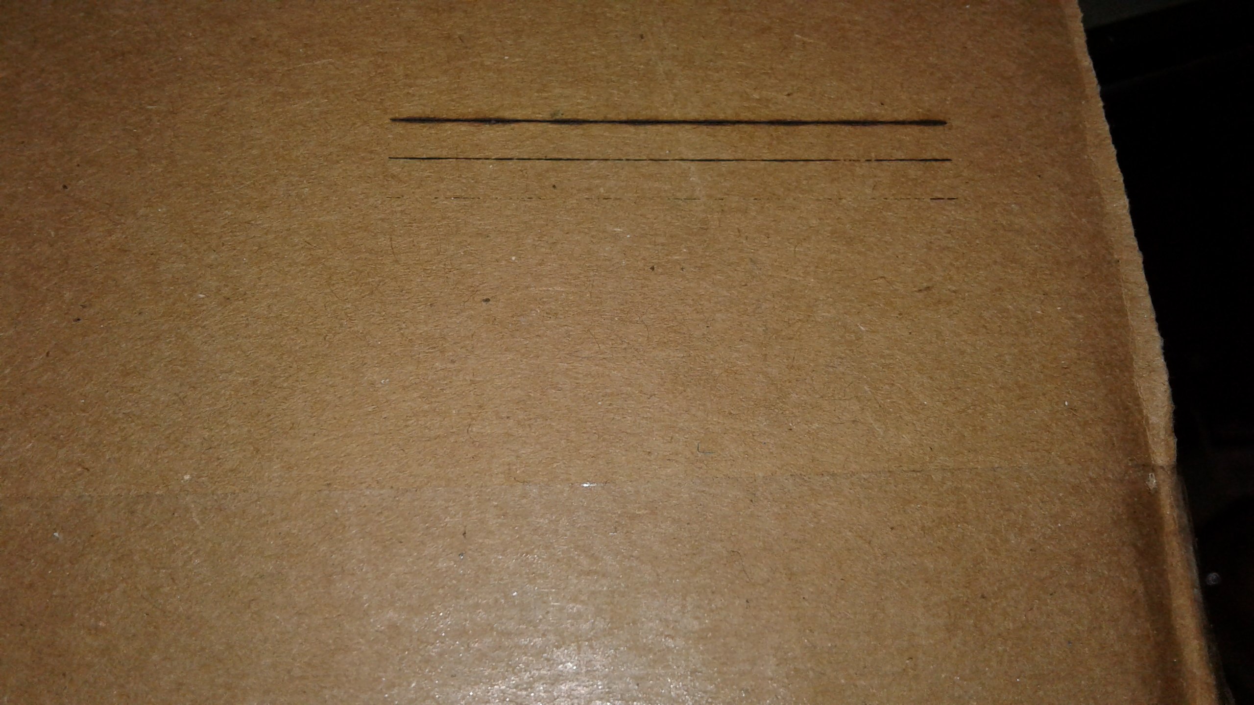

Thanks again David. I appreciate the second set of old man eyes. That was the continuous gcode with slightly different feed rates. I’ll try the original one (with Ryan’s suggested speeds) on cardboard and see if I can set the material surface at zero (I imagine that’s the smarter way to do this).
That’s more of a gradient for sure (cardboard).

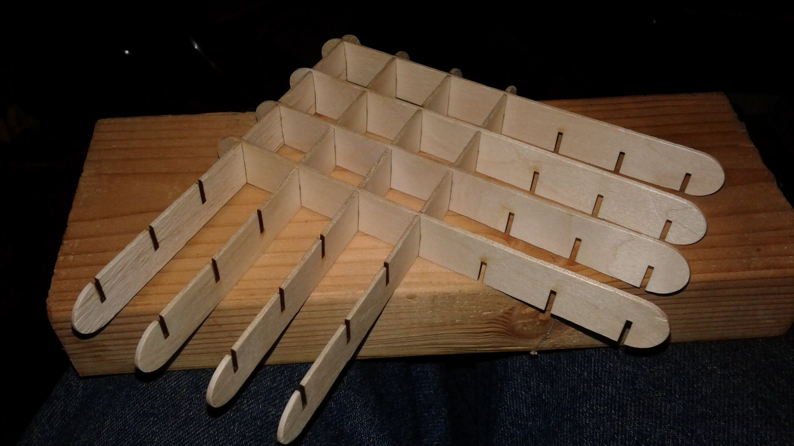

BTW the craft stick honeycomb “trivets” the cardboard is resting on in my photos were also cut with the laser in the same fashion… a single pass and 100 mm/min IIRC. Each 1.5mm thick craft stick (I think they are bamboo…) took less than 2 minutes to slot… allowing time for assembly while the next stick was cutting :wink:

Thanks for the tip! I’d been thinking about that as I was “playing”. I modified Ryan’s crown to play with papers and cardstocks. I had to go down to 25% feedrate (on the LCD) to get it to cut through the 100lb cover weight stock. I wondered if it might have cut through better/faster if it wasn’t sitting on a solid surface (cardboard). 50% federates almost went through but not quite.
The laser turned back on (and turned off) partway through the z clearance moves - which I know I didn’t need…so I removed them from the attached. In case others want to play with the file. Note I haven’t test cut this but at these rates I was able to go through standard copier paper at 100% speeds.
