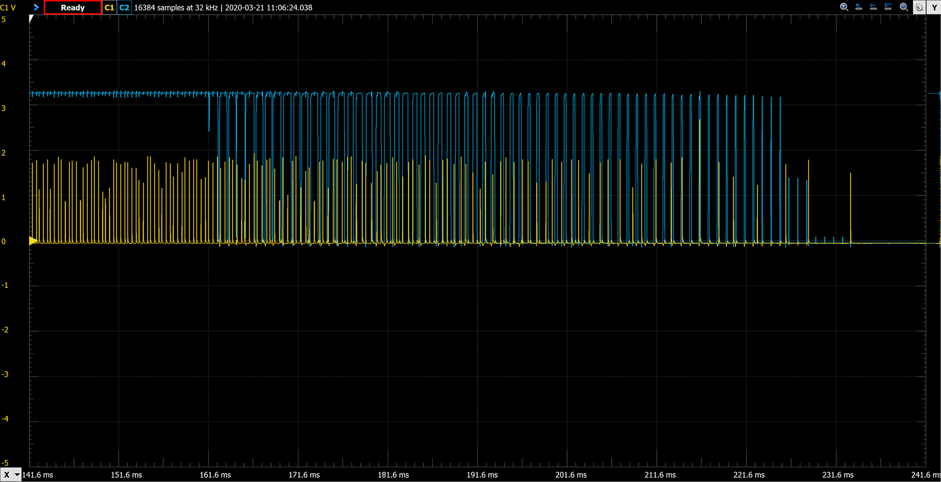

The reason your graph isn’t linear is because of acceleration, right? Can you do something like only measure the middle half of the move? Removing the first 1/4 and last 1/4?
But that is good. Ideally, it would be reducing the laser power when it isn’t going the requested speed.
I don’t think so. I’ve removed acceleration and I still see a non-linear graph. And my data collection system in the microcontroller also only looks at the bottom (fastest) 100 data points (out of thousands) to gain the fastest speed it is running at.
I think it is some odd behavior from their extrusion calculations, but I’m seeing great results across acceleration. Hopefully I’ll have some nice pics of the oscilloscope tomorrow mapping laser power PWM to XY stepper values - which will show how power and acceleration are aligned. Or not??? We will see.

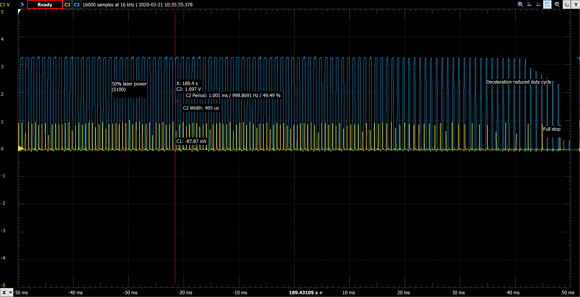

Anyway - it’s working, and the results are as I had hoped:
Yellow is the stepper pulses, and blue is the PWM converted output. In this sample, I was running gcode set to 50% power (S100), and the conversion is nearly perfect.
This pic is even clearer - it shows 100% power decelerating:

I then set up my oscilloscope to watch the laser PWM pin (which is D6) and the X stepper pin, and tried the M3 commands. To test, I set up a series of M3 commands to turn the laser ON/OFF, and move X and Y steppers to see how the signal works:

When I look at the scope, the laser pin is tightly aligned to the motion queue of the steppers, so that is great news.
However - the signal does not vary based on acceleration. It does align timing, but it does not change the pulse based on the overall speed of the gantry - it is a fixed burn signal. If no movement is in the queue and you use M3, the laser just turns on and sits there at power, further showing it isn’t monitoring movement speed.
UPDATE: This is wrong. If you use the new S parameter on G1 (G1 X10 Y10 S50, for example) the laser PWM changes with acceleration.
