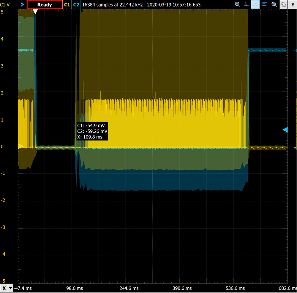

So I decided to throw my oscilloscope on this and take a look. I put one probe on the STEP pin, and the other on the various different LASER pins I was trying (FAN vs. generic pin) and saw:
  1. Any time the queue is empty, there is a delay to get it started again. It varies from 15-110ms and for some odd reason depends on what gcode occurs later in the stream (so maybe overhead processing the commands into the queue?)
  2. G4 will always drain the queue, which creates the starting delay on next movement
  3. Adding a G4 and the end of an operation adds an exit delay of around 30ms
The above has a couple conclusions:
  1. If directly manipulating pins (M42) using G4 P0, you add 110ms delay between pin change and starting stepper movement, and 30ms of delay between stopper stop and pin change. No good for lasers.
  2. When initially starting the laser, if the movement queue is not primed (even when using FAN) you will see the the delay. To avoid this delay, make sure the machine moves to some position prior to starting the laser. I’m sure nearly all gcode naturally does this, simply moving the laser to the start position.
And as expected, the fan pin pays no attention to acceleration/deceleration.
For those interested in the trace, here is a picture when starting the laser on FAN but without the queue primed with a decent number of gcode lines in the operation:
The yellow line is the stepper pulses, and the blue line is the laser on/off (off high, on low). You can see the 109.8ms delay in this capture between laser on and stepper start.

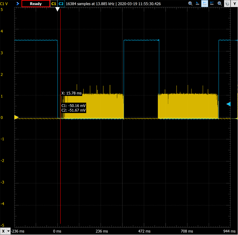

And here is another trace, this time with a simple gcode (resulting in a shorter on delay) that shows the well-aligned laser on/off but does show the issue with acceleration:
So, no real meaningful discovery here. But it was fun to see it visualized and confirm what you all already figured out!

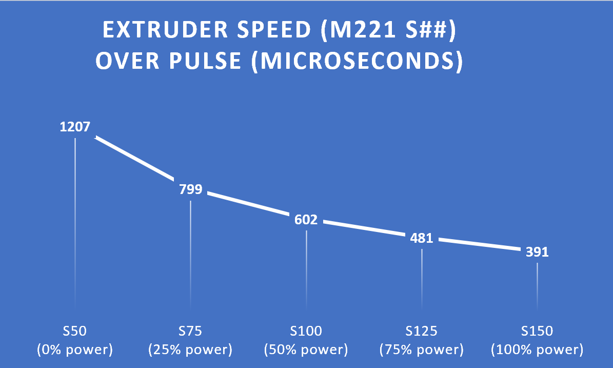

Jeff was totally correct on acceleration. It is controlled by whatever the slowest acceleration in use is. So setting E acceleration to XY, or anything higher, keeps all acceleration the same as XY.
I also proved that the relationship of distance to speed is linear to extruder for constant pulse timing. So calculating for E is as simple as using a slope of 20 (given the values I’m set up with) so it’s just SQRT(X*X+Y*Y)/FEEDRATE*20*100. I now have a very consistent pulse analysis based on a laser power setting (using M221 S50 for 0% thru M221 S150 for 100%).
Interestingly, when steps are running fast or high multiples are used (such as M221 S200) the pulse width can have a bit of variability - like 20-30%. This required doing some running averages to eliminate that noise.
But the results are impressive and wonderfully consistent:
The only step remaining is to convert microseconds of stepper pulse rate to PWM and then we can see it on the scope and try driving a laser. And I need to refactor the code as it’s a mess right now with all the hacking I’ve been done. But once it’s working, I’ll push it up to github should anyone wants to set up an ESP8266 and give it a shot.
