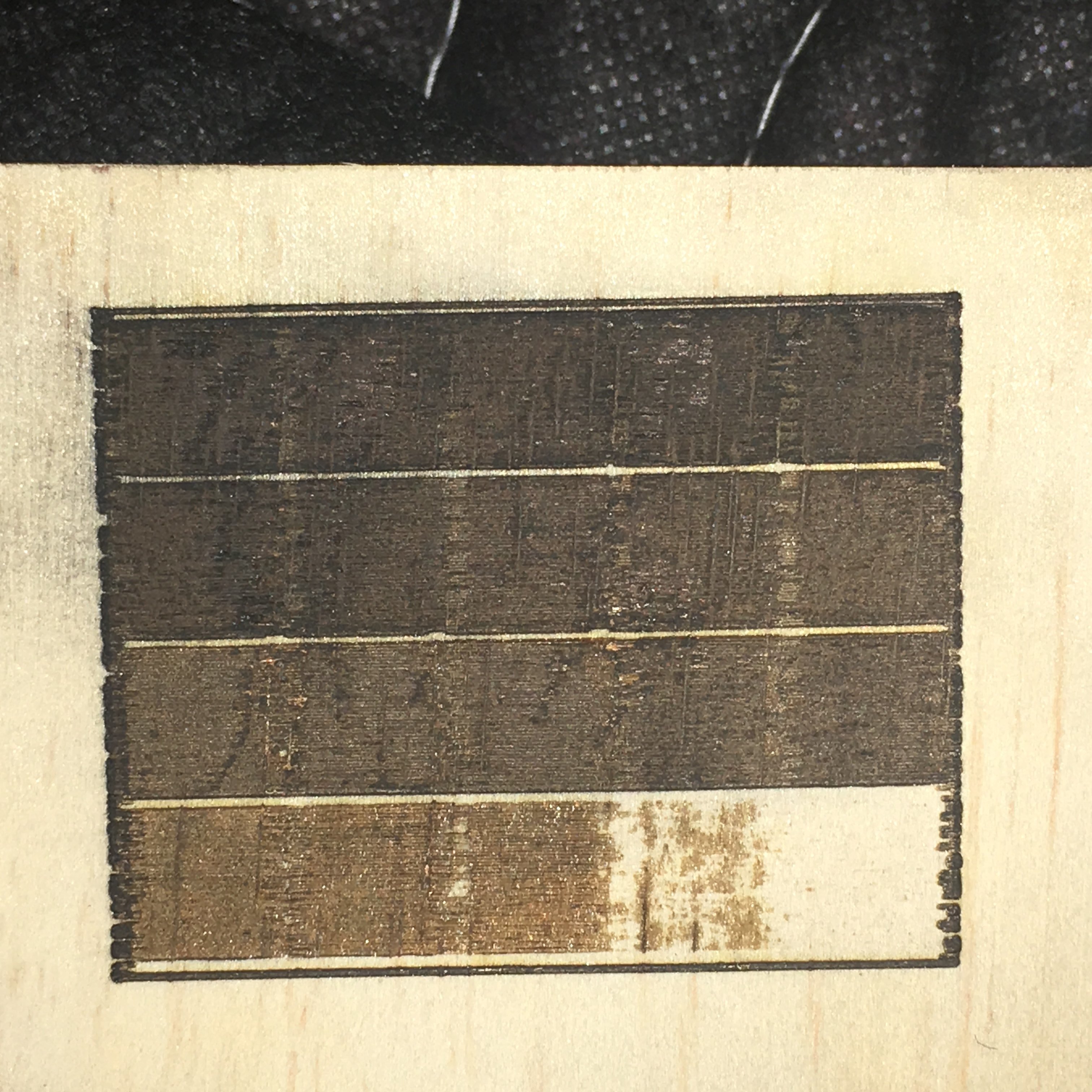

Thanks Aaryn. That’s a great thread. And thanks for the link to the speed/power thing. Saved me creating one from scratch. I’ll keep digging through but wanted to share this image of the test. Looks great to my eyes for a virgin setup and definitely gives me a great stepping off point for troubleshooting and tweaking.
[attachment file=87239]
Okay. So I’m still a long way from where I want to get but I think I’m heading in the right direction. The bottom band is a file with the feedrate and travel speeds both set to 12mm/s. I thought maybe if I sped it up a bit it would lighten so I made the second test there with both speeds set to 15mm/s. I didn’t see a noticeable lightening and actually saw some noise coming into that light area to the right. Also, the machine was stuttering during all of the transits on the x axis. Like it was slowing down to burn even though the speeds were set to match. I went back to the 12mm/s file and just let it run so I could see what sort of luck I had with the details. Kinda streaky…
So it’s way over burned in general. That’s one issue. It’s also streaky. I left the min max in Image2gcode set at 0 and 255, chose “sharp” instead of smooth and resolution at .1mm (could this be one thing I need to change? I have no idea what size ‘dot’ I get from the laser)

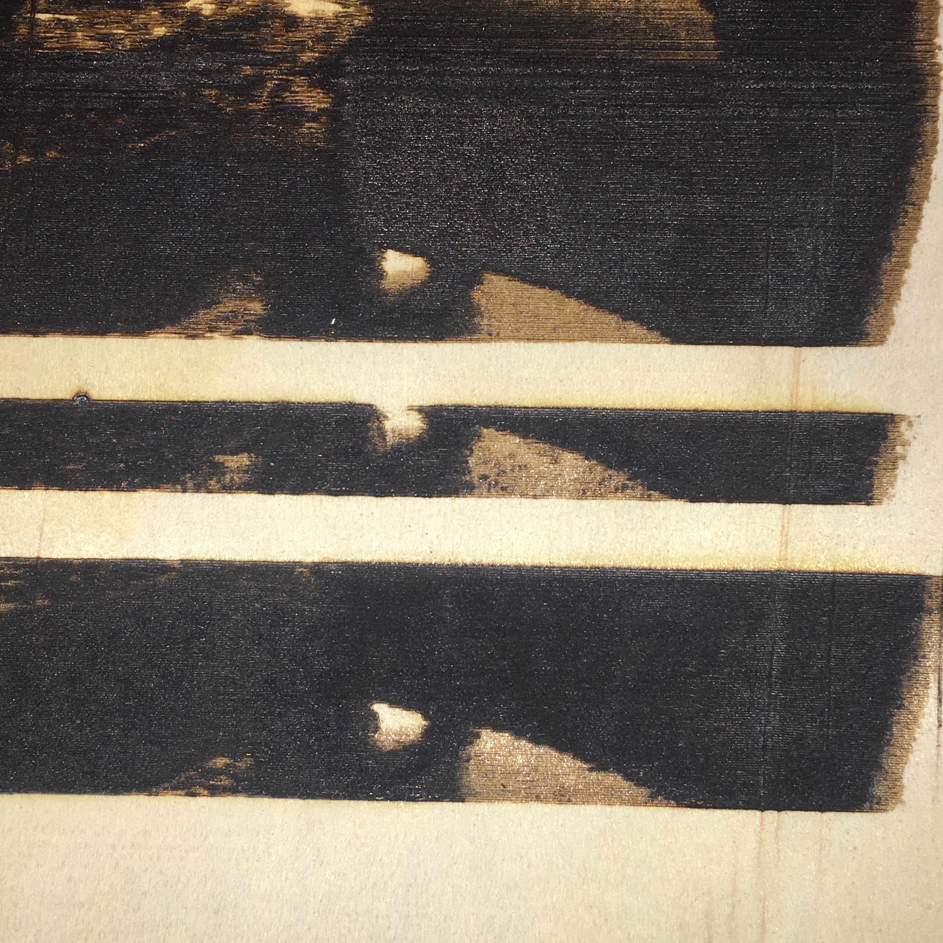

I’ve decided I need a better and faster to run test file so I’ve created one and it’s running right now. I’ll post it before bed here. In the meantime here’s these pics…source photo included (I know it’s not the best in terms of contrast…but I would think it should make a nice engraving still no?). Oh, and the ‘oops’…I bumped the plywood moving a fan around in the enclosure right near the end of the run. D’oh!

Pretty dark. I’ll play with this at different speeds and see what I get. This was 12mm/s again. Source image here as well. Those are 5% increments in black, starting top left and going back and forth like a snake to the bottom left corner at 100% black. Or vice versa. The pic flipped when it posted… [attachment file=87285]

Just wanted to add…I thought maybe I should try wiping that off in case there was a bunch of soot on the print and sure enough there was. The gradation was way more visible than without having rubbed it off. How is everyone clearing that off the print? Does the “air assist” help with that? I’m firing up the compressor to blow off the next two tests (15mm/s and 20 mm/s).
Before the rub:[attachment file=87291]
Something still is not right with that.
Running one now at 10mm/s but with the max power slider down to 200. I’m assuming that 50% power would then be 100 as opposed to 127.5 if it were left at 255. It’s about halfway through.
The 15mm/s gave better gradation but got pretty streaky and the vertical edges were not sharp at all. The 20mm/s was pretty messy. I thought maybe my belts were causing the jitters but it doesn’t appear that way. I just watched one of David’s old videos from 2016 on a cardboard pizza box and am nowhere near those results. And he said he was running at 50mm/s!!
Here they are in all their glory. Not sure why the perimeter line is so jaggy. I wonder if it’s because of the grain of the wood which is running perpendicular to the vertical lines there? At “full” power there’s some bleed in the burn. I’ll double check the focus.

I am curious. is your laser lens firmly in place? I noticed on mine it is loose where I can turn to focus it. When I touch the focus it will move the beam about a millimeter. I was worried it might be loose enough to cause the beam to jitter as it moves. I haven’t seen it happen yet on my machine but I would guess these pictures are similar to what it would look like if the lens was bouncing around. Maybe not. It only seems off in the X direction.
Oh wait. Are you using M03 or M106 for your laser control?
Interesting- I’ll check that in the morning and let you know. I’m using 106/107.

KellyD, I think you are running way slower than you need to… if you are getting full power from your laser (which I think you are, based on the charring you’re seeing…). There may be other things going on with your machine as well IDK… but ASSUMING that my machine is anywhere near accurate I’ll probably need to reduce my power and/or speed up my travel/feed rates. But I am truly impressed with Victor’s ImageToGcode converter – best I’ve seen yet – and it runs on my pretty-stock Marlin-based MPCNC!
