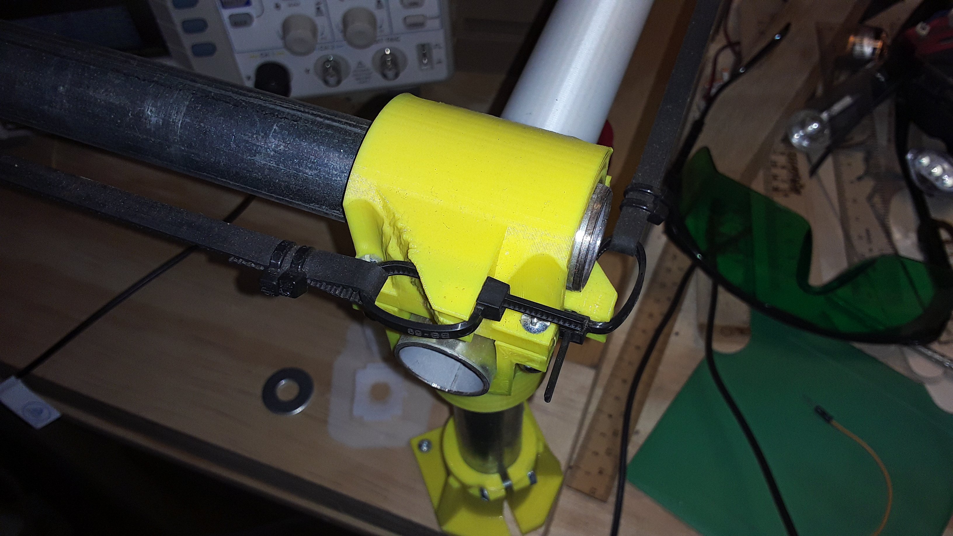

Heres the flex on my zip ties. Should I snug them down? I see a bit of snugging needed on the front x axis zip tie. Perhaps they all need a notch or three on the zip tie?
Kelly, I believe your corner pieces are on backwards… though I’m not sure what the effect might be. The tie points for the cable ties should look like this
[attachment file=87472]
and
[attachment file=87473]
Ryan makes a point of this (https://www.v1engineering.com/base/) in the assembly instructions… so, Ryan, if you’re watching this thread at the moment, what are your thoughts?
As far as the belt tension, it looks like they could be snugged up another notch or two IMO…
– David
Agh! My secret is out! Hahaha. I forgot about that. I HAD them the right way, then second guessed myself and swapped them and by the time I realized I was right in the first place I deduced it wouldn’t matter. Could it be enough to be the culprit you think?
hahaha. Too funny. I’d completely forgotten about that.
