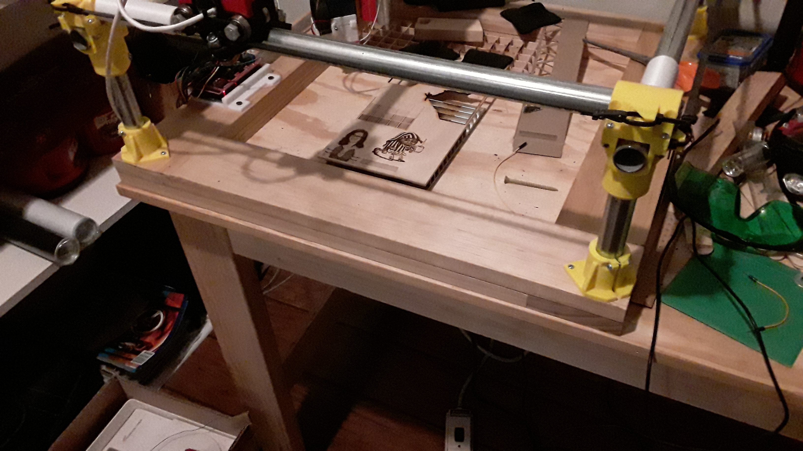

Pictures of your machines might help. Here’s mine for reference… smaller form-factor MPCNC (24" x 24" footprint), relatively heavy laminated 1"x4" base, feet solidly fastened, and even the workpiece is weighted down with a couple of little BB bean-bags
[attachment file=87633]
Otherwise, I’m stumped. – David
I did not notice any shaking, vibrating, or moving of the machine during the operation. The machine is very secure to the table and very solid. I haven’t had any problems when using the spindle or a pen. The table is built from 2x4 lumber and 3/4" plywood and is very solid, but it is on casters. The MDF was not fastened down, but I did not visually notice it moving at all. I recorded some video while it was lazing but I’ll have to upload them tomorrow when I have access to better internet. My home internet is dreadful.

I think your problem lies in the firmware on the miniRambo. In a lot of cases, they use the FAST_PWM_FAN option in the firmware, which will cause the PWM signal to be very bad in terms of the ability for the laser driver to see it and react accordingly. It is important to make sure this signal has the correct PWM frequency (under 5KHz) as well as not have tons of noise on it. The signal should look like David’s post from above. The RAMPs board with Marlin seems to have less problems than the miniRambo in these issues.
There is a post here on how to update the firmware for the miniRambo.
I suggest using the firmware you have and not the Lulzbot version, but it should have some reference to the “fan” in it. It should be easy to see if it has the same problem as the #define FAST_PWM_FAN in the config.h file. If you have a link to your firmware, I can take a look at it as well and see if I can deduce something. I think this is going to be the main issue.
Also, if there is a lot of noise on the signal then it could have problems. Make sure your ground is very good on your connection.
If you don’t want to mess with firmware, then possibly switch to a Ramps board with a known good firmware like on Davids machine. I know the Ramps board is very good for the laser.
