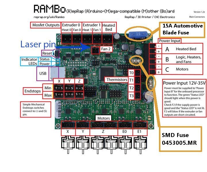

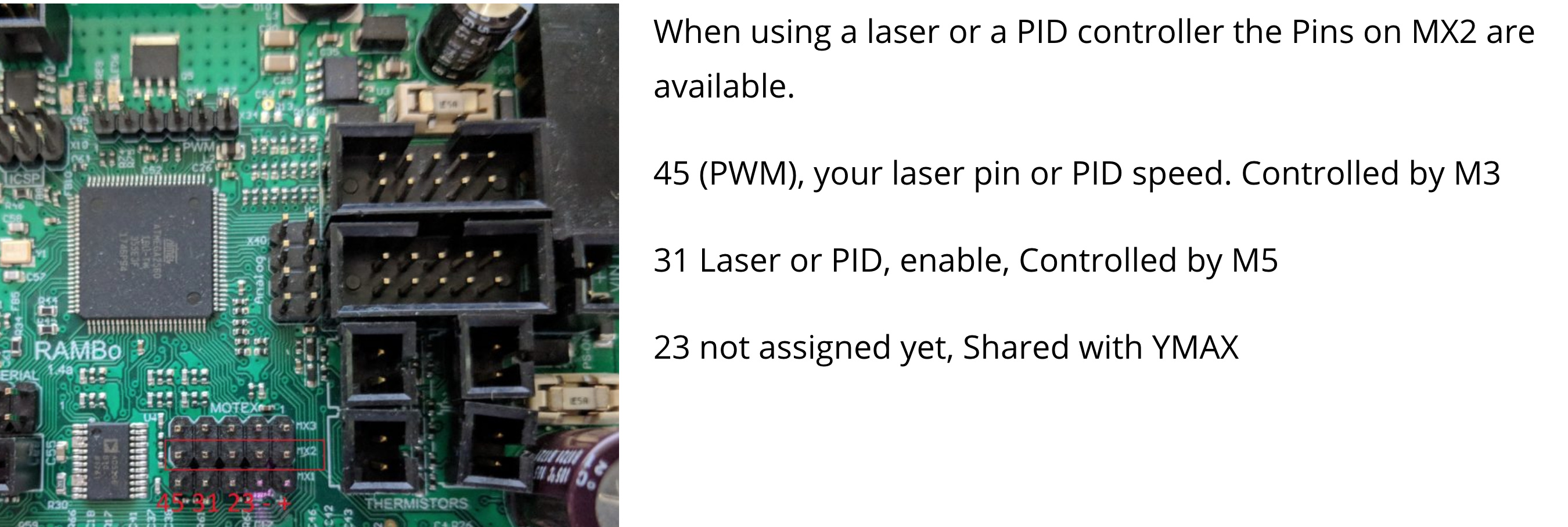

Hey Guys… it’s been a few months now I have one final question. After replacing Marlin.cpp and re-compiling the firmware, which of the fan ports are you using for the laser? Is it “45” as in a previous post from Ryan or Fan 2 from another post? I’m using the Rambo 1.3 board. I can always get out my meter or my oscope and test but thought I’d ask here for a simple answer. Sorry, mental lapsing is appropriate for my … um, what were we talking about? :wink: LOL
PSS SORRY THIS POSTED 3 TIMES… couldn’t get it to respond got an error several times. Admin can delete any two he wants to.
Hey Guys… it’s been a few months now I have one final question. After replacing Marlin.cpp and re-compiling the firmware, which of the fan ports are you using for the laser? Is it “45” as in a previous post from Ryan or Fan 2 from another post? (see enclosed image) I’m using the Rambo 1.3 board. I can always get out my meter or my oscope and test but thought I’d ask here for a simple answer. Sorry, mental lapsing is appropriate for my … um, what were we talking about? :wink: LOL I’m trying to hook up my Endurance 10W+ laser which uses 3.5-12V for ttl.
Hey Guys… it’s been a few months now I have one final question. After replacing Marlin.cpp and re-compiling the firmware, which of the fan ports are you using for the laser? Is it “45” as in a previous post from Ryan or Fan 2 from another post? I’m using the Rambo 1.3 board. I can always get out my meter or my oscope and test but thought I’d ask here for a simple answer. Sorry, mental lapsing is appropriate for my … um, what were we talking about? :wink: LOL I’m trying to hook up my Endurance 10W+ laser which uses 3.5-12V for ttl.

Hey, Mark. Did you ever get an answer to this question? I’m also starting to setup my laser module and I’m confused like you.
Thanks!
-Jeremy
Jeremy…
No, guess people have moved on… I’m going to try setting it up then testing with my computer and a VOM meter to see which pins go high when I type commands into the RAMBO via my computer and Pronterface. If you get any more info share it and I will too! :slight_smile: It kind of looks like they had further troubles but the thread is so long I can’t follow it.
Hey guys. Sorry for not chiming in sooner. I’ve been reading the posts but you’re working with a different board and laser than I am so I don’t know anything I can tell you from my setup would have any value. I hope to be in the shop tomorrow and can try to look (I’ve hard-boxed the electronics on my setup so not sure what I’m going to be able to see with ease).
Giving advice on laser is extremely difficult unless someone has the same exact one. If your board can handle 12V for the signal you can just use the fan port, this is explained on the laser page, if it needs 5v all boards have at least one available pin laid out on there setup pages. Not too many people want to make guesses as with lasers it usually results in instant wasted money if it is wrong.
So George Formitchev answered me that the TTL input on their 10W+ Laser can handle 3.5-24 volts with no problem, so 12v will be a breeze! :slight_smile: Just an FYI!

Mark, hey how are you doing with your 10W+ laser from Formitchev? I have the same. I kind of have things working well, but they could always be better. I’m using the RAMBo 1.4 board.
Ken… I wish I could say I have it dialed in… but truth be known I’ve not worked on it in a couple of months. I got panicked about keeping my house insurance and had a ton of things to do to keep it. I’d be more than thankful if you’d share with me what you have done to get yours up and burning… My MPCNC is literally covered with dust and I’m SOOO ready to get going again!!! Any help / advice would be great, seems like a lot of people have moved on to different things. Sorry I can’t be more help Ken! But again, what steps did you follow and what Pins did you wind up using?
