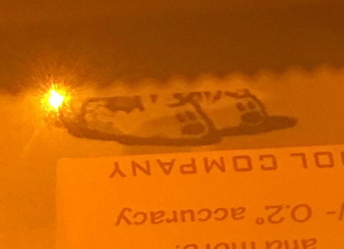

Laser engraving - not really getting great results

Ok, I had to edit it outside of the Arduino IDE and use Notepad++. It has compiled without error now. I’ll go flash it and test it in a bit.
Oh, do I need to disable the Junction Deviation or S Curve or anything else? Are those 3 4 lines all I need to change?
Everything else should be fine as is.

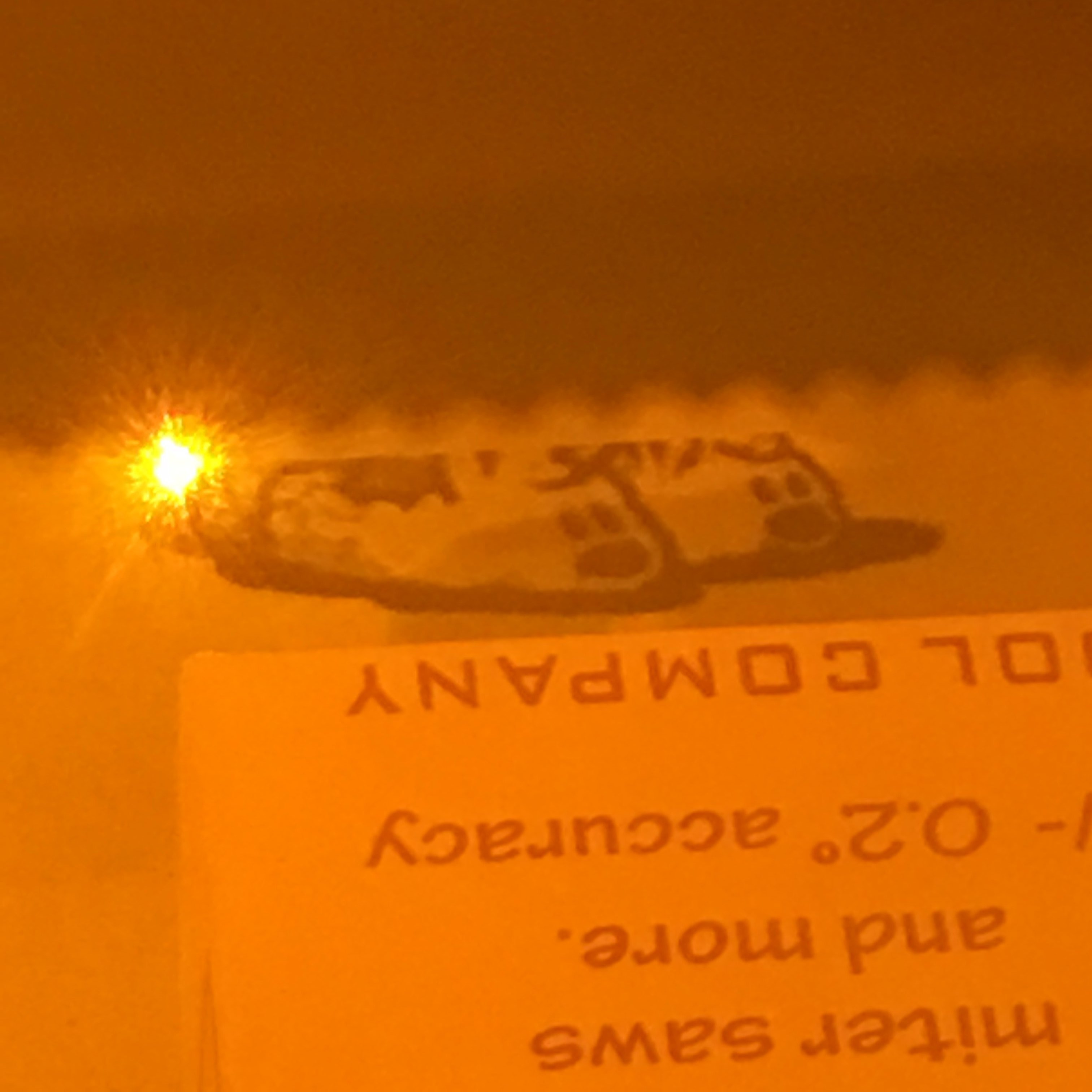

I can confirm it works. On the 2.0 firmware,with those 4 lines commented out in Marlin.cpp (edited with Notepad++, not with the Arduino IDE) I am getting the same crisp laser lines as I did with the older firmware.

BTW, has anyone submitted an issue to the Marlin GitHub? I don’t know my way around GitHub well enough to submit it (or to see if it has already been submitted), nor do I understand the problem quite well enough to explain it. I just know the workaround works!

OK. I posted a summary of our findings on that github issue. I wouldn’t expect a quick response. That included a comment that they would be overhauling the laser stuff “soon”, and that was November, so who knows. I was able to track down the commit that added that code, and it’s from November 2017!

Compiled, flashed, LCD alive, Garfield making some coffee…here’s hopin’!
No sense waiting to share this!!!

I should add what I did. I started from scratch, commented out the lines per above in Marlin.cpp, added only U8glib, Canada molies and flashed. The instruction to include the LCD library will need to be noted in the software pages.
