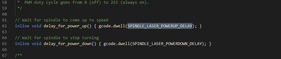

b-This would be the most proper thing to fix.
c-Not sure why this was added in the first place.

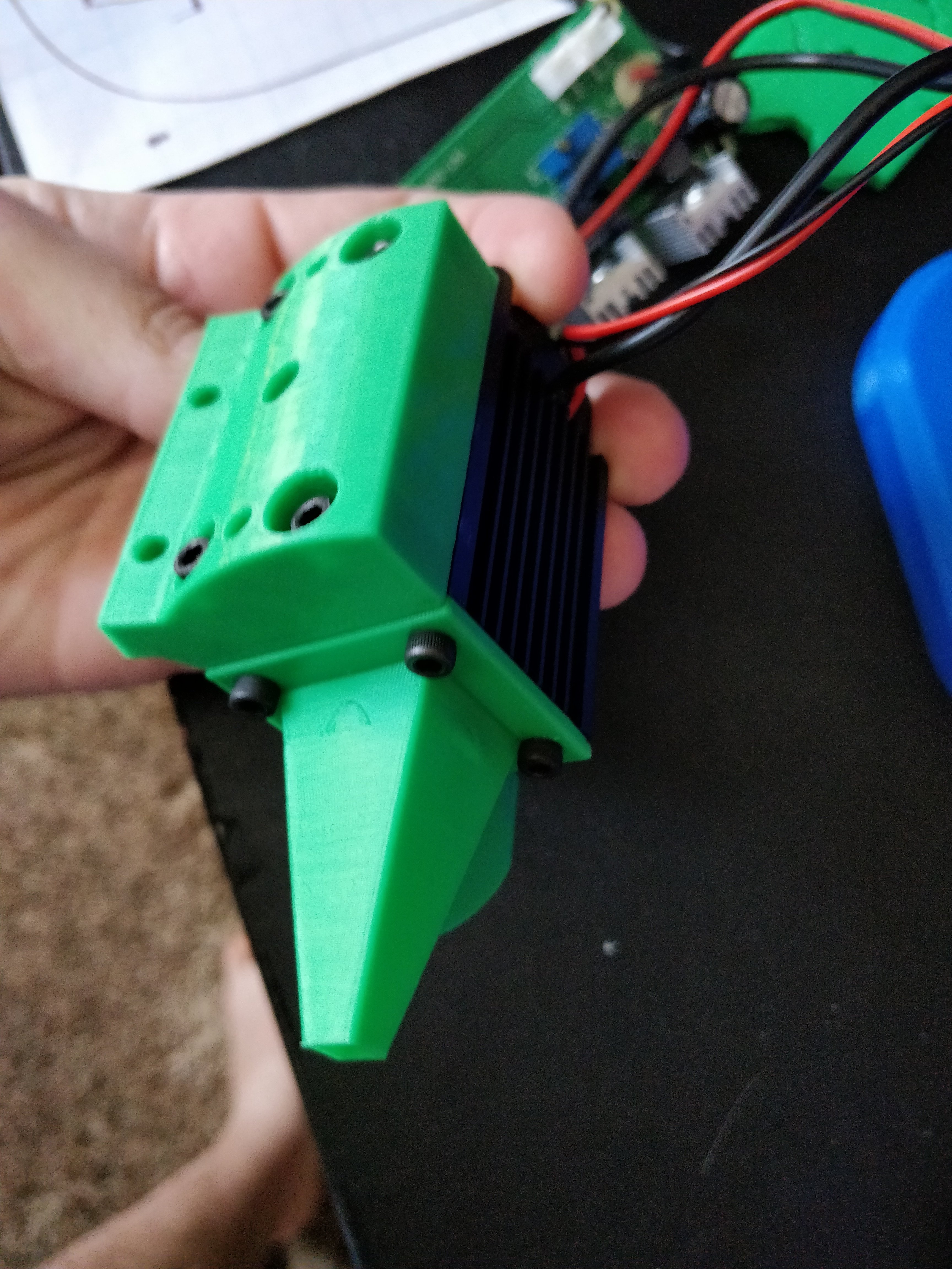

How do you have your RAMPS and laser connected? On my RAMPS, I have the D9 fan output (a +12v PWM signal) reamapped to pin 44 (now a +5v PWM signal) to feed the TTL modulation input to the laser. The M106/M107 gcode commands now control the laser’s power.
Pictures help.
– David

I lied. Woke up too early so I tried pulling out all the M3/5 related delays. That didn’t change anything. I really don’t understand the planner enough to know why it still stops each value change.
