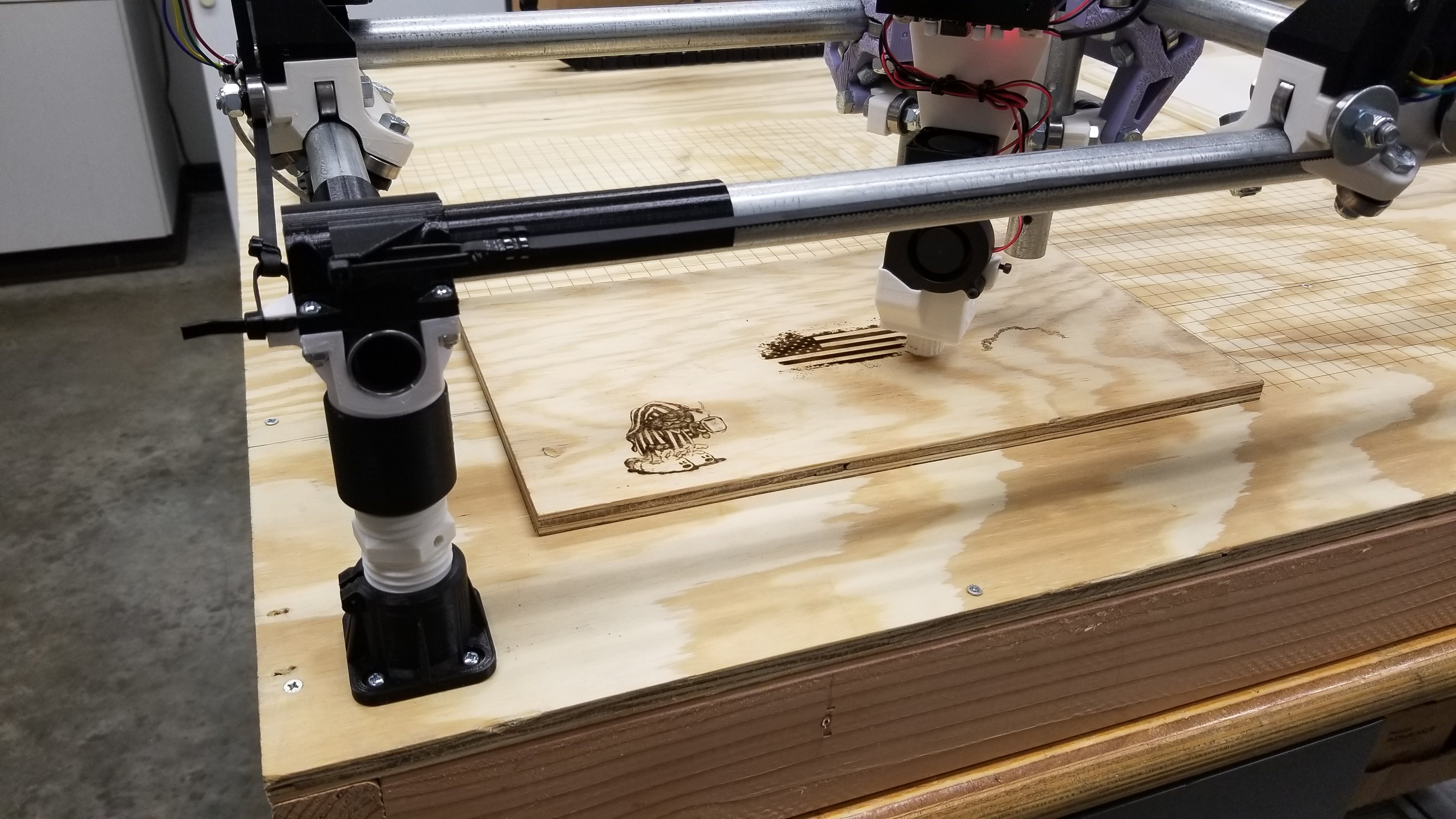

[attachment file=88432]
First run. Not too bad. I slowed it down to about 90% at the feet, then 80% around the head. This is on regular plywood, the grain probably has something to do with the unevenness of the burn. I think anyways. Thanks to everyone in this thread who has already put in so much time and effort.??

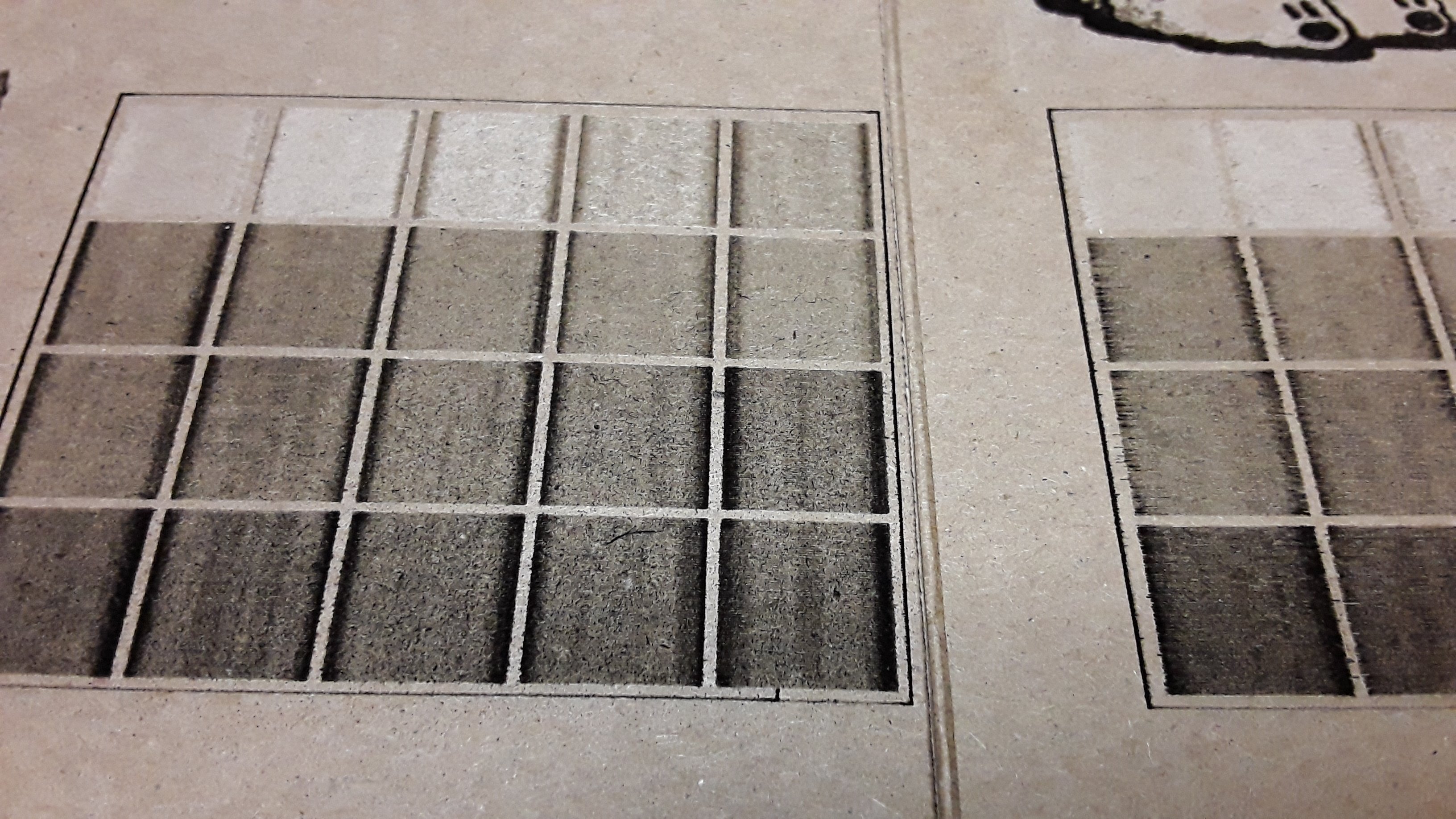

Okay… for once I decided I might as well be as up-to-date as everyone else. Edited the Bugfix-2.0.x version of the firmware by commenting out the infamous 4 lines in Marlin.cpp and reran my two gcode files.
Interestingly, I thought the motion seemed fractionally smoother than the old firmware that I had been running. It appears that wasn’t just a figment of my elder imagination. The “shades of gray” gcode is distinctly sharper along the block edges… new firmware on the left, old firmware on the right
[attachment file=88546]
[attachment file=88547]
I think I’ll keep it…

When you say the problem is the acceleration I don’t understand what you mean? Are you talking about the left and right darker images in the shades of grey laser burn? Those are not a firmware issue. Those are caused by the image to Gcode app. It is causing the MPCNC to work on one small square at a time so it is going back and forth in each square. That is why you see the acceleration burns darken in each square. If Image to Gcode worked like Image2Gcode and went the entire length of the X per each pass then most of those would go away. If it also implemented the “Overscan”, “Accel Buffer”, or whatever else we called that feature then all of those would dissapear completely. It is possible to accomplish the same result with changes to the firmware but that would involve more work like what you all discussed earlier. Now that I think about it that is probably what you meant. That it would be better to get that feature coded into the firmware so it wouldn’t matter what software wrote the Gcode it would just work. I fear that may cause problems with Vector images used for cutting out shapes. But I have had no experience with laser cutting before this so I don’t know if my fear is founded or not.
I think Ryan is referring to the problems with the M3/M5 commands. They insert a synchronization step in the buffer that means every time the laser changes power, the machine has to stop, which means accelerations.
Thank you, Aaryn, for the kind words. I’m confused by these statements, however…
Unless I’m misunderstanding what you are saying (which is quite possible), the MPCNC is clearly scanning the entire image from side to side… starting and stopping at each block boundary. The MPCNC is not handling the burn one small square at a time… but starting and stopping with each power change, as Jeff said, and, it appears, experiencing accelerations that darken the edges until it reaches full speed.
[attachment file=88588]
– David
Well look at that. You are absolutely right. I stand corrected. But in the Gcode file you uploaded it is using M106. So is it really just a problem with M3/M5 like Jeff said or is it also a problem with M106/M107. Because when I was running marlin 1.1.5 it wasn’t a problem with M106/7.
now I want to run the shades of grey with both firmware versions to test.
In my limited understanding of what the real problem is, it makes no sense that a fan, controlled by M106/M107, needs to undergo the same delays and/or accelerations as a spindle… yet it appears it does. It makes no discernible difference when controlling a fan but, when used to control a laser, it is discernible and makes a difference.
