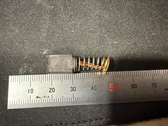

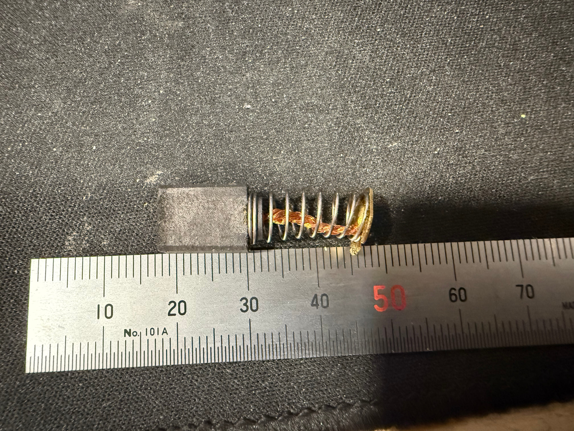

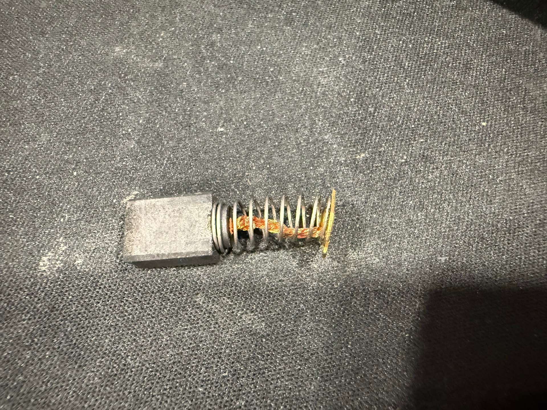

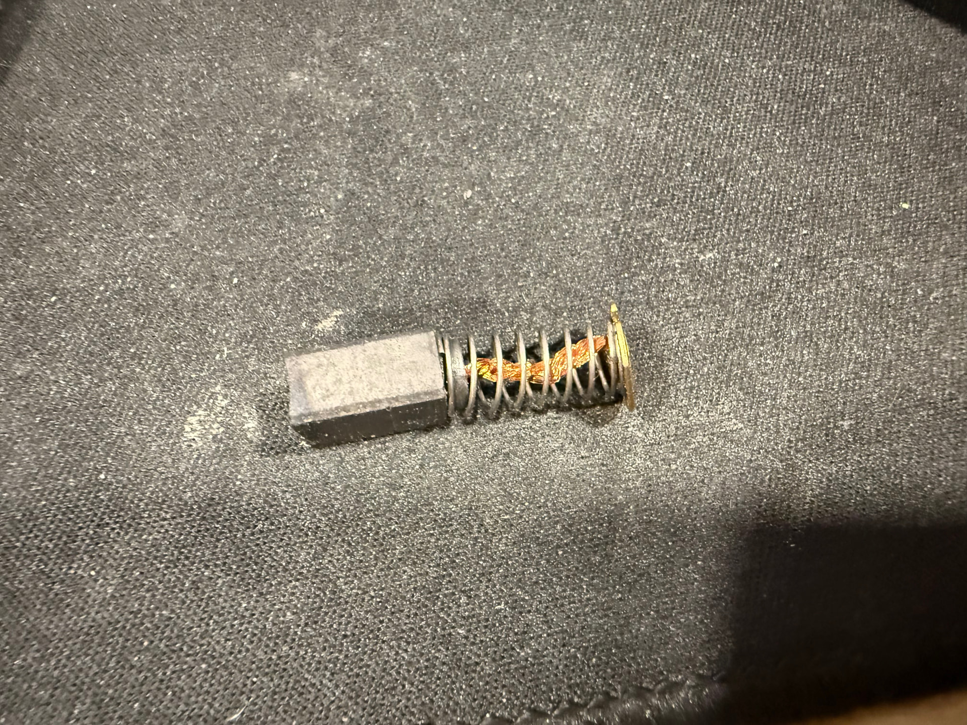

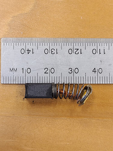

See if this helps at all…
This is out of the dead Kobalt I have. If you think they will help you I will send them to you!
Let me make a measurement. It actually looks mine may be more worn than I thought.
These have maybe 20 min of run time on them. I got it when we were doing the initial test before they released and this one the speed control was messed up right out of the box. Honestly don’t know why I have kept it around but if these brushes will get you out of a jam they are all yours.
If you do direct measurements on all sides l x w x h and post then anyone can get generic brushes in the future.
Really even close counts, I have done unreasonable things to brushes at the worksite before to get the job done - swapping them one tool for another, shaving a side down etc. As long as it makes proper contact it should work fine.

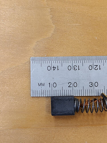

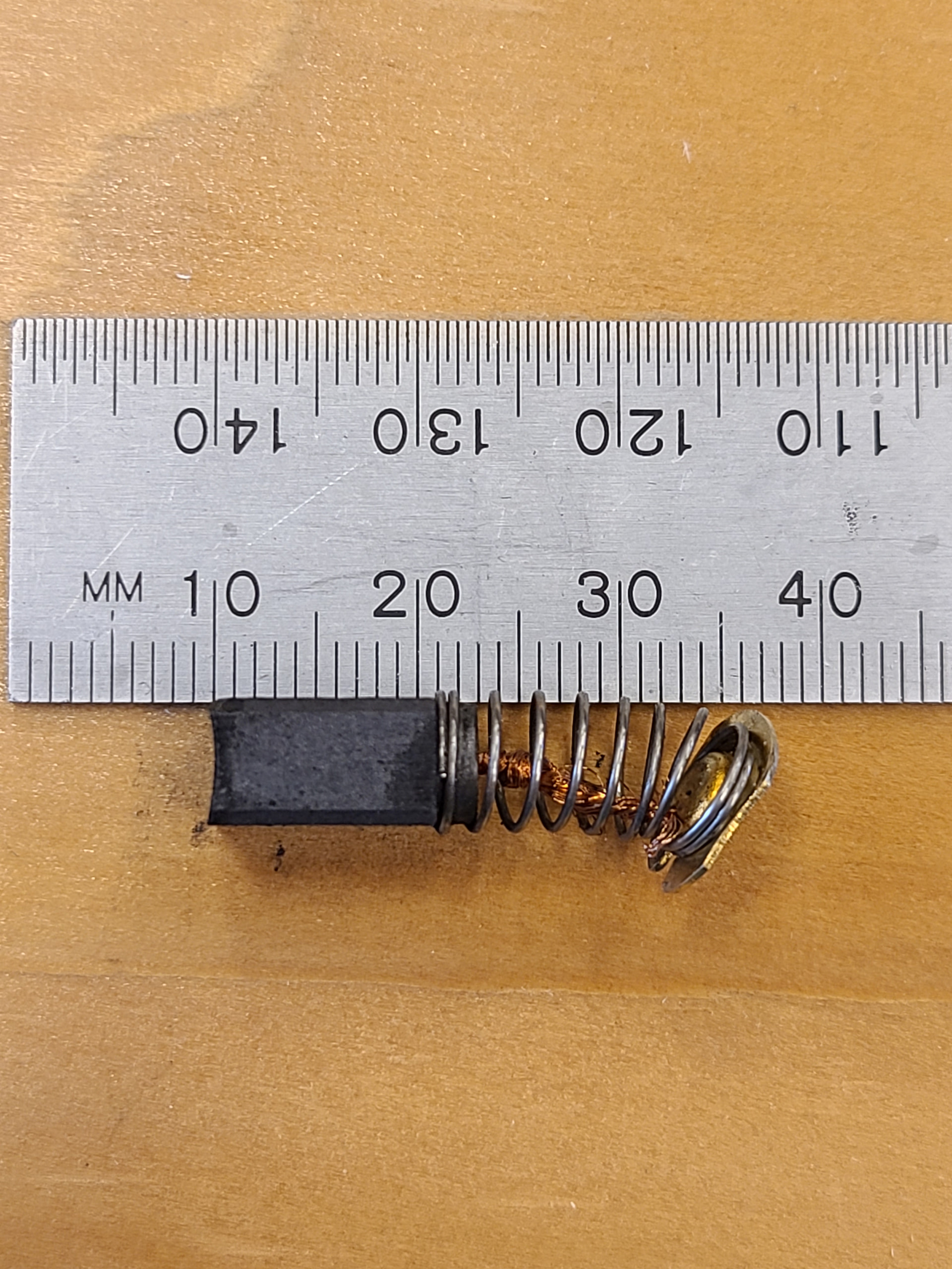

I have a spare Kobalt that I’ve only run for a couple minutes total that I could measure.
Well, my quick eyeballing then was misleading. It looks like mine are only 2-3mm shorter than yours are and this router has been run for at least 20-30 hours:
(And, for those following this, the width is 6mm, height is 9mm. New ones would likely be 6mm x 9mm x13mm-ish)
