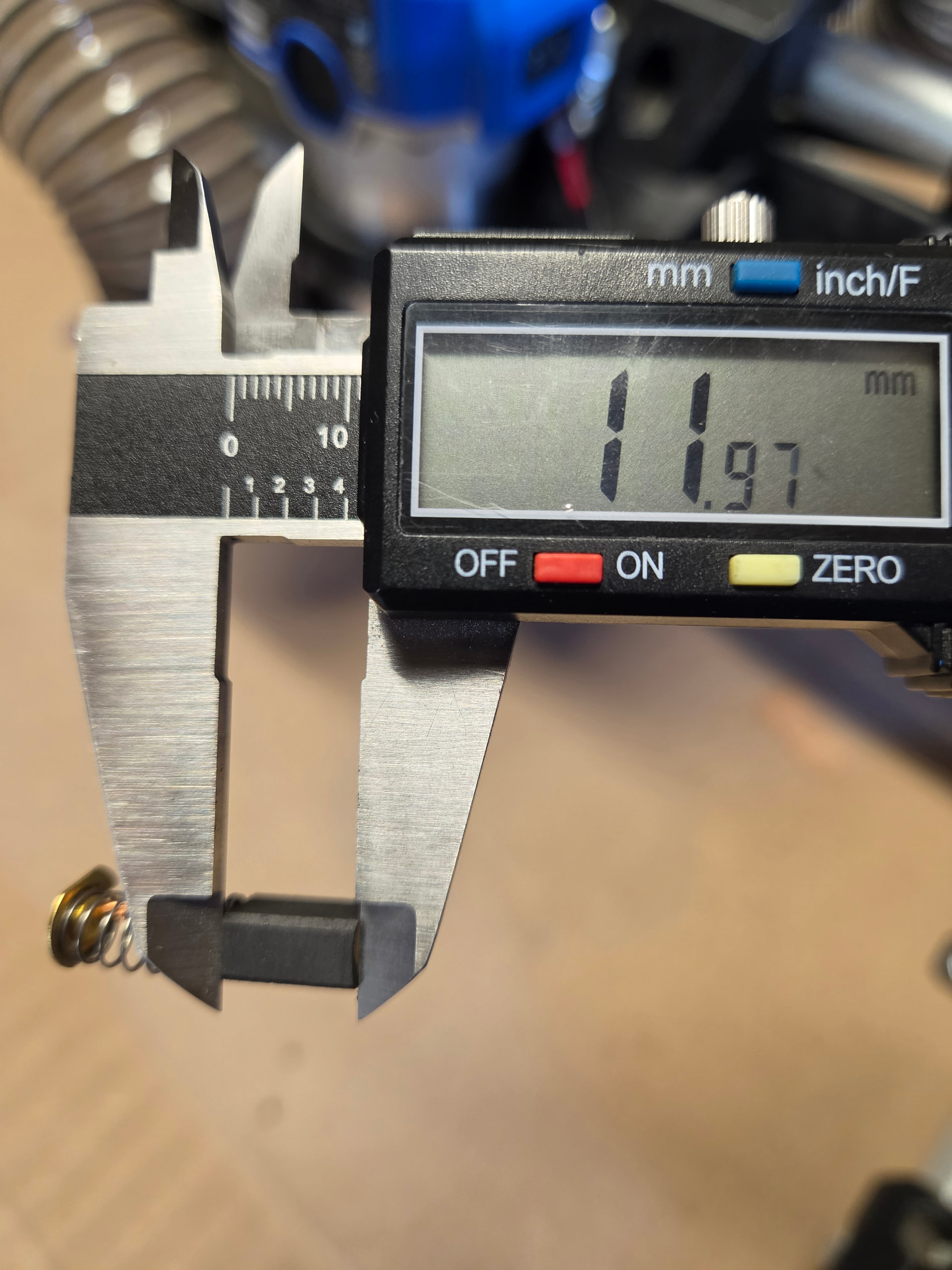

Kobalt trim router failure
Looks like 12mm.
They appear to be the same brushes as the Makita trim routers. CB408
5 sets of brushes are $10 on Amazon, we just need to figure out which ones fit.
Or 10 sets for $6 - and you get an extra mm! Which would probably fit or could shave just a bit off.

But so far, the Kobalt has run for several hours with no issues. I think the problem was the heavy dust accumulation that I hadn’t cleaned yet.
That first pic,maybe camera angle. Any way the wire braid looks wrong. The braid should not go through the side of the spring. It also appears some of the braid is broken. If this is true then the brush may bind and be intermitted.
Yes. I was surprised at how mangled the brushes appeared when I pulled them. I tried to straighten them a little bit, and for now the router is running, but I’m going to try some new ones and see how they do.
