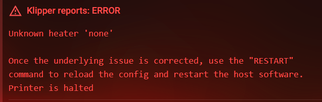

yeah, that is your printer.cfg, not mainsail. It is looking for thermistor, and heater
@orob did you install the mainsail macros when you did you install? If so those macros are probably looking for the extruder. you can get to that mainsail file with winSCP and then comment out the macros in there.
Thanks for the replies and interest.
every line with “extruder” in it is commented in mainsail.cfg. There are no references to it in printer.cfg and I will post the cfg file later this evening.
the printer.cfg file:

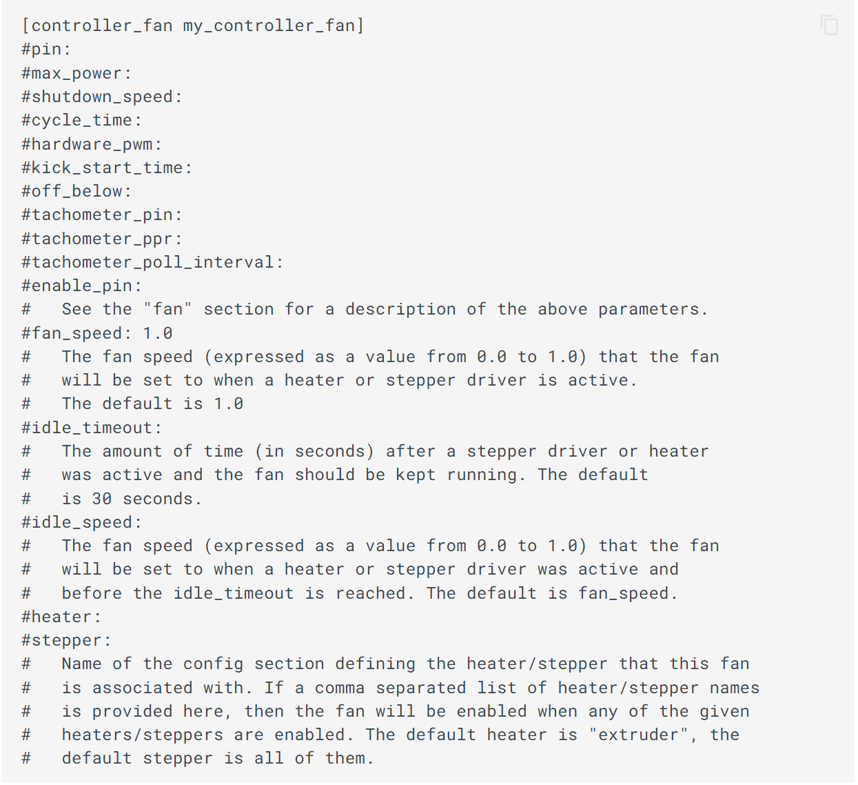

Yup there are some things that might not directly state extruder but invoke something that calls for extruder. Like I said, best to start with a clean printer.cfg and start building piece by piece. Start with just setting your serial for your mcu(s), then start adding X, Y, and Z axis/motors, and go from there!
ok. the offender was the definition of the controller_fan in the fan section. I want to have control of 3 fans:
  1. raspberry pi cooling
  2. driver cooling
  3. case cooling
I had intended the driver coolling to be the one defined as the controller, so if the cnc was moving, the fan would power on. Klipper thinks if there is a fan, it must be part of the extruder.

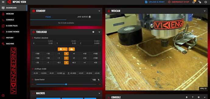

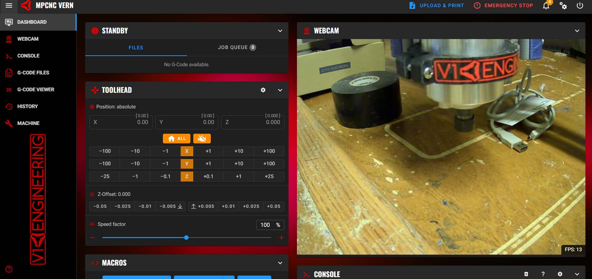

here it is in “operational” mode, though it isn’t quite operational.
I have fans that are based on the controller temps without issue, if you’d like I’ll run out and turn on my machine and check the cfg for that. (I think that’s what you’re saying you’re having issues with)
Having the fans declared as they were was the problem. There is a way to enable an aux fan.

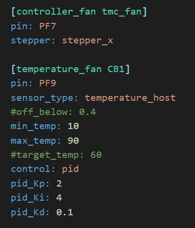

This might help you for 2 of them…
I have these set up on my V5 and they work well. The controller_fan kicks on any time the stepper is active. and the temperature_fan ramps up and down depending on the temp of the cb1/pi
the term “controller_fan” triggers the extruder error.
So, I now have this that works to at least allow the controller to communicate:

Full physical functionality has not yet been tested. The second and third fans are not yet connected, but this is progress and I appreciate the help!
edit:

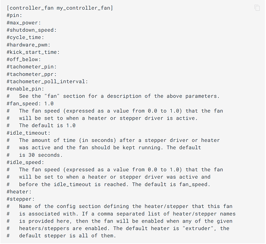

changing the first fan from “controller_fan” to “fan_generic” as per klipper docs passes the boot check as well.
Yeah I see it now… It defaults to extruder I wonder if you can put something like heater: none in there? I doubt that will work but there should be some kind of way around it lol.
good thought. no dice:
I think with the generic heater, I can multipin the enable on the tmc and use that to trigger the fan, so if the steppers are on, the fan is on.

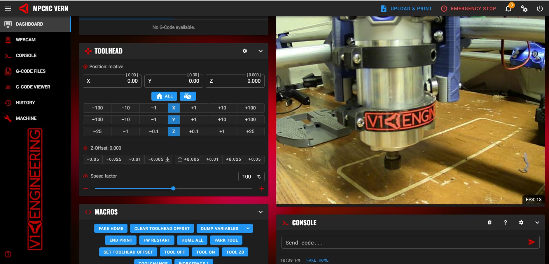

I tried it like 10 times with different macro names and indenting… lots of things and kept getting “invalid code section”
[gocde_macro SET_HOME_XYZ]
gcode:
   SET_KINEMATIC_POSITION [X=0] [Y=0] [Z=0]
After remembering how to spell, this works:
[gcode_macro  FAKE_HOME]
gcode:
  SET_KINEMATIC_POSITION X=0 Y=0 Z=0
I’ll blame this on my reading glasses. c’s look like o’s from a distance sometimes…
this is what klipper control of the primo looks like from my laptop. Had to reverse the left motor for the Y movement and the z motor connections need to be verified, but x worked out of the box.
