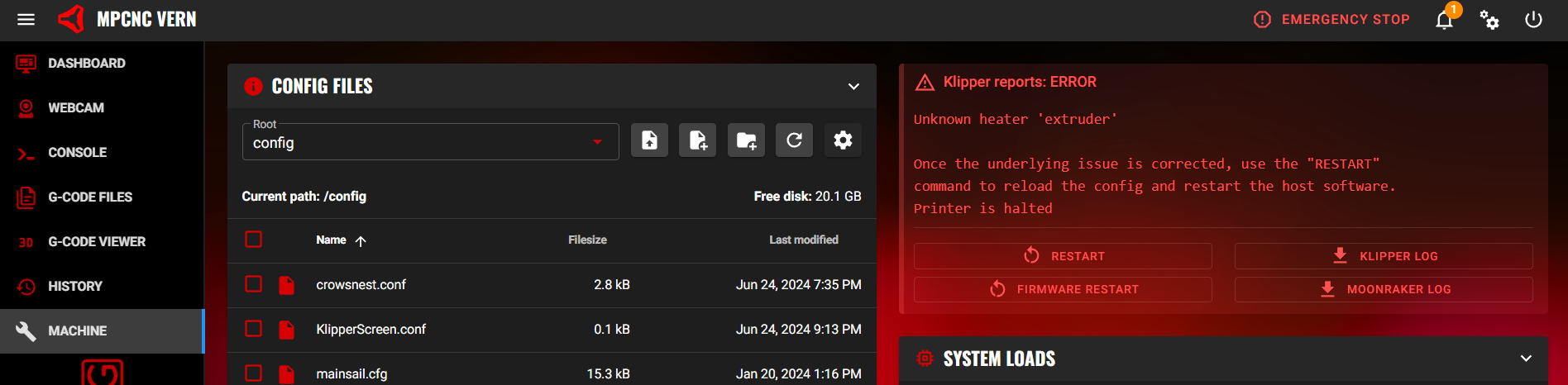

Without modifying mainsail.cfg, I get this error:
Searching for “extruder” in printer.cfg, it does not exist… but it does in mainsail.cfg
can you share your printer.cfg? It’s usually best to start with a naked cfg cause there are some things that if left behind still make calls for an “extruder” in the backend and that’s probably what you’re running into. You could modify mainsail.cfg, but that’s just skirting around an improperly setup printer.cfg (I just went through this 2 days ago testing a motion system of a new printer build without any heaters hooked up)
