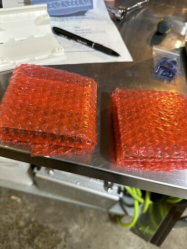

Remember I had to brush it on so it is not super invisible.
It’s some thick red stuff. Looks a lot like bubble wrap?? I assume I just cut away the coating where the terminals are so I can connect the wiring?
You can barely tell to be honest. Maybe he’s tricking us and didn’t coat them at all just so he could see if it was actually required or not afterall? Hahaha
I can say this much - if he brushed it on he must have used a super soft brush and has a very steady hand! I’ll try to catch the visiting in the lights.
That actually makes it look worse. You can hardly tell. I swear.
I can see it. It looks pretty good and will help in your cold operations.
One thing to keep an eye on is the pins/headers for the TMC2209s. If you ever start getting intermittent operation on an axis, pulling the associated stepper, checking the contacts for corrosion, and then reinstalling the stepper driver should be a first step.
