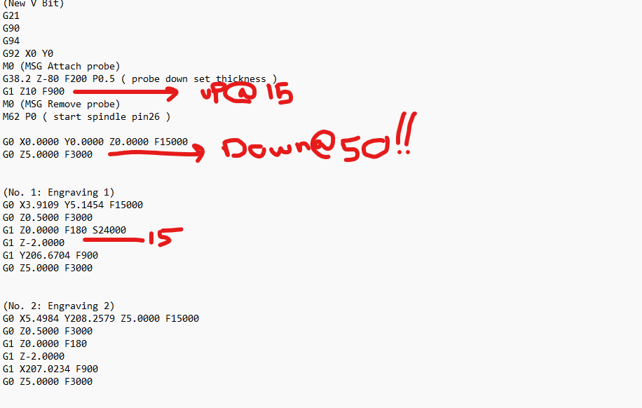

Z speeds, , z rapids, z accel, and z holding power all come into play here. When you can share some of your gcode, and your config.
Will do. Dinner was ready and I didn’t want the machine to sit idle so I queued up the revised CAM file and got it running. So far so good. Once it’s done I’ll pause production and look into the config. Here is the offending (but not always) gcode file attached - too long to embed.

your Z rapids are insane for a two headed beast in a freezer. I would say Z rapids to 15 max (set to 900 in estlcam)
Your movements in Z are set to 15, set that to 8 (480) and see what happens.
Your Z rapid is capped at 1200, you have it set to 3000. This could be the issue right here. Never really tested how the firmware handles such a discrepancy.
Your accel is set to 80, that should be okay but you can be super safe and set it to 40 instead.
That looks insane. But the Z rapids issue doesn’t explain why one of the IDEX cores was moving at a different rate than the other. I hate the name IDEX, by the way. It’s independant dual cutters not extruders. IDEC?
I am hoping it is just a glitch from the firmware trying to limit the Z so much? Like some sort of overflow?? You know I have no real idea what could cause that but I am taking a stab in the dark.
I know in the past all sorts of random stuff would happen in Marlin if you exceeded the firmware limits. That did get fixed at some point but I have no idea how easy something like that is in firmware. I kinda assume it is as simple as, “if this value is greater than “max value” it gets max value”

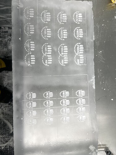

I’ll get a. photo tomorrow but when I was cleaning up the freezer to switch from “ice cube mode” to “ice carving mode” I took a look at one of the aborted slabs. It was actually one I let run because I thought I could still use the cubes engraved on one router even if the other was no good. The crazy thing is that the whole run looks like the right router was shrunk on the X axis by 50% whereas the left router was as normal as could be (just out of alignment with the grid). I’ll be sure to get a pic - it’ll REALLY get your head scratching going. I’m pretty certain it was the same glitch, I just didn’t catch it at the time and couldn’t see what was really happening on the turns-out-it’s-pretty-crappy IP camera.

Here it is. Isn’t this fascinating?!
Of course the beauty of it is you let them melt, refreeze and there’s no waste :grin:
I’m convinced that the TMC driver that runs your 2nd core did not initialize correctly for whatever reason, so it was running at the wrong step rate.
