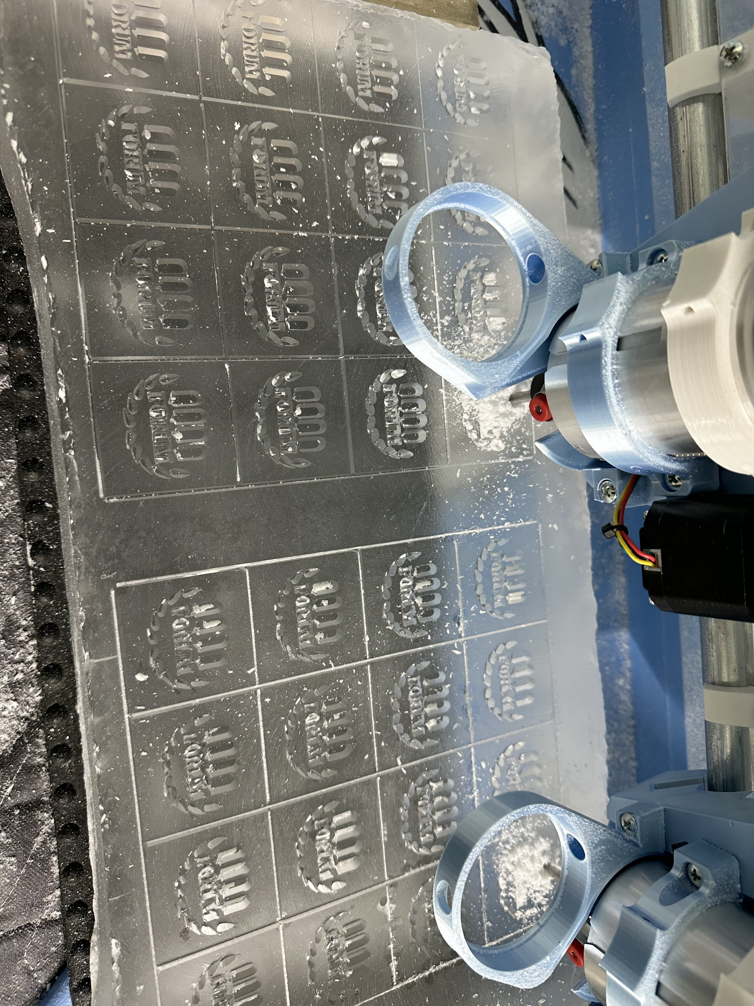

Success! Mostly anyway. There was an uneven lift after the homing but hoping it was just an anomaly. I’ll know soon. I have about 600 cubes to make next week if they like what I show them.
https://youtu.be/5-wDISXLQQw?si=67FIvuK3CR1C6zZB

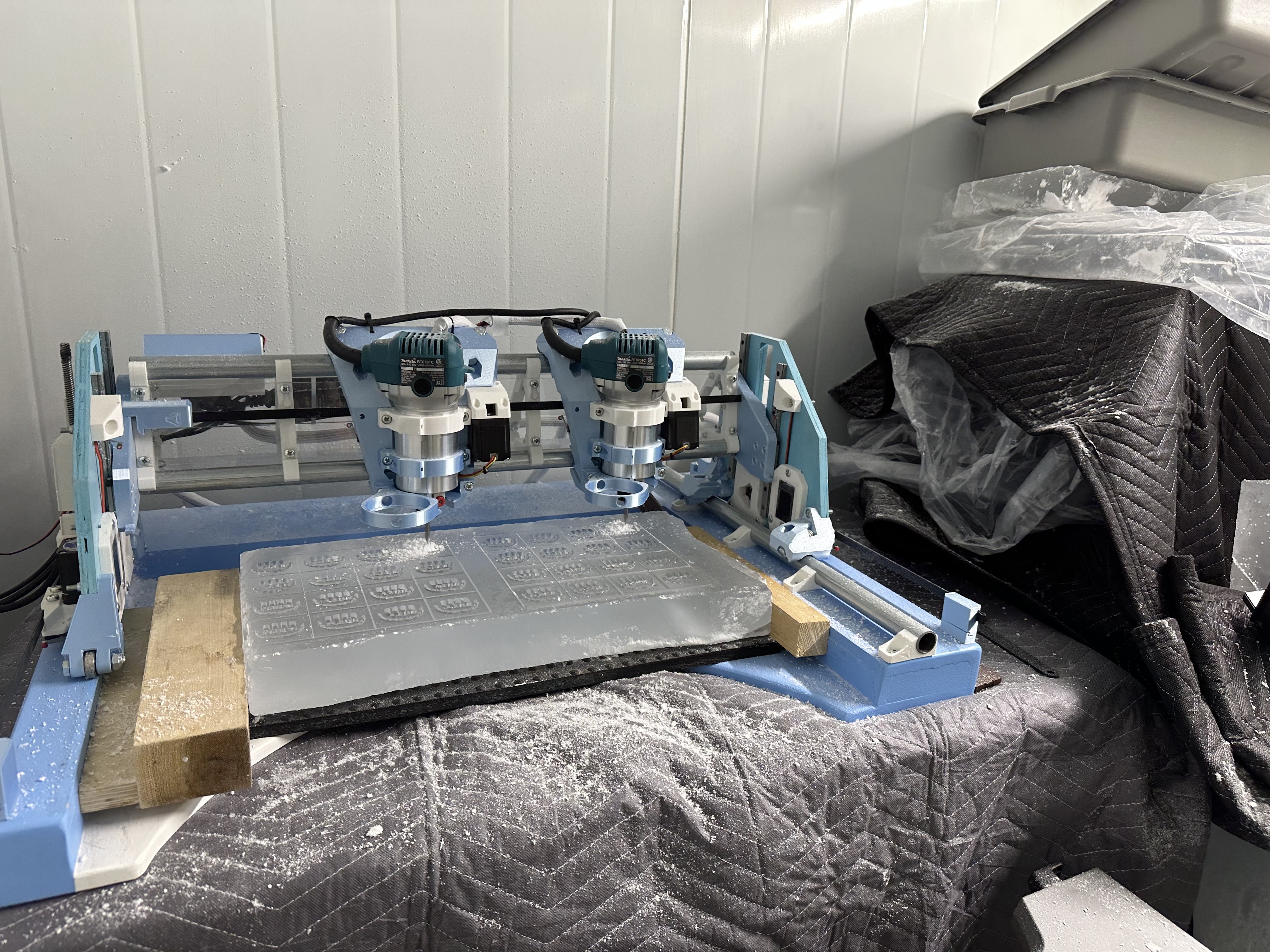

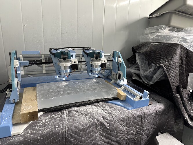

Okay, it’s for real this time. I’ve got the Bumble running the first of 18 slabs for a finished total of 400 custom engraved ice cubes. Estlcam said 58 minutes per run so hope we don’t have any hiccups along the way. The job ships Saturday and of course I’ve got bad time slugs stuck in my day tonight, tomorrow and Friday so it’ll get a break here and there.
Before I started I took the gamble and farted around with the ESP so I could get it off AP mode and onto the Wifi network in Client/Fallback mode. Just about did wrong things but thankfully V1 had all the answers I needed before I made too many mistakes.
I’ve also just ordered a new IP camera (old one won’t connect to our new network). I’ll install it in the freezer so I can monitor from the warm side of the thick walls.

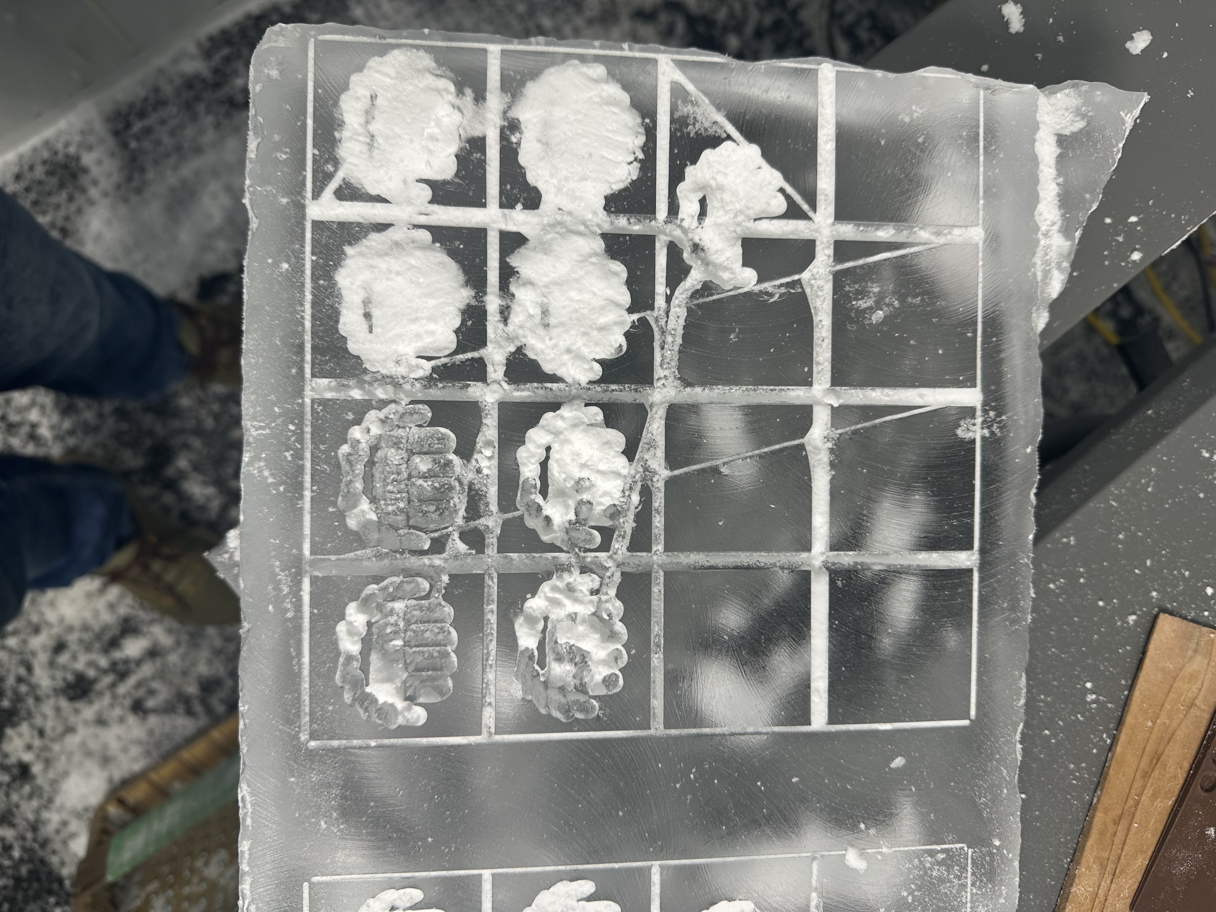

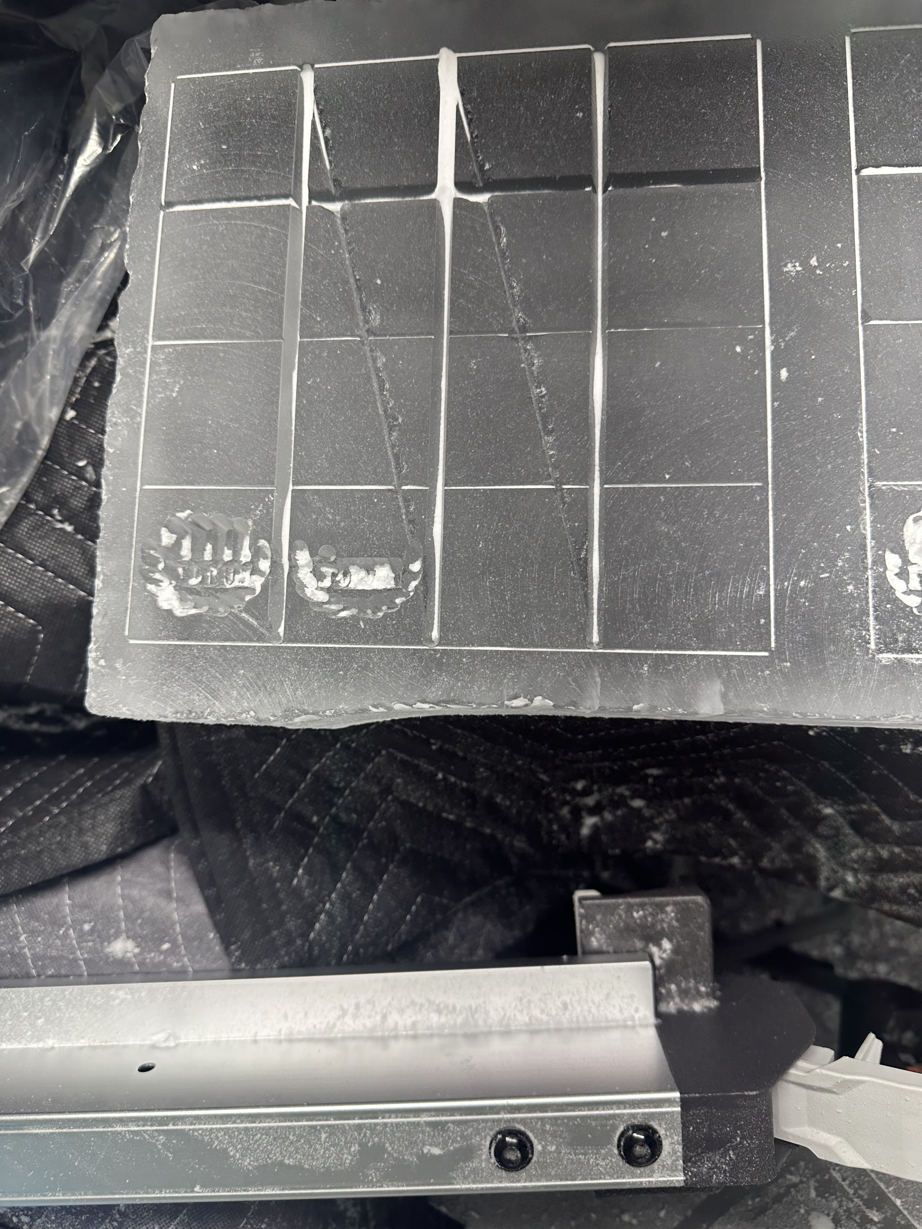

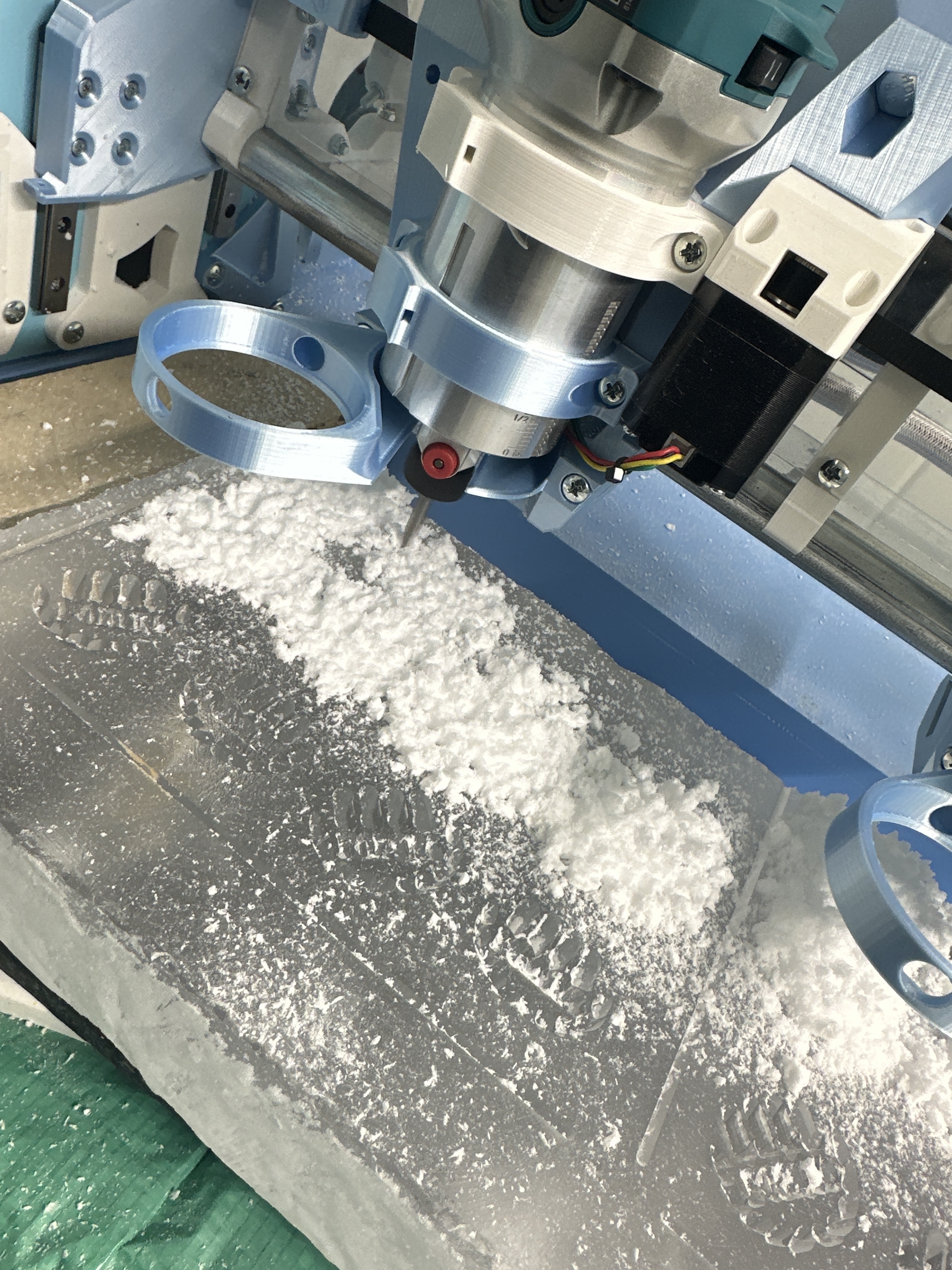

I’ve seen a recurring failure here last night and today but not on every run. If you look at the wide shot (photo) in the post above you’ll see the grid drawn out and then all the logos inside. The grid is just a guide for me when I get the slabs to the saw to cut each cube. These guides cut first and only 2mm deep. They are composed of four straight lines around the perimeter, short lines marking the horizontal separations and then full lines marking the inner vertical cuts. This is also the order they are cut in.
I have a repeated/sporadic Z lift failure on the left hand motor at the end of the middle horiz separators as it lifts to go back to the far left and start cutting the last row of separators. It’s always at the same point. Why would this be? At this point the weight of the routers is pretty much all the way to the right side so the left motor should have the easy job.
Can someone tell me where in FluidNC I can give a little more oomph to both Z motors? Maybe that can overcome whatever is happening here. I’ll grab my phone and take some pics of a couple of the failed slabs.
In the meantime I’m going to reCAM and see if I can just run a crosshatch straight over each other instead of hopping on the horizontals where the lines cross the vertical.
