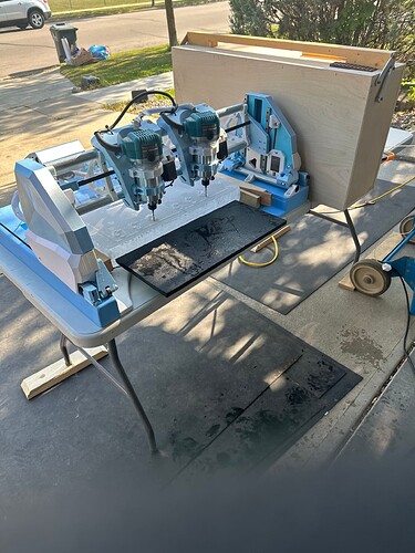

What if you just made a insulated bed, and insulated the 4 exposed sides. Just leaving the top exposed. I assume it would stay pretty good if you kept the snow out of the cuts?
Well now we’re literally thinking “out of the box”, thanks for the rethink.

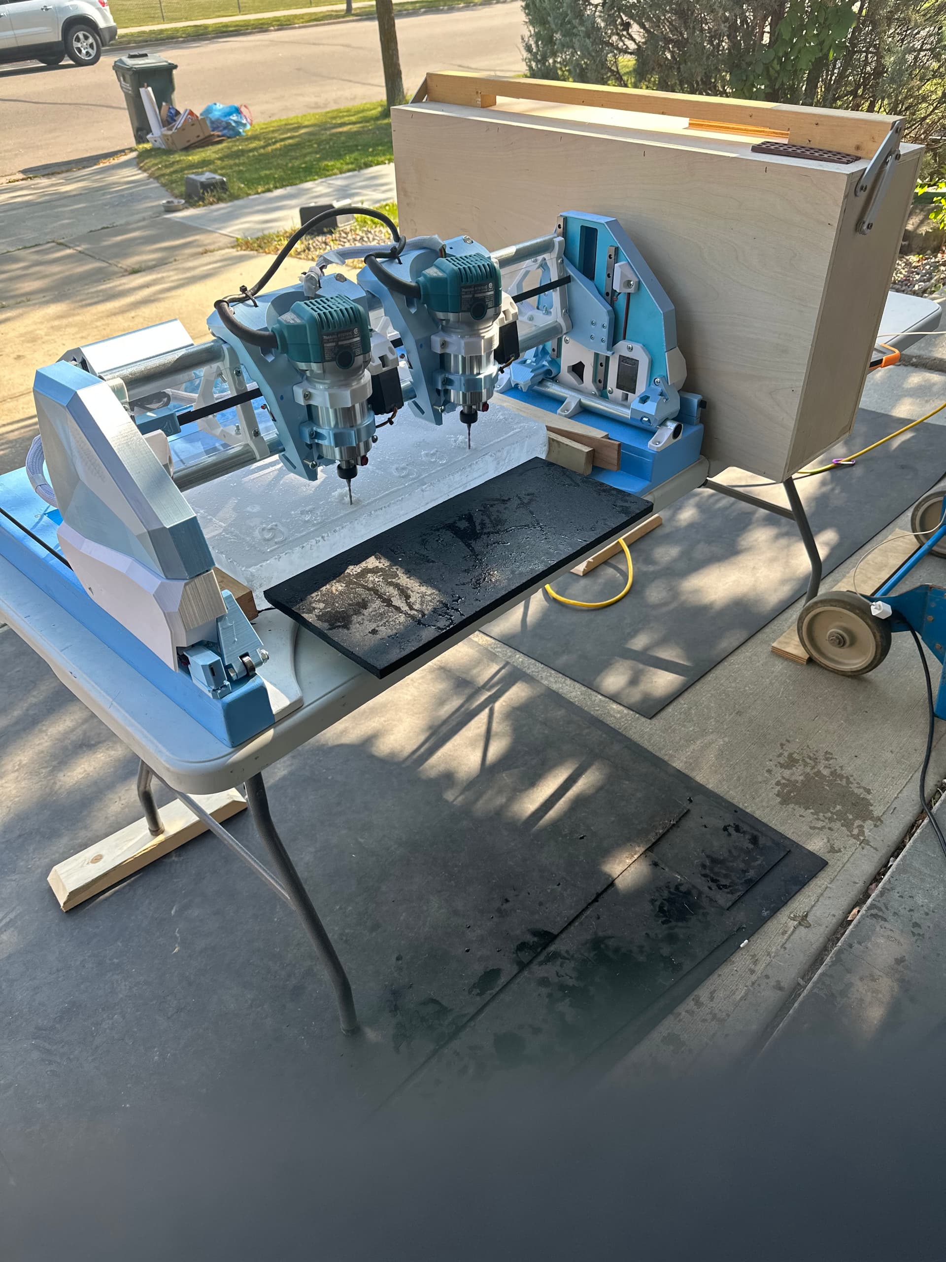

The routers blow some pretty warm air and it blows right onto the ice (in the freezer this warm air has zero impact as it cannot compete with how cold it is in there). If I could redirect the flow of the airflow and minimize or eliminate any drips caused by snow blowing onto the router bodies and melting I could actually run it even on a hot summer day outside as typically the runs “should” be fast and the slabs are so cold when they come out of the freezer they are fine for 10-15 minutes of runtime.
So there - no box required at all and no concerns about the temps on the wiring/electronics.
I’d been planning on removing the dust collection hoops (dust collection doesn’t work on the snow as it tuns out)…I wonder if I could design and print some sort of cover that uses those bottom two screw holes and just cups the bottom of the router, letting the bit poke through. Give it like a martini glass top flare and that should redirect the airflow well enough. With short, low rpm runs I’m not worried about burning up the routers. But I’m sure they’s still be just fine.
