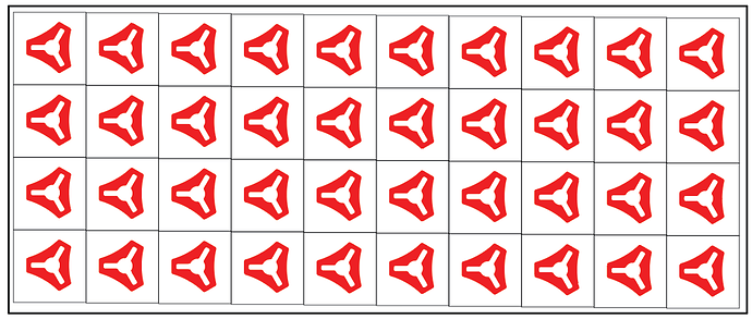

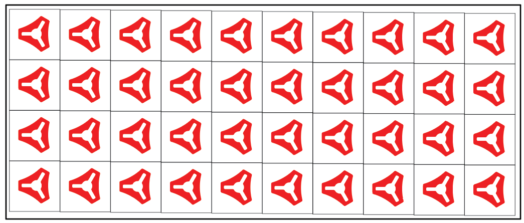

Okay, so to come back around to the dual core machine. When I was cutting those V1 cubes free of the slab it became immediately apparent that my out-of-square issue needs to be resolved. Basically what I got was as shown here. See how wonky it gets off square? One might think “I could just cut the strips free the short way - that’s still a straight cut” but the point is actually to minimize the farting around. Best is to be able to set the fence on the saw at 2" and just cut no matter which way I cut - short or long.

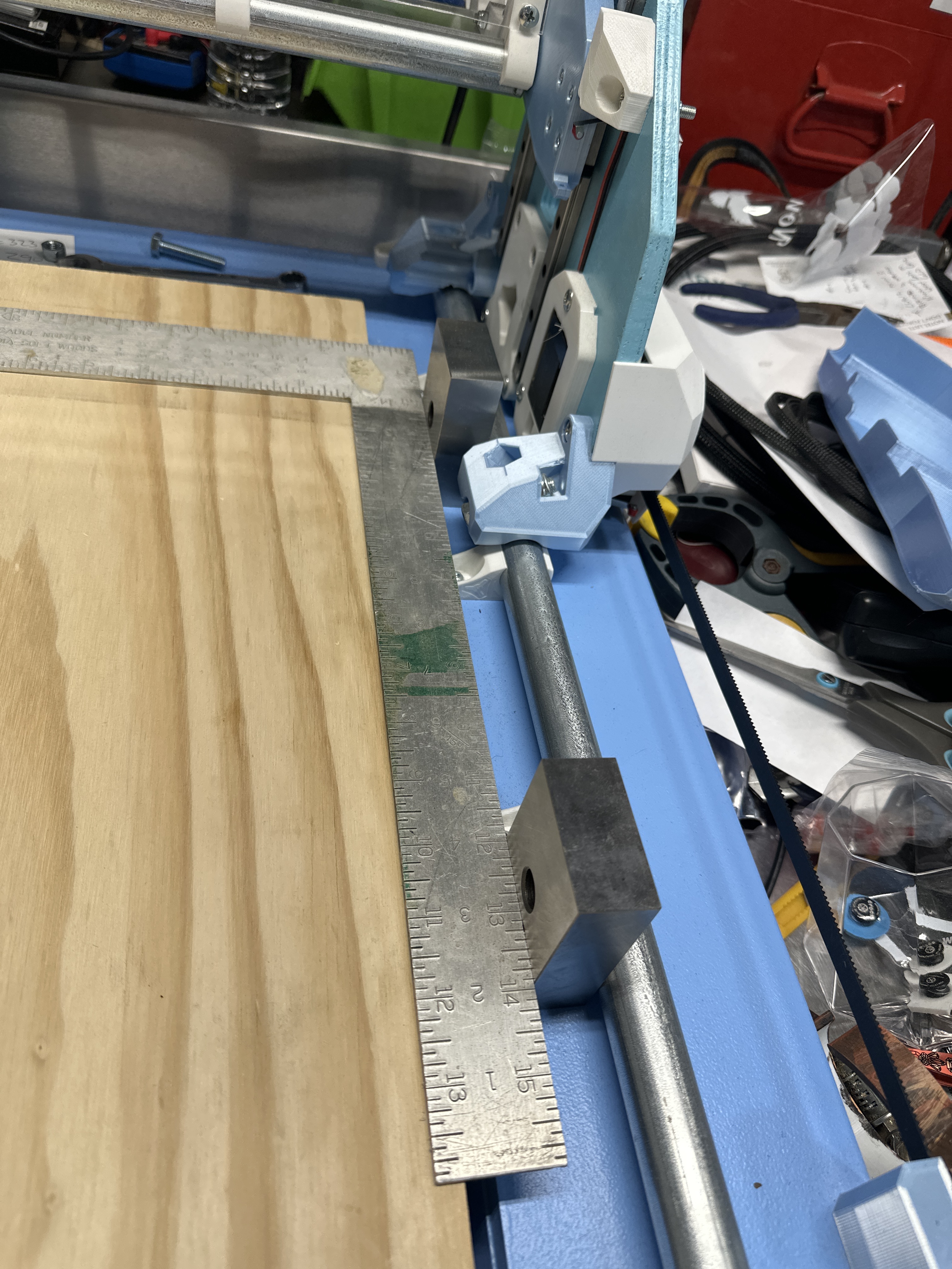

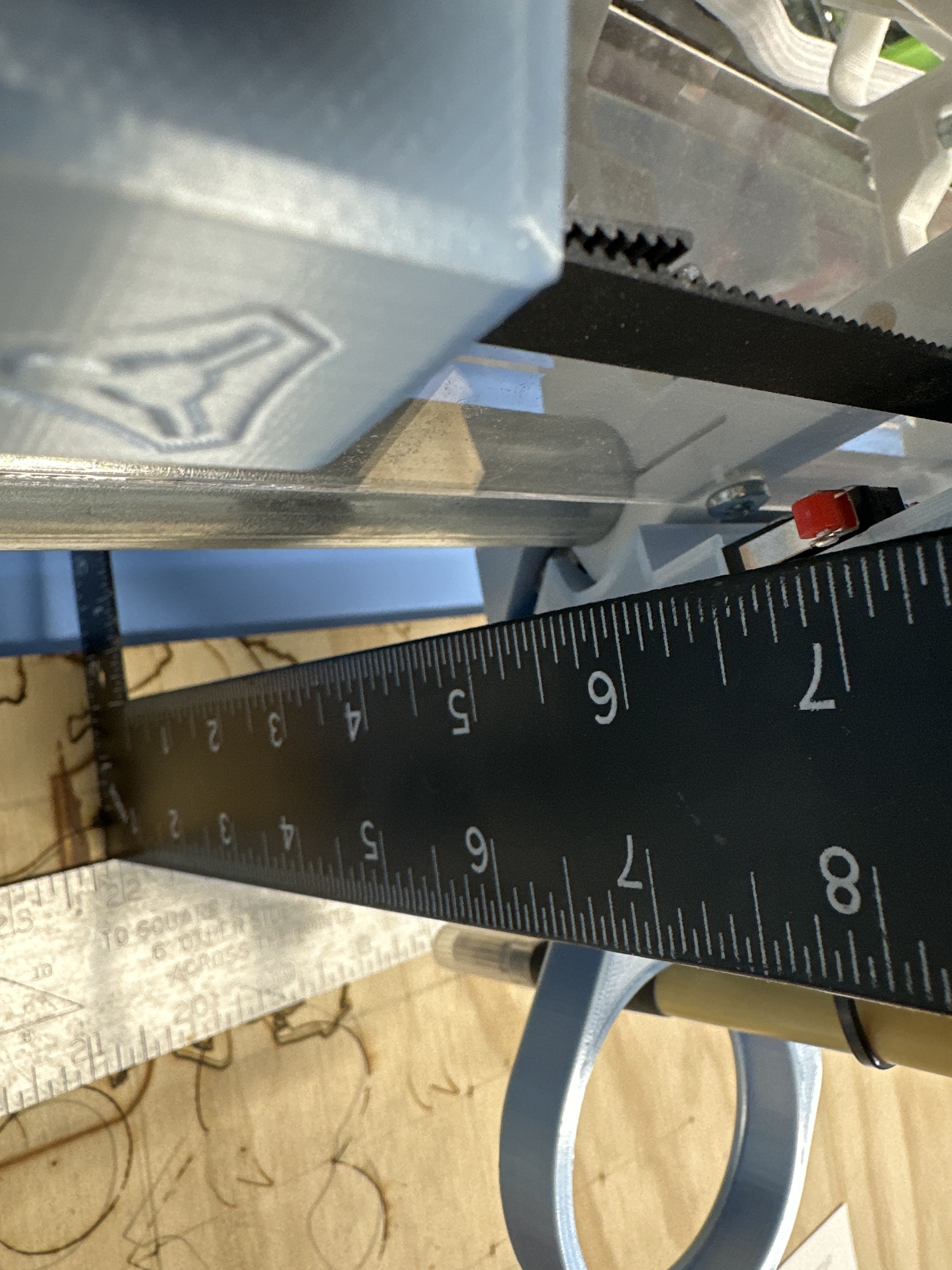

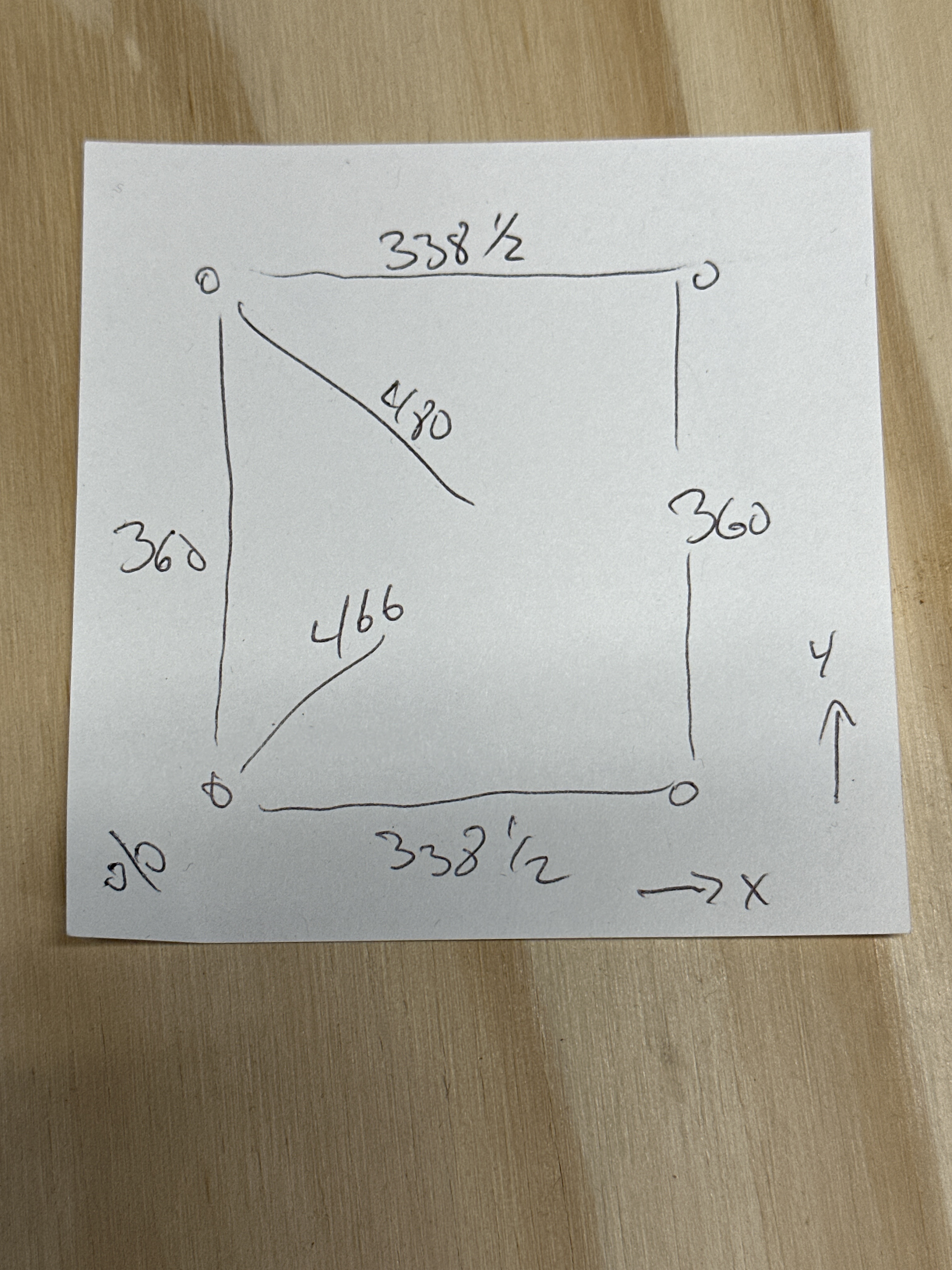

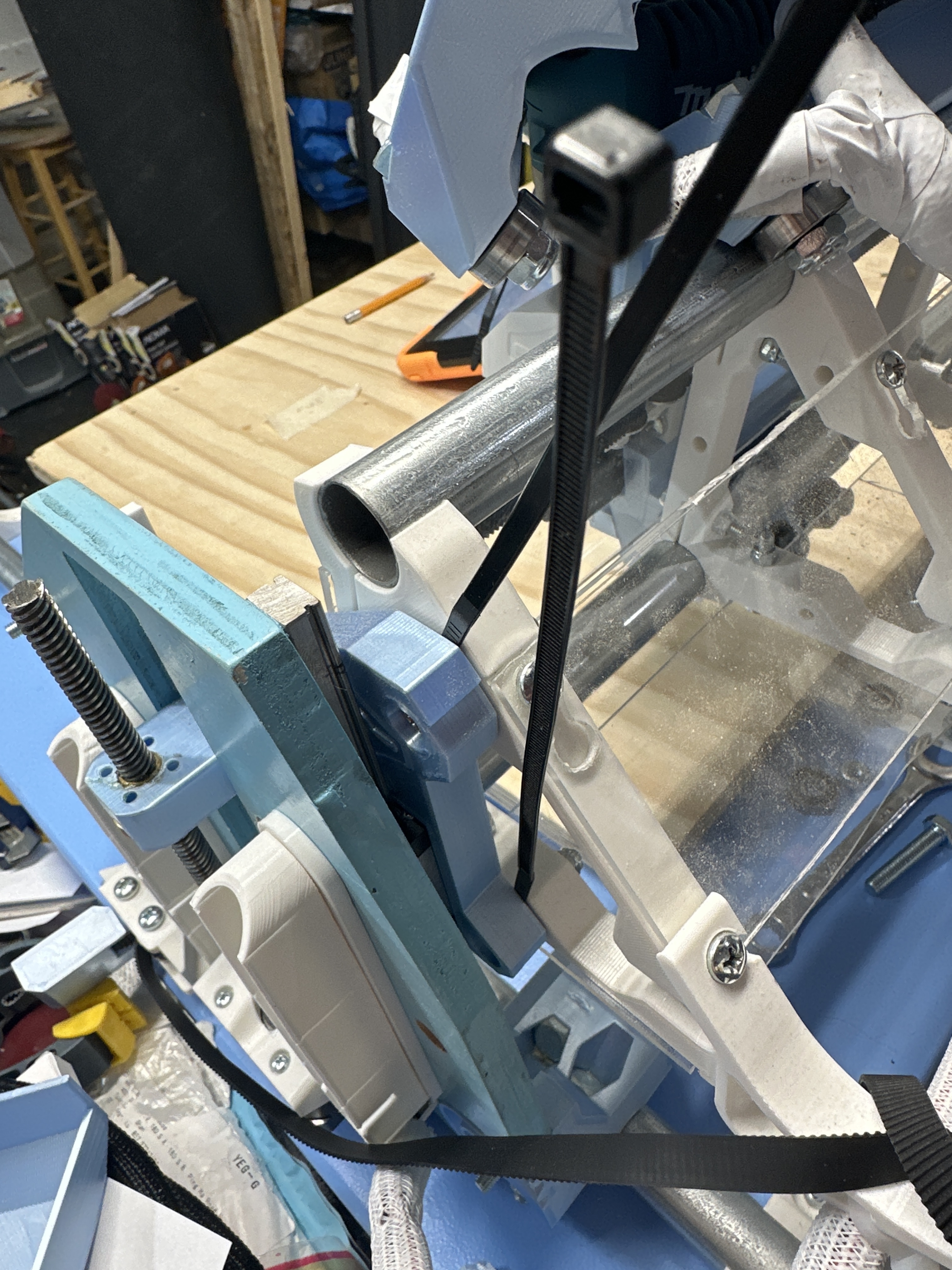

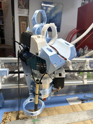

Okay gang. I thought I might have had this figured and the only issue was that my rail was not perpendicular to my intended work area but after realigning the rail to the table the machine was still out by a lot. I pulled the second core (I’ll spare you any jokes about an accidental discovery of a seventh axis - see pics) so I could get a better visual and get some measurements.

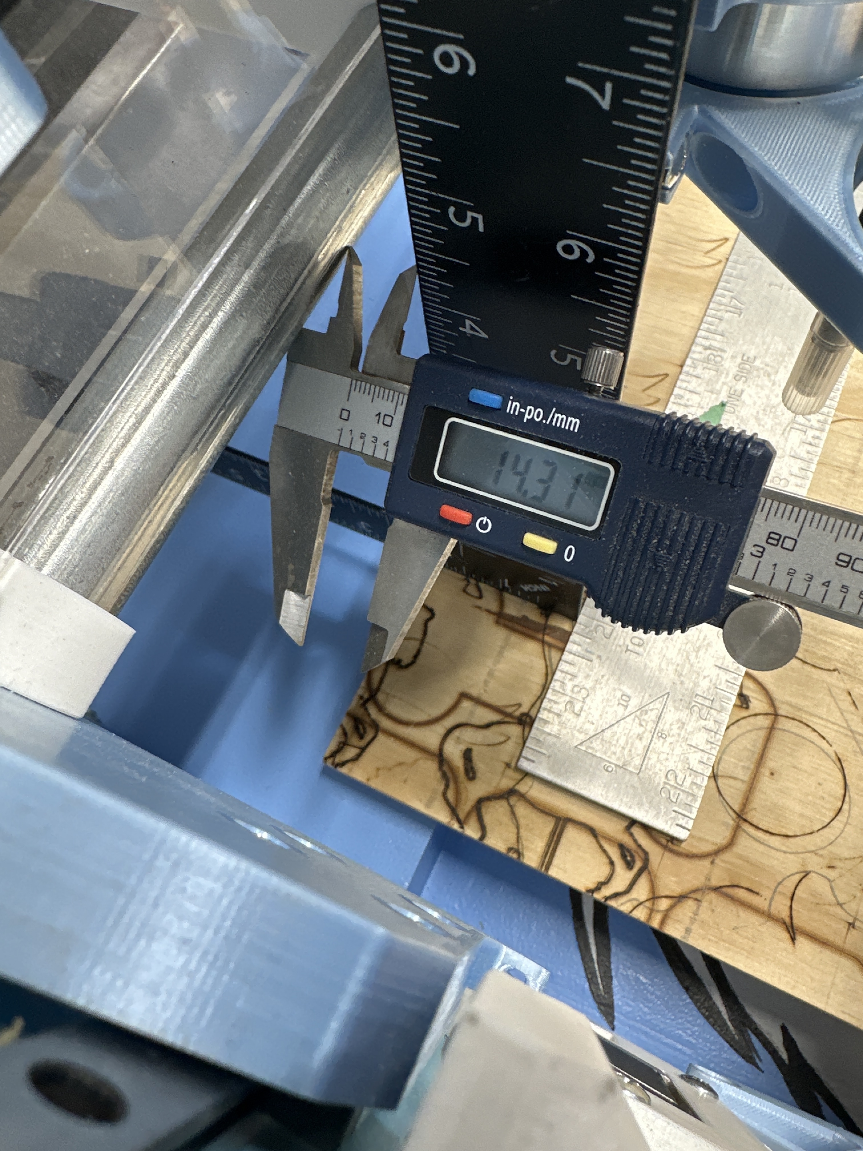

The photo with the calliper shows the non rail side, so X=0. On the rail side with the squares set up as shown in the picture the black square is exactly touching the lower beam tube. On the X=0 side I’m further in the positive Y direction by about 14mm. I used my 123 blocks against the rail to give me a good reference there and was as accurate as I could be with the black square.
Where might I start troubleshooting this or how might I bring it into square? Could a guy just get away with adding a couple washers to the front rail side roller to adjust the angle or the far side of the machine to get it ‘close’? I don’t imagine it’d take more than a washer or two. Or if I’m gonna do it, is this one of those times I should ‘do it right’?

That means your x=0 side Y belt block is out 14mm. You do not want to move it that much with the software, you need to fix the Y stop physically.
Double check to see that your Y endstop screws are as close to the block as they can get without the LR hitting the Y stop block (~3-4mm to spare).
I’ll give it a go and report back. It never occurred to me that I may have been looking at a Lowrider that was being pulled out of square simply due to maladjusted endstops. I was worried my build was AFU.
Okay. So that wasn’t it.
I ended up moving that 0,0 belt block -14mm on the table but the reality is that then the machine just racked itself right off the rail trying to go that extra 14mm on the other side. See, the blocks were right where they needed to be to “naturally” trip both limit switches simultaneously. Moving it 14mm, while it ‘should’ have corrected the non square, was actually forcing the machine to try to bend itself out of shape.
I pulled both belts and did some manual rolls and measurements, adjusting the rail as I went but ultimately determined it was/is the gantry, not the table or the rail.
I loosened back the three screws attaching the right side beam brace and poked the tip of a zip tie into the gap and retightened. At first I shoved down to the thick part of the zip tie but that swing the beam too far the other way so I backed the zip ties out slowly and checked as I went. As of now literally just the tip - the thinnest part of the zip tie is in there acting as a spacer and it was crazy close. I replotted the squareness marks test and my diagonals are now within 3mm.
A bit ghetto but it appears to have worked. I’ll be playing with some ice in the next few days so will try the V1 ice cubes again and see if they are all in line this time.
