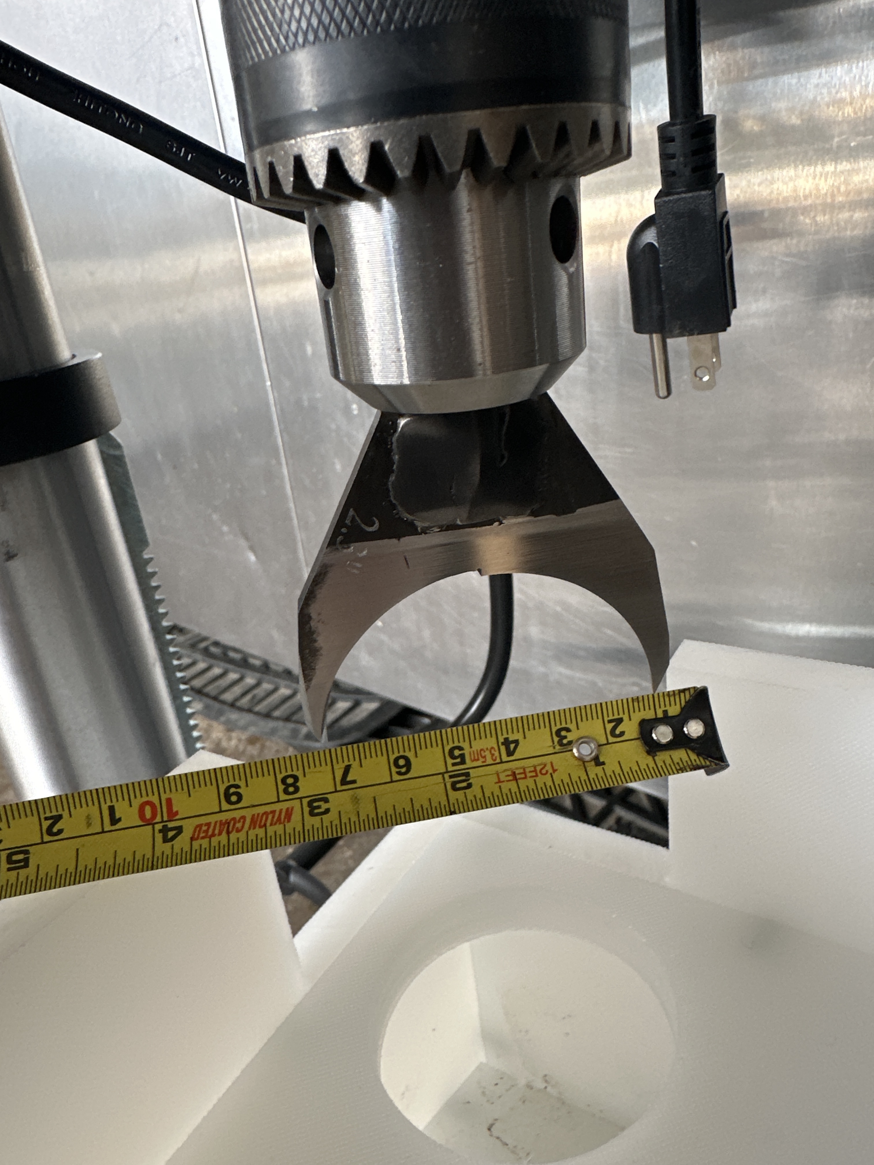

are you doing the spheres on the cnc also? ball nose?

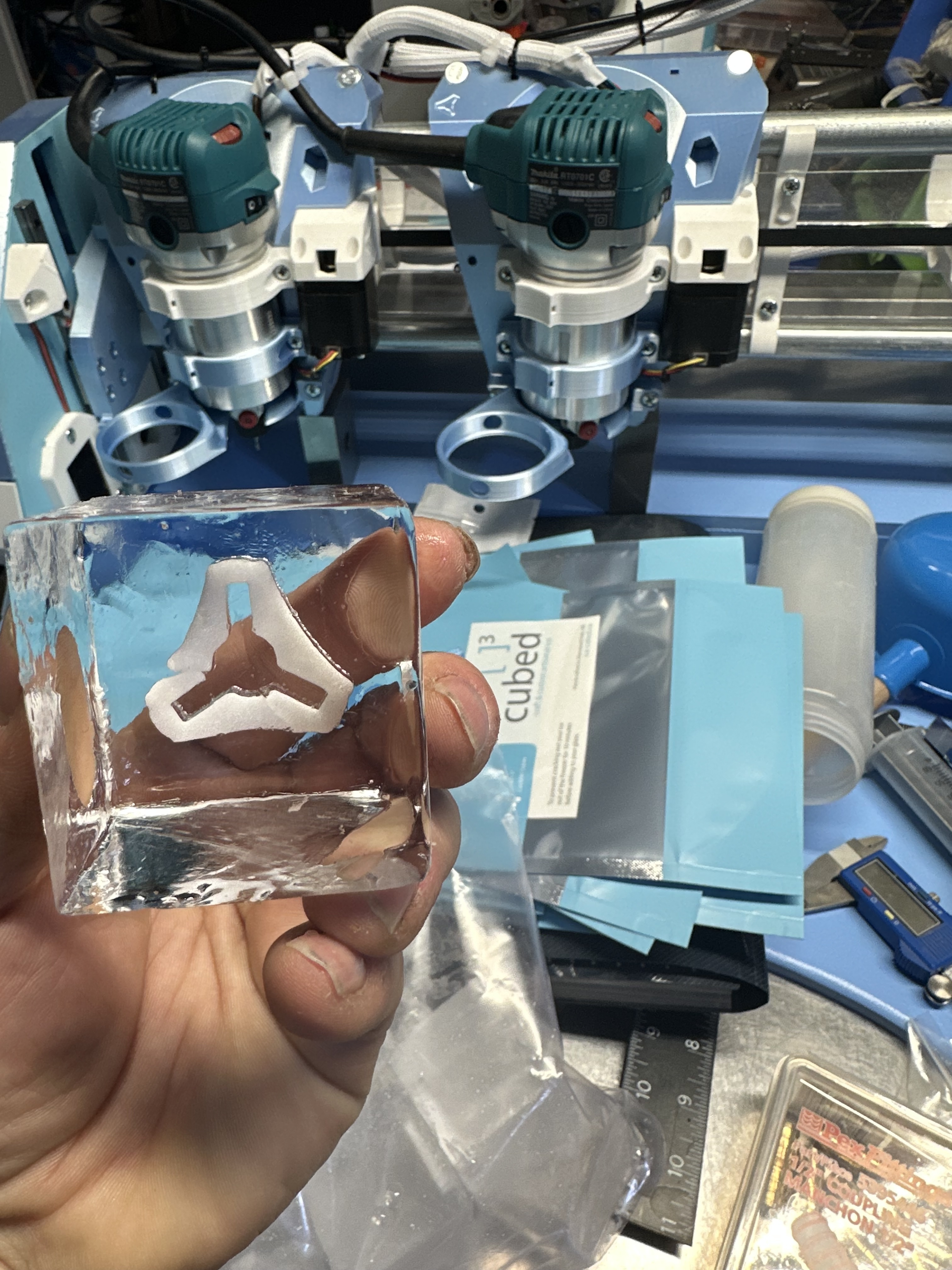

whoa wait!!! Are you running Idex tooo???
“The Big Guys” use their cncs to make the spheres but they also run 20" x 40" sheets when they do. It’s a flip job. The cutter requires a 1/2" collet. I pull mine out of 6 x 6 slabs I pre cut to fit the jig I’m using in a drill press. It took me about six hours and something like 50+ spheres to dial in the jig and I’m still only getting maybe a 65-70% success rate. If you’re out by .25mm on one side you double that on the flip. And when you want a clear sphere you have to be right on the money. Even a little scrap of snow on the jig is enough to throw things off. It’s actually quite a PITA.
The LR is just dual core. Not IDEX. They both do the same thing. It’s pretty sweet. Cuts my engraving time in half!

how does the ice get so clear?
Would you believe me if I told you it’s the $20 pump inside the $10,000 machine? That’s pretty much it.
Well… do i need the $10K machine or can I just use the pump?
Right? Hahaha. I guess the super-duper flux capacitor powered cold plate may have something to contribute to the clarity too.
