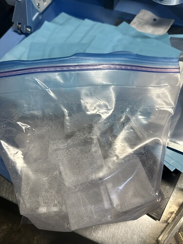

After engraving the logo would you normally cut each one out as a cube?

They already make the perfect packing material.
And here I was gonna go all ghetto and use a Ziplock. The freezer one of course. That would work, right?
You are absolutely correct. The “big guys” use a tool change on the CNC to cut the cubes afterwards but I prefer the marketing angle of being “hand cut” (on a saw). And I don’t have a $20,000 CNC machine.

Silly me…I bet ya’ll would like to see what’s in this bag hey?
