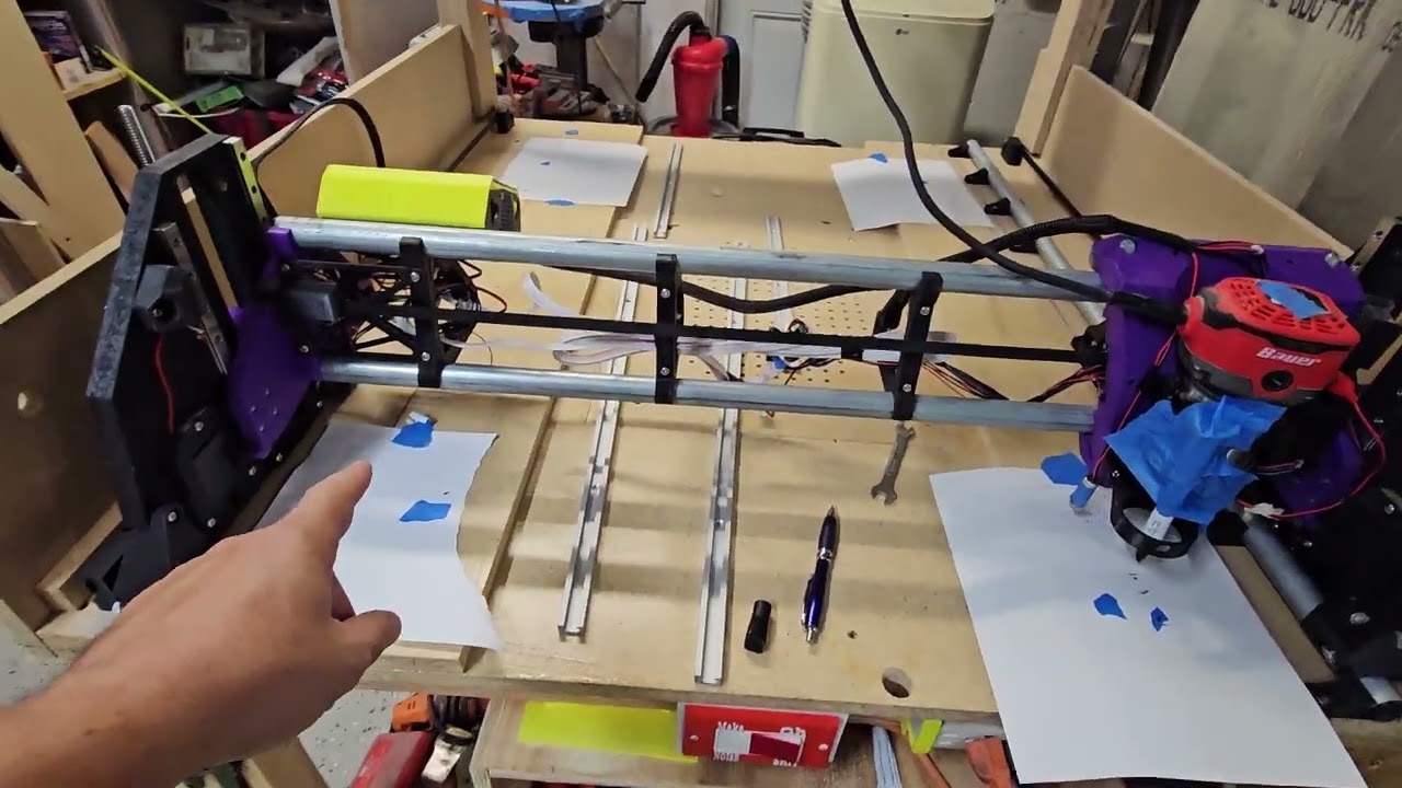

Quickly squaring the lowrider
I might be late to the game but my take on quickly squaring the LR3.
Damn… that’s cunning like a fox that has been appointed professor of cunning at Oxford University!
With the bed sizes on the LR, driving it all over the place to keep retaking the back measurements is tedious as heck, so this makes a lot more sense.
If anyone has the SKR Pro controller, you don’t even need to plug in commands, you can adjust the y-axis offset in the settings screen, and save it to EEPROM from there, so right on the screen. I found that out after randomly tapping through screens, I had been previously doing it with manual g-codes per the build instructions.
