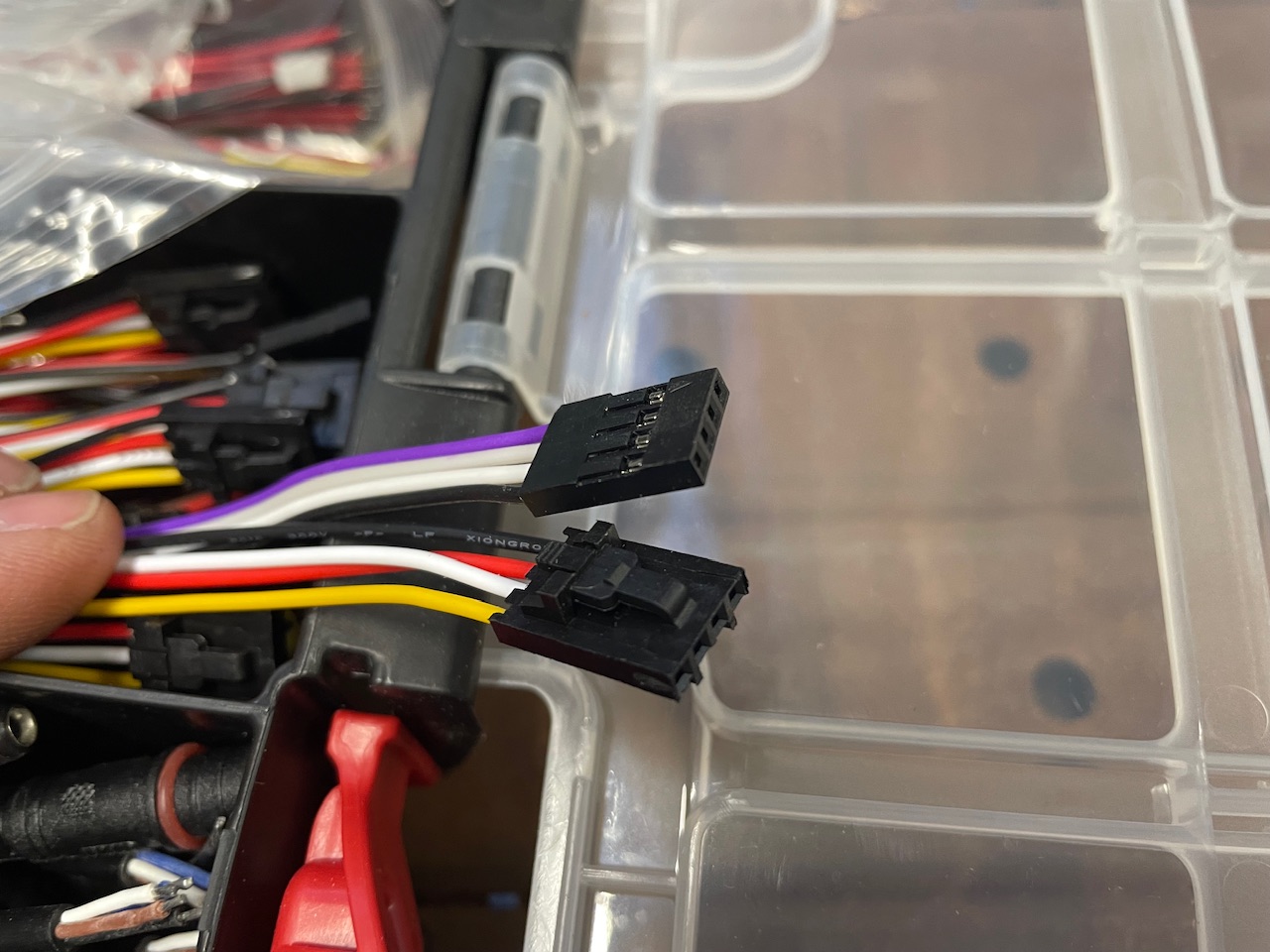

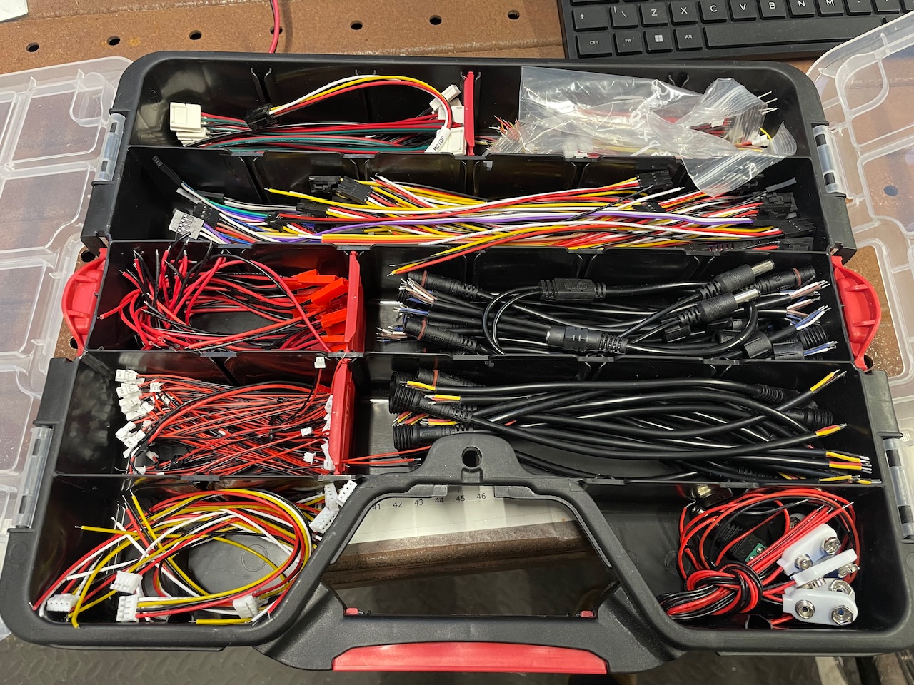

Yeah, naw. I just buy pre-crimped leads and swap the shells if I need to, life’s too short.
20 4way plugs with 30cm of cable (so 80 crimped leads)
4bux - delivered in a week.
Smarter man than I! What are the leads called?
If you go that route, I’m a big fan of those solder seal heat shrink butt connectors for splicing the wires together.
Just ‘Dupont wires’ or ‘dupont leads’
I also got the locking dupont versions!
100%! I was edumicated about those life savers early on (thankfully early on) on my Christmas light journey. I order them by the 1000’s now and always have some on hand.

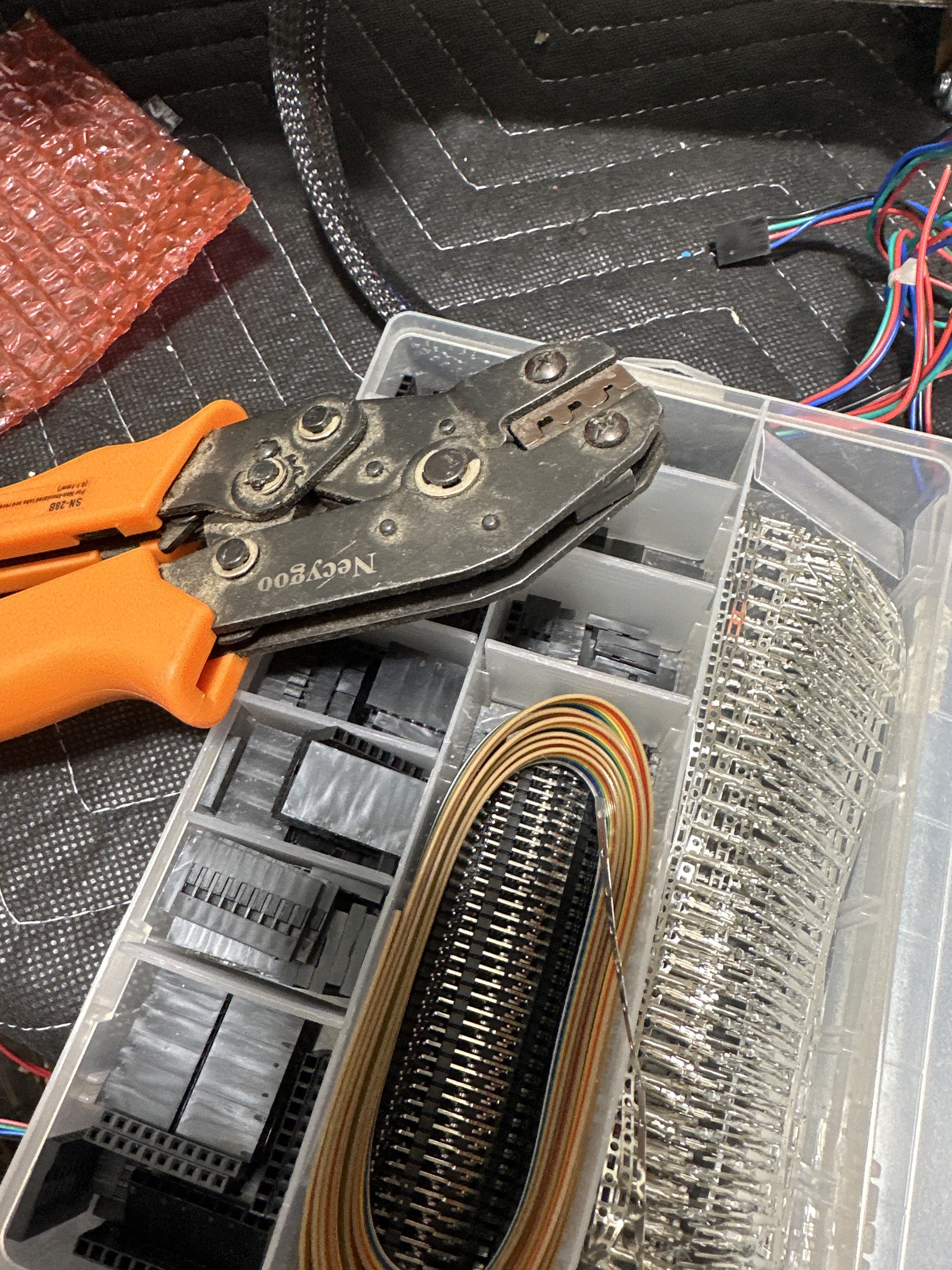

Just ordered some DuPont leads. I DID give it the old college try but yup - these things still frustrate me to no end. I got 1/5.
I’ve bought 4 or 5 crimping tools, and have one that mostly works. I really hate crimping though. I did end up buying a bunch of pre-crimped leads, but somehow I still end up crimping, and hating every second of it.
I just gave up on those crimpers. I must have fat fingers or something but I went with one of these:
https://a.co/d/2B4DrIB
and have been much happier ever since. Takes two crimps to do a pin but they work every time once you get in the mode for them.

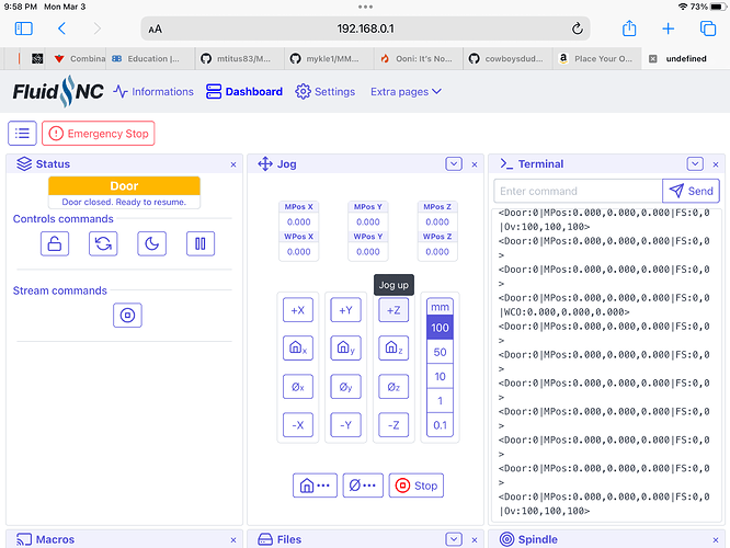

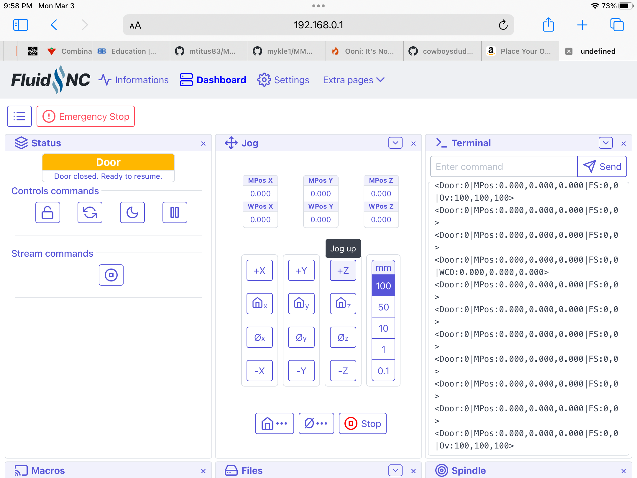

Just tossing this here from the iPad so I can go to my desktop and do some searching.
Searching didn’t really come up with anything. This is a board right from Ryan, first power up. The only thing not connected is the probe. The probe wires are connected to the pins on the board but nothing on the other end and not shorted out (the LED on the Jackpot isn’t lit for the probe circuit either). Did I accidentally leave the door open? And if so, where is this door? I do feel a draft but i have a lot of ice machines running in here…
I’m not running UIv3 but is the Emergency Stop a reset button like the Alarm in v2?
In your config does it have a pin listed for the safety door?
control:
safety_door_pin: NO_PIN
I have never seen a door error. Maybe it would be best to just wipe and reflash it.
I’ll have a look at the config for curious mind but yes, maybe you’re right…best to reflash. Maybe you were up late the day you flashed this one ; )
I wish, I automate it all so It should not be able to be different.
It really is just easier to mess something up with a setting and a save. Marlin was pretty locked in, you could not really mess anything up, with fluid being easier, it also gives you more freedom to mess up a config.
