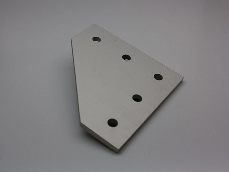

Longer back so the belts can connect back there on the 3060. Some sort of standoff up front for the other ends of the belts. There’s enough “dead space” in the corners because the cutter can’t go edge to edge that I could probably assemble with 90 degree plates as well as typical connectors to ensure it’s nice and solidly assembled.

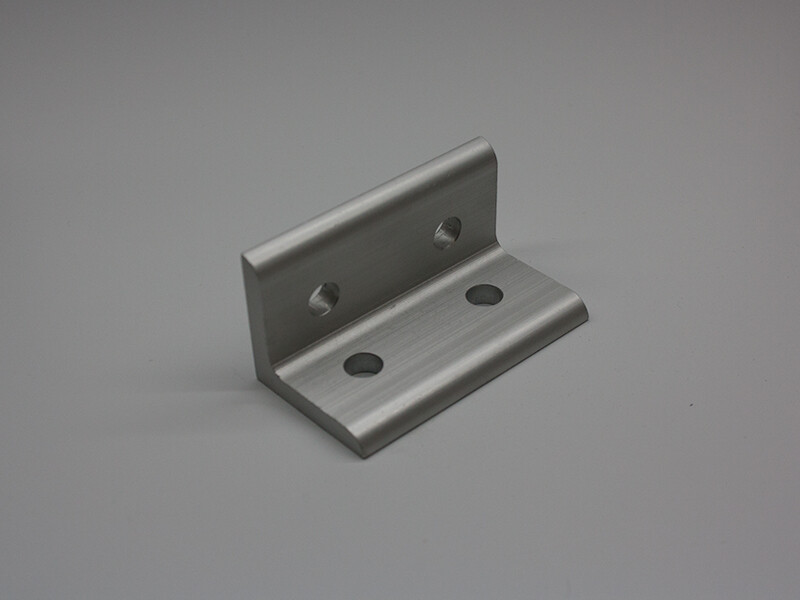

These corner brackets work well, too:
https://www.amazon.ca/Qjaiune-Aluminum-Extrusion-Brackets-Connector/dp/B09G6JGD3K

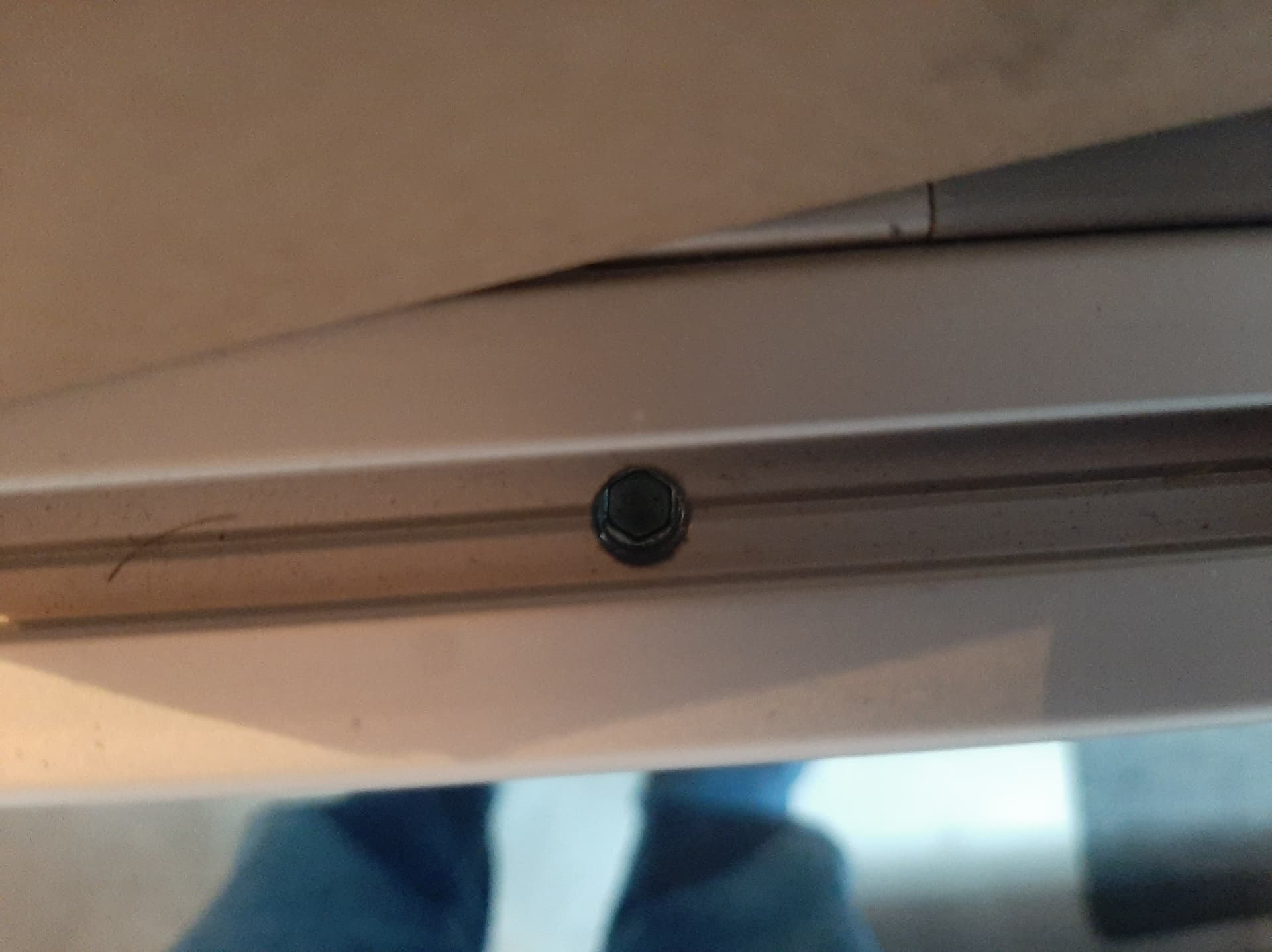

And with that design, I would tap the holes on the ends of the y direction extrusions with an M8x1.25 tap, drill 1/4" access holes through the x direction extrusion to pass a hex key through, and screw them together with stainless steel M8x1.25-25mm button head hex screws. That’ll make it rigid and pretty square. Add corner brackets for more squareness.

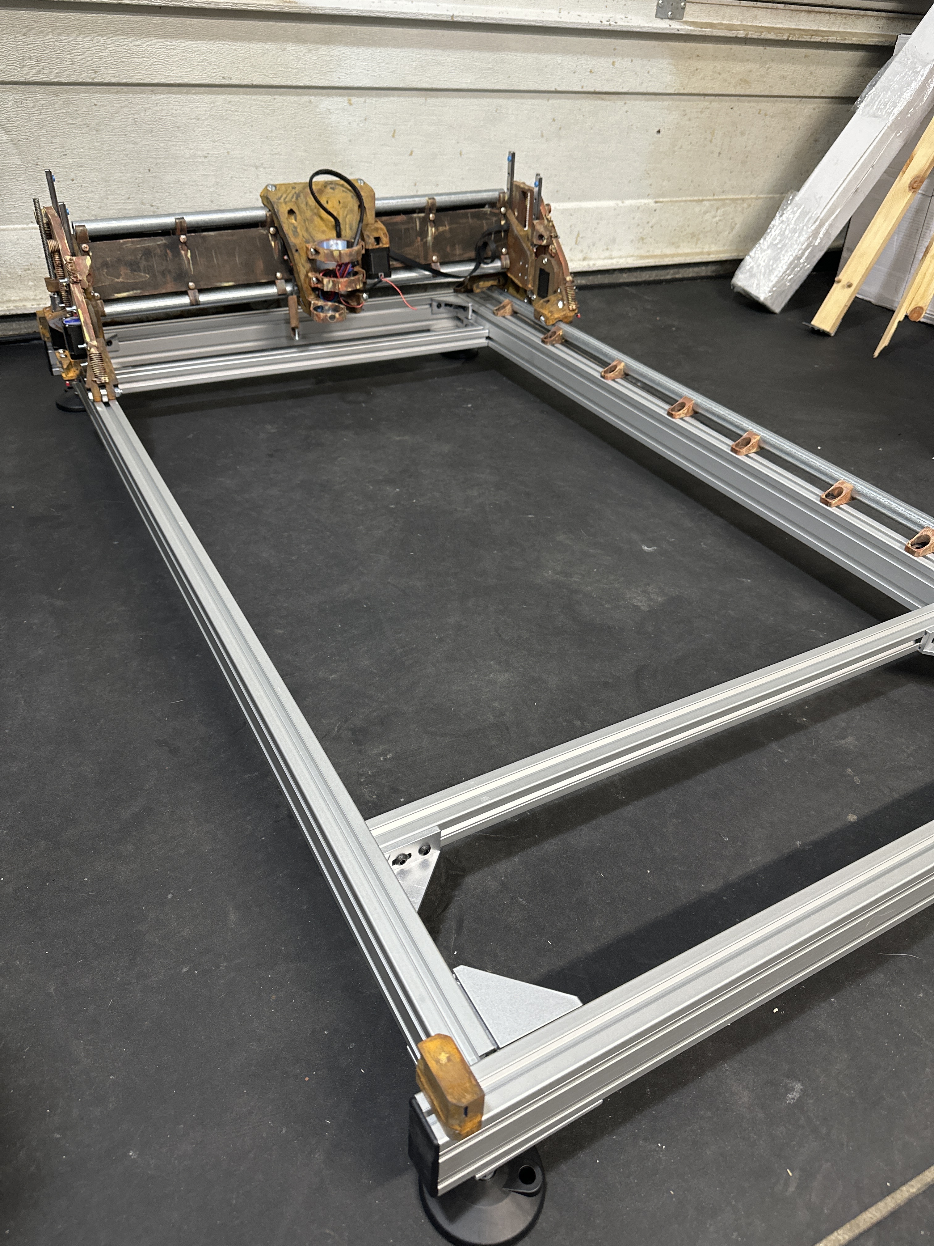

So all I need to figure out is the length I’ll need the inner span 3030s. Thanks for your help! It may not be as “disassemble-able” as I’d envisioned but the frame would hang on the wall out of the way intact just fine.

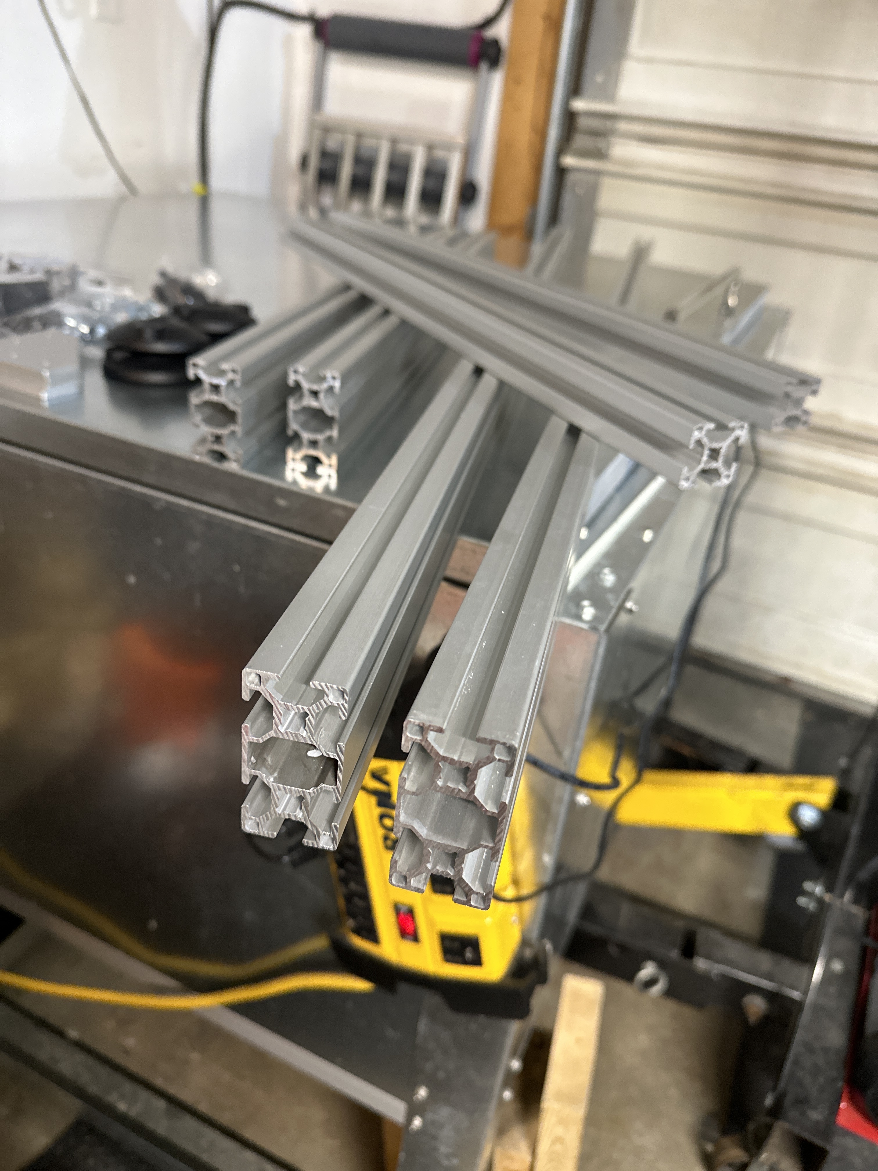

In between winter festivals the last piece of the puzzle arrived. Very well packed for sure. Looking forward to getting this built up. May have some time this coming week. I do know this much - it’s going to be quite a large frame. But it is what it is. The shipping label says it’s only 11.8kg. Sure feels heavier than that. But that’s good. Nothing wrong with the machine having a little extra substance to it while it chews on a maybe 300lb block of ice.

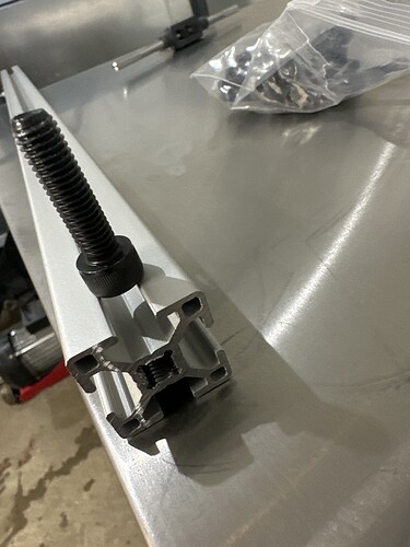

Question re: extrusion drilling
If you did not have a drill press (mine has an ice cutter attached that took almost eight hours to fine tune so I don’t want to remove the tool) is there a way to drill out the slot edges so the head of the bolt can fit for the through-hole connecting points?
I use M8 button head cap screws slid in from the end without modification of the extrusion. Some low profile socket head screws fit, too, but I think you have regular profile screws. I think a grinder is the tool you’ll be needing… to grind down the screw heads.

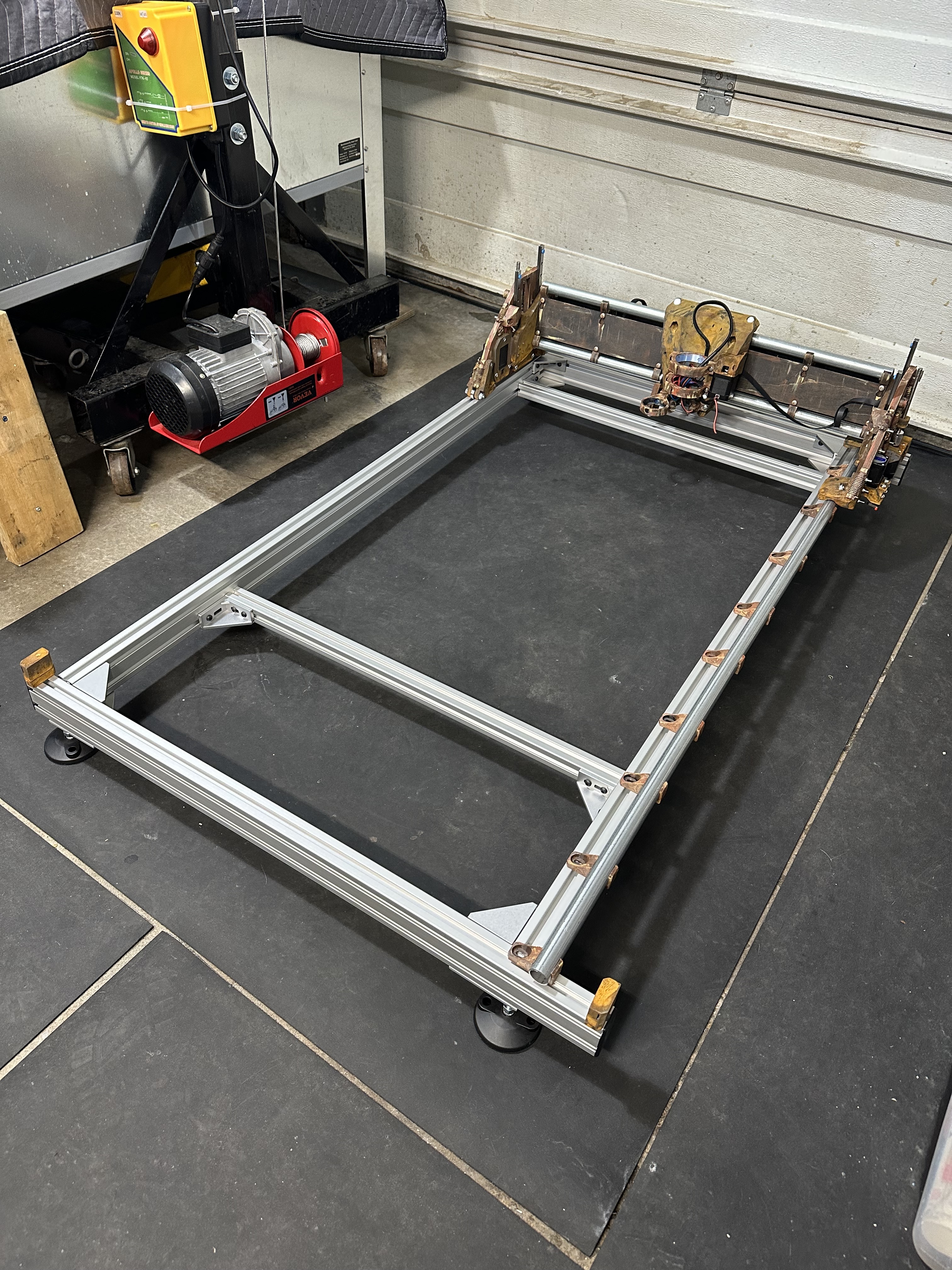

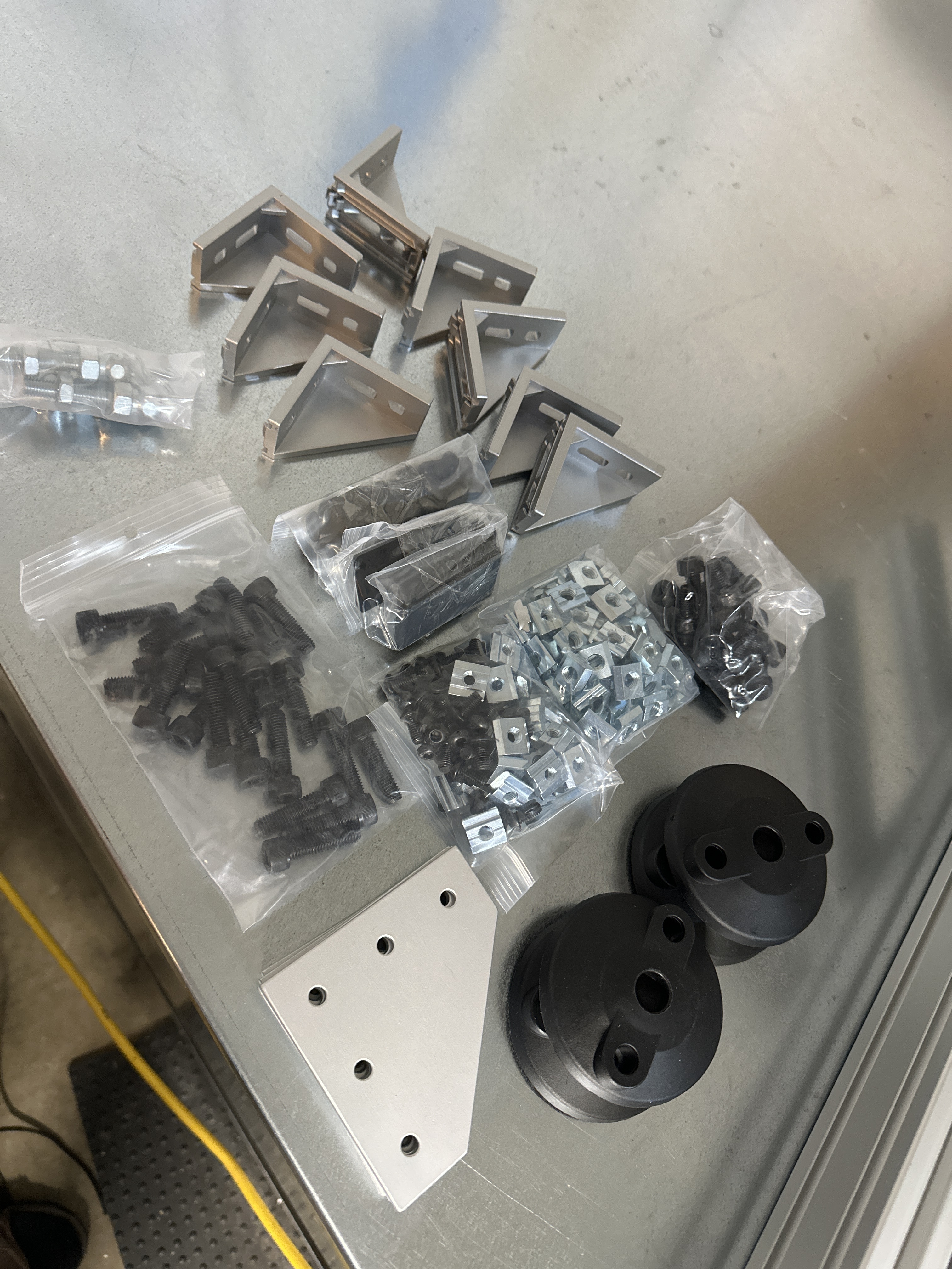

I went ahead and dry assembled using all of the corner hardware bits I ordered to back up the through-extrusion connections and probably smart to do that. I’ll get the machine all fine tuned as far as the rail positioning, get the rest squared and then drill and tap. I’ll also add loctite to the hardware at that point too.
It looks great - but I’ll rectify that, don’t worry! the savvy out there might zoom in on the pics to see where this machine is going in the aesthetics department :wink:

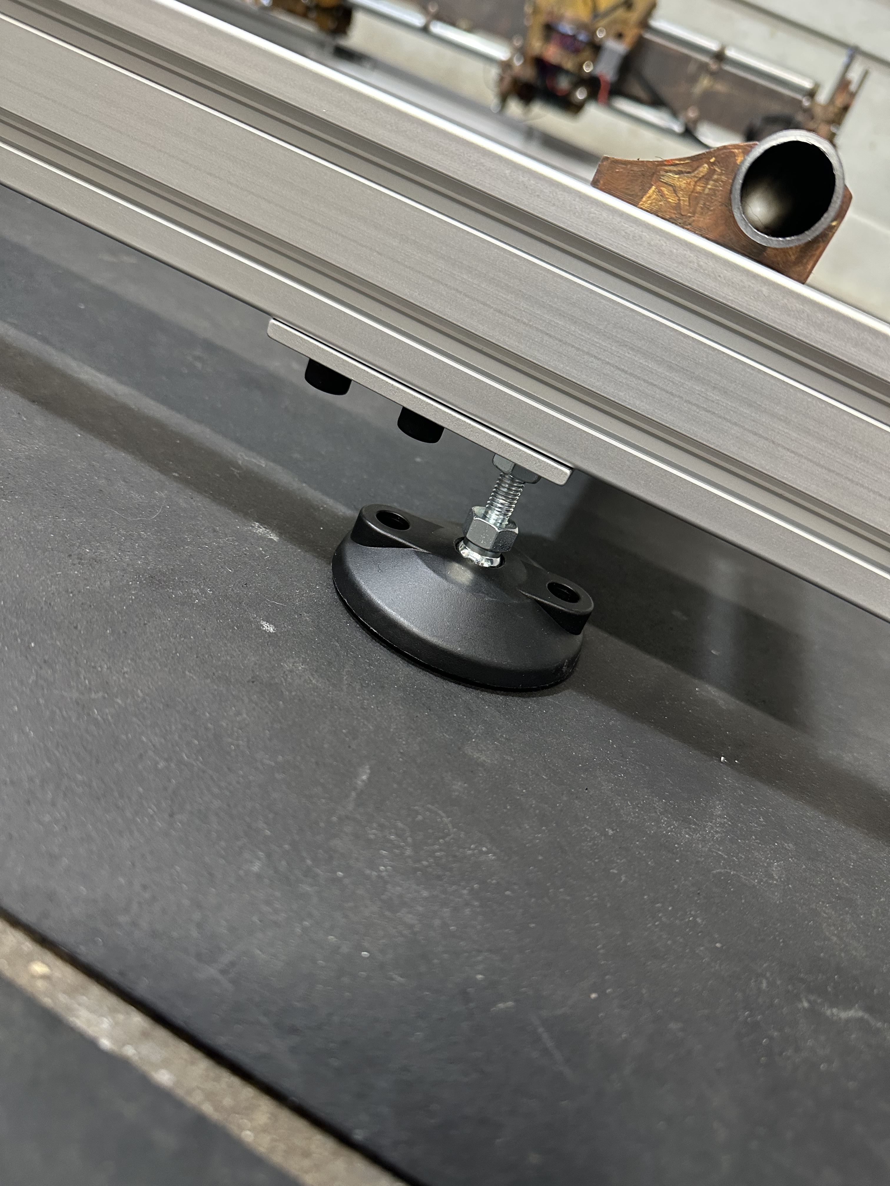

The adjustable feet will likely just be set level and then any adjustment actually needed to level to the inserted block of ice will happen via shims or whatever does the job. Once the ice is “clamped” into place it won’t matter.
That floor mat it’s sitting on is 4’ x 6’. The end to end distance in the Y is 55". X is 29.5" from bearing to rail. The Y distance between the 3030 inner X rails is 40" - the block of ice will be “clamped” using the forward most rail so I’ll be able to put any length block in that I happen to need. I do believe I’m just going to cut some strips of gang nail and attach that to the inner surface of those two rails to bite the ice and keep the machine connected to the block of ice.

It occurred to me last night that my narrow stepper bit will do the trick. I printed a drilling jig to ensure the pilot hole is square and centred so once that hole is there my narrow stepper bit will be able to enlarge that hole and presumably bore out the tslot shoulders to fit the bolt head through.
Oh, I didn’t realize you wanted to through-bolt it rather than make a blind connection using the inside flange (where you’ll get a little bit of adjustability if you make your hex key access hole slightly oversized).
Going your planned route, you may want to chase your step bit with a bit (perhaps end mill chucked in a drill) that matches the diameter of the bolt head to knock down the angled sides where the bolt head is going to land, otherwise the bearing surface of the bolt head is going to be rather small (with the round head landing on the angled portions of the extrusion). Knocking the angled sides down should make the connection nice and strong.
Thanks for clarifying! I took a second look at your photos and see what I missed. Clever. I was automatically in the “through bolt” mindset because that’s how my Creality machines are built. I see nothing wrong with how you’ve got it there AND I happen to have ordered a bunch of pan head allen M8s.
