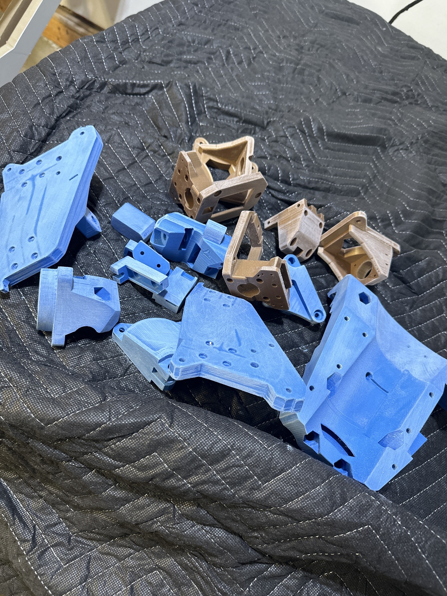

Parts are starting to pile up. All of the long prints are done. This is going to be such a fun build!
Blue and brown looks fun!
Just burning up any PLA I have sitting around. Although I’m reluctant to cut open the clear spool for some reason. Not sure what on earth I’m keeping that one around for…odd. I didn’t even know I had it.

I’m through Spool #1 including the partial brown I’d finished off to kick things off. All of the LR32 bits are printed and moving on to their next step. Still three more spools worth of printing to go for this bad boy though! Can’t wait to see it all come together.

So since the last post in this thread I have completed the post processing of the printed parts, have finished printing the three spools worth of ancillary parts and will begin finishing those while I, in tandem, begin assembly. I hope to have the machine running by Christmas but not fully finished until into the new year.

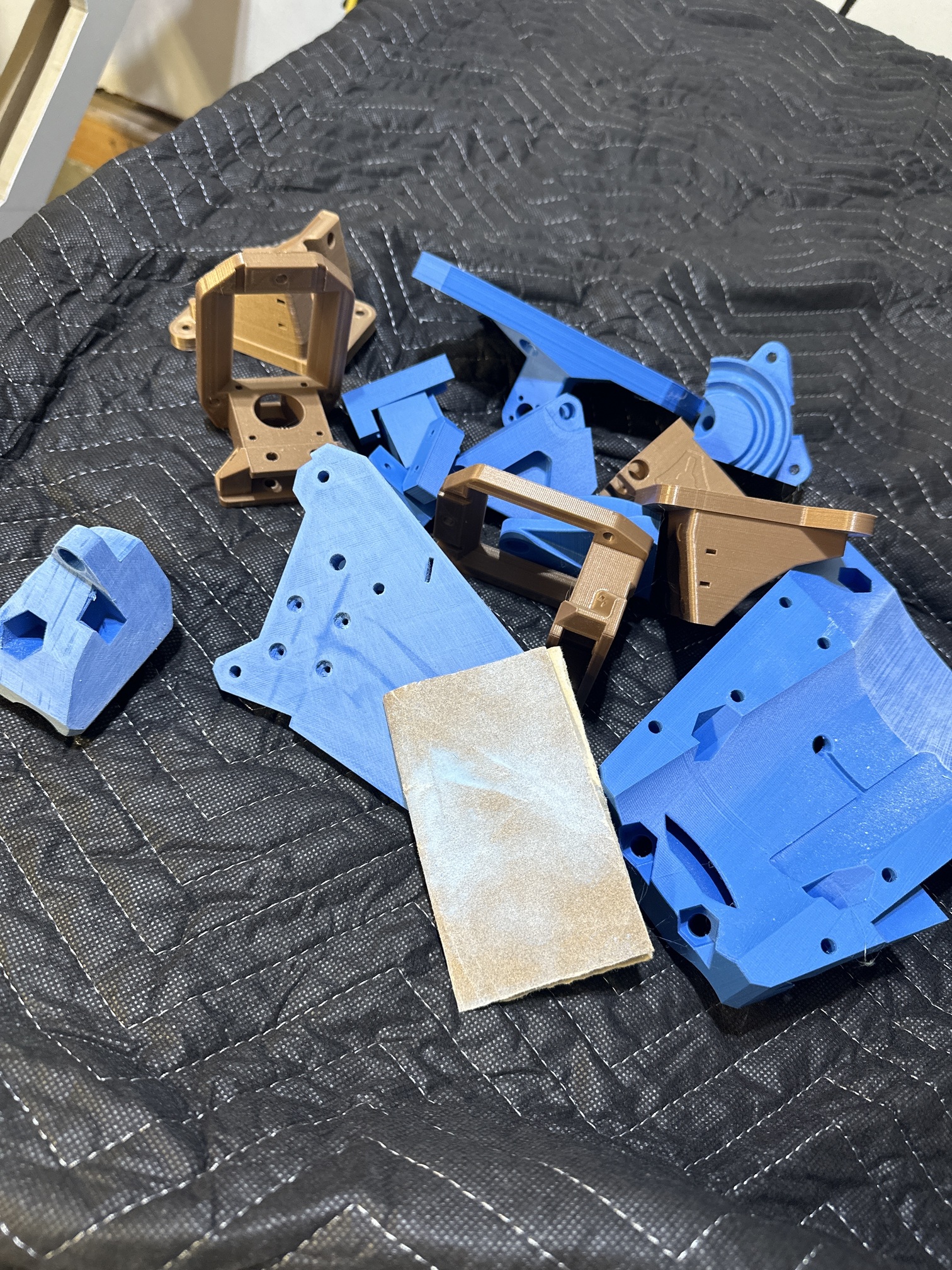

Missing at least one piece that am aware of (not counting the gantry braces). Shoot!
Looks like a bit more sanding to do (maybe). I don’t know how fussy I want to be with this one. It’s more of a learning mechanism for ‘the next thing’ I post-process.
Ever heard of grey PLA? :yum:
Stupid joke aside, I am really interested in the durability of the paint on PLA.
I use one of those plastic primers you get for car bumpers and stuff, then a primer filler, then paint. The only time I’ve had any trouble at all was when I used two different kinds of paint after misreading the can.
Sticks like the proverbial :poop: to a blanket.
I’ll be interested to see how it holds up as well - especially knowing the sub zero temps this thing will be exposed to. It was a high solids primer - nothing plastic-specific. But I most certainly didn’t stop there…you’ll have to stay tuned to see what became of the primer grey bits. It’ll be like my Christmas gift to everyone here. hahahaha
