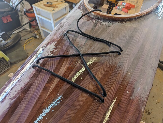

I think I finally figured out a way to use the cnc on this build. I have some fittings coming that I will need to cut some captured pockets for. We’ll see what happens.
And now that the time consuming parts are done, I can get back to making quicker progress. Today I got the excess fiberglass trimmed off the deck. I sanded down the coaming lip. Then I just seemed to keep on sanding until the rear deck was smooth. Then I was curious, so I thinned out some epoxy with acetone and brushed it onto the rear deck to see what it’ll look like when it’s smooth.
Oh, dang, that looks so good.
Spent the evening drilling 1/2"holes in a perfectly good deck. I only managed to screw up a little bit on the first one. I dyed the epoxy a dark color, so I don’t think anyone will notice I had to elongate a hole.
