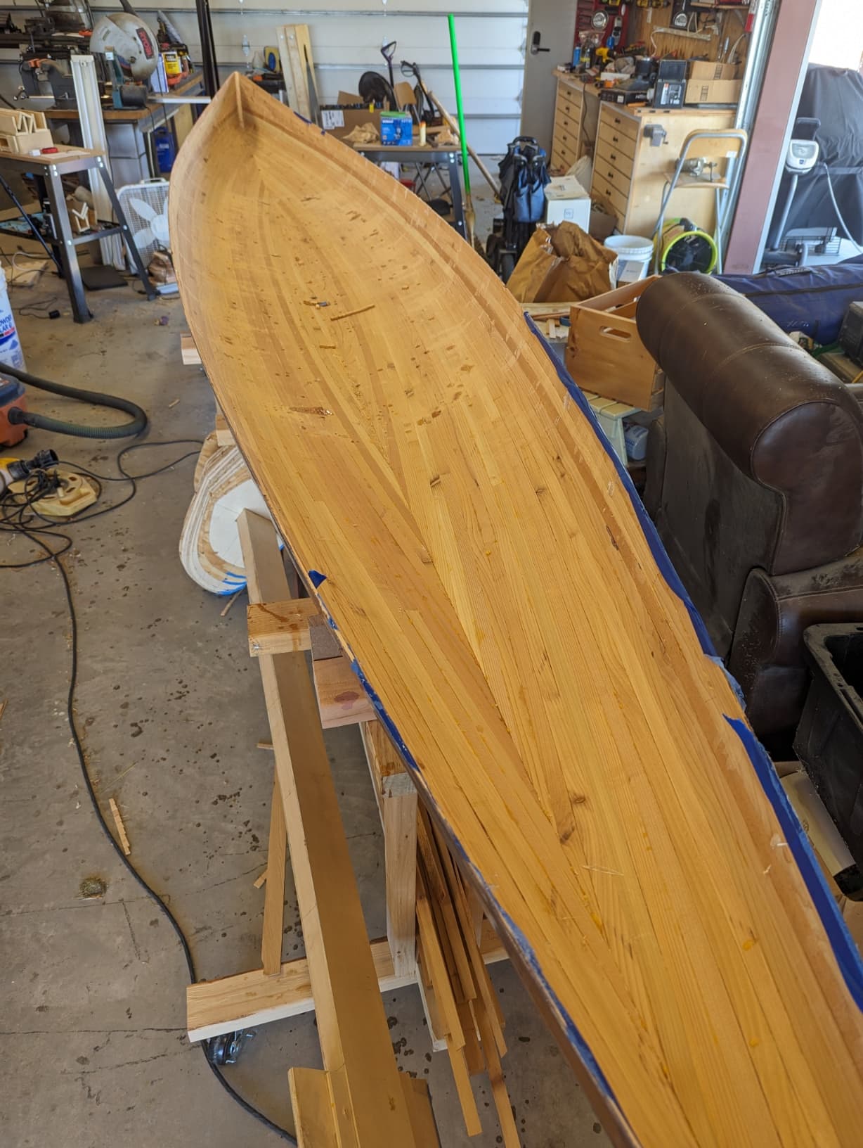

They didn’t get glued until they went onto the boat. The forms were just to get the strips to take the bend. They bounce back some when taken off the form.
Then they got clamped and glued on the boat one at a time. I waited a few hours between strips to let the glue take hold before putting the next one on.

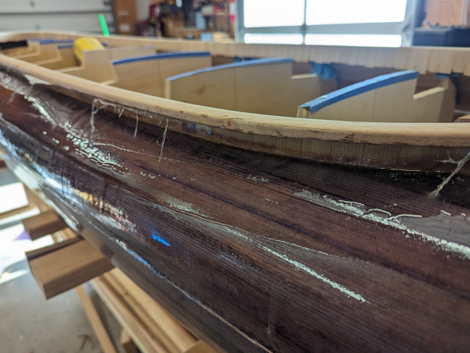

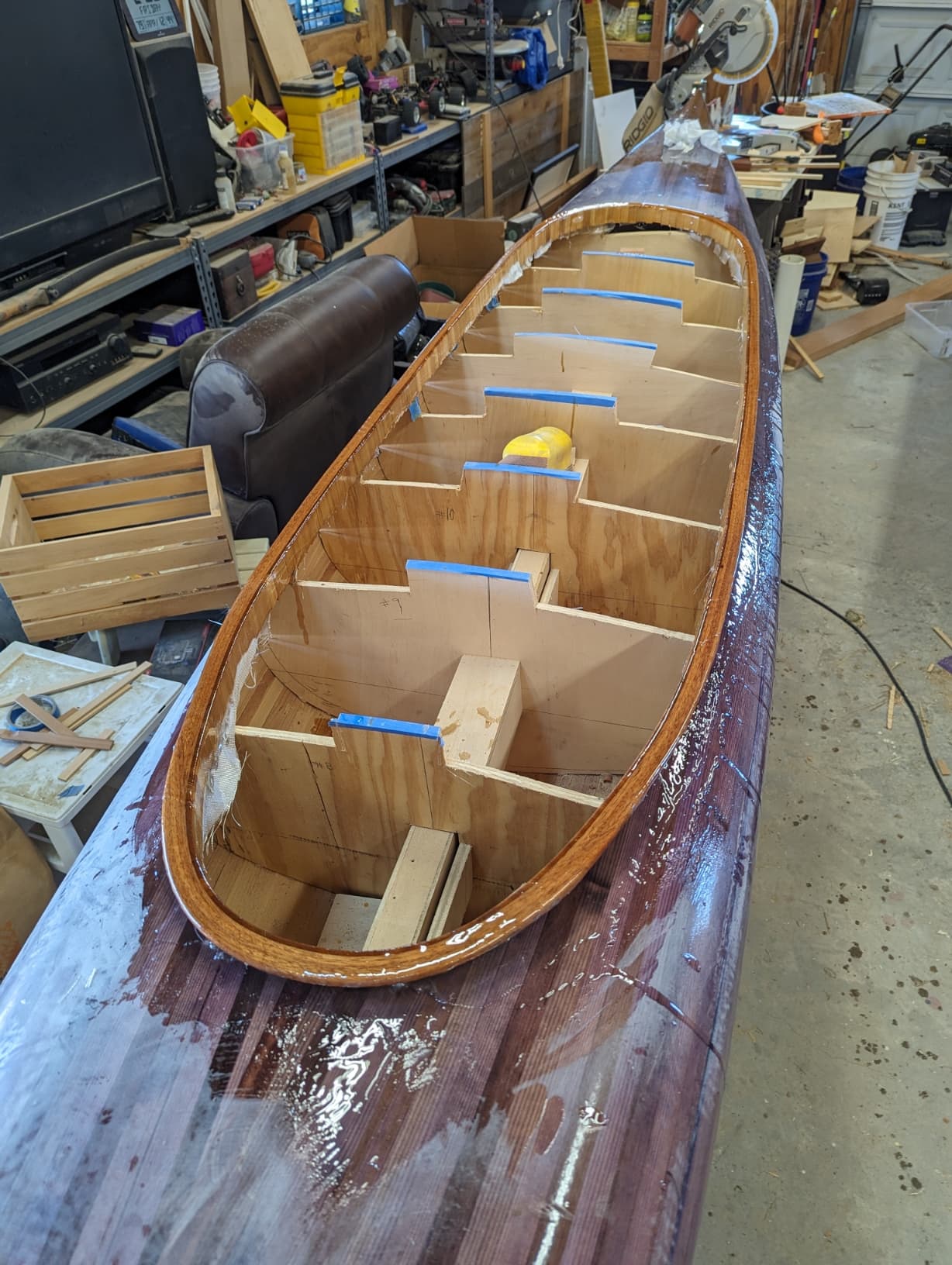

Finally getting more work done. Fiberglassing the coaming today.
This was probably the most difficult part of the boat so far. I had a hard time getting the glass to stay where I wanted it.
It’s not horrible, but I’ll have some bubbles to fill.

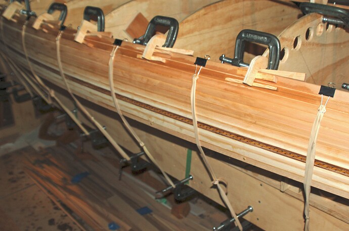

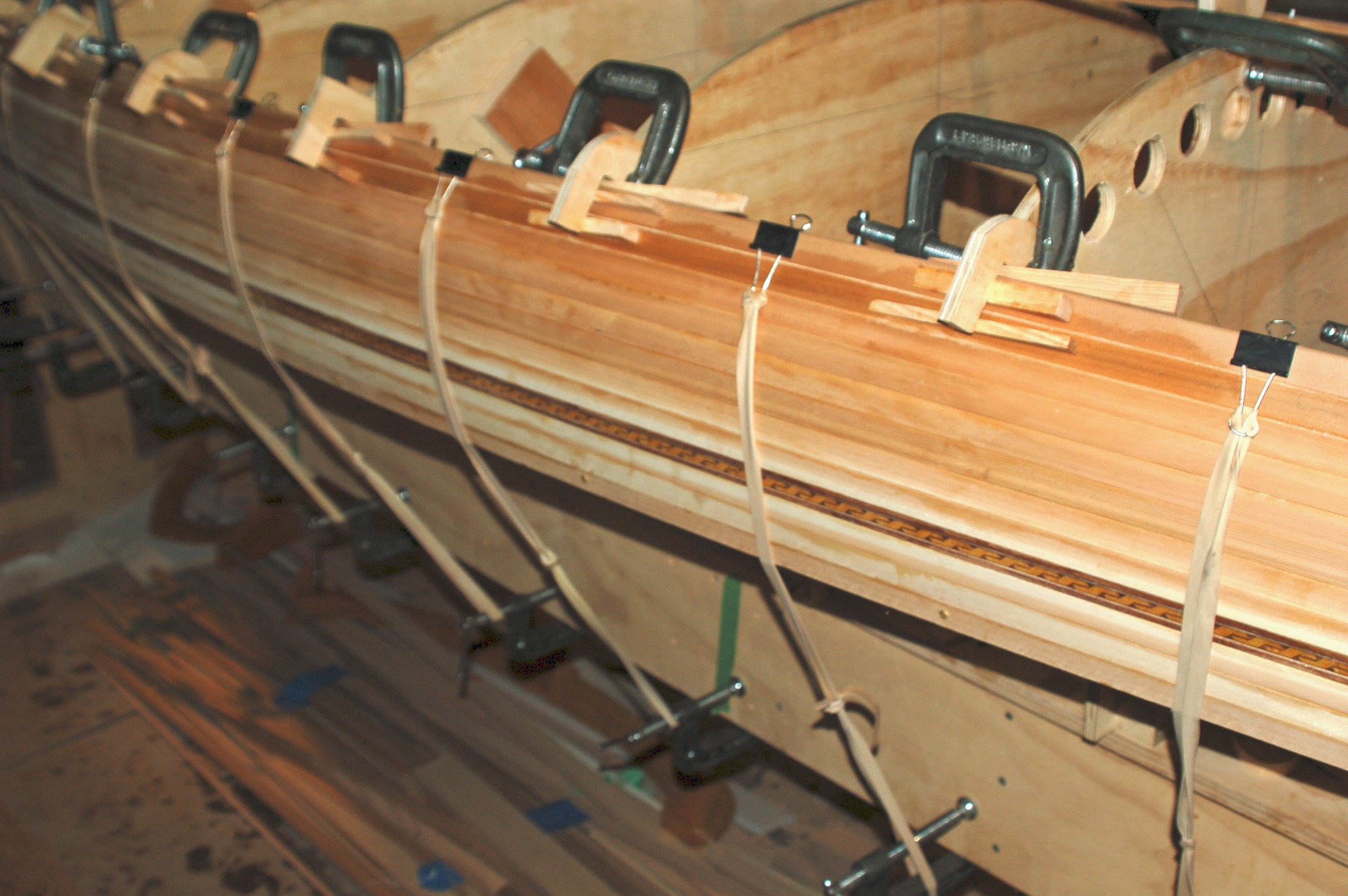

Here it is. I stole this off of Facebook…
His strip clamps are larger U-shaped pieces of wood. He then uses wood wedges to apply pressure holding the strisp to the forms and another wedge to push the new strip onto the previous one.
Then it looks like he goes back with large rubber bands and binder clips to pull the strips down onto the previous one inbetween forms. This would work better than the tape method I did as the tape tend to come unstuck while the glue dried or you couldn’t apply enough pressure.
