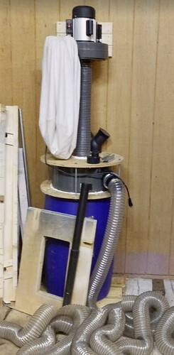

I got a fiber barrel off facebook marketplace years ago, and added a thien baffle. It would be super easy to cut out on your CNC. I had to do mine by hand.

Here is some more pictures that might help. This is well documented out there, but figured I would show you how I converted the HF model.
I basically threw everything away except the motor. This is from my old house where I didn’t even use a filter. I just exhausted outside. The barrel collected everything and I never saw any dust outside. I’m sure there were micro particles and such, but never noticed. Today, I have it exhausting into a used HEPA filter bag from my Festool dust extractor.
You can download templates that tell you how to cut the hole / pipe based on the diameter of the tubes. I don’t remember which one I used, but something like this. Tube Joint Pattern Generator. Then I JB putty welded it on to cover any micro gaps.
Threaded rod to hold it at the right depth
Inside it sits something like this
The fiber barrel used to be filed with Silica packets. I think I paid maybe $5 for it (empty) on Facebook marketplace.

What a great job on your setup. Love it. Great use of available materials in the design. Nice.
How many gallons in your fiber barrel? I was deliberating between 20-ish and 30-ish.
It’s about 18" in diameter and 35" high

Wow. That looks identical to mine: Dust collector chip seperator
IDK if we read the same guide or what. There is a guy in Denver that buys and sells these barrels for cheap. Mine used to contain dried milk or something.
It works great. I don’t notice anything outside.
I do stagger the starting of the DC and the table saw. This is a big motor. But it is quieter than the saw when cutting.
Yeah I lost the actual reference. I made it years ago.
I have mine on a separate circuit now. The planer and dust collector can pop a 20amp circuit sometimes.
Just looked at your thread more and wow. We even took the same pictures haha
I had decided not to try to print this, and was moving in favor of a Thein baffle, but then I remembered that I had been given some gift cards to Lowe’s, and I was able to buy the larger Super Dust Deputy 4/5, without being out any money. So I have pulled the trigger on that.
I didn’t take enough pictures. The center part is the same part that comes with the dust collector that would have the dust bag on the bottom, and the filter on top. I added the thein baffle to the bottom of the center part. That kept the full volume of the barrel for chips, and in my case, bat poop.
