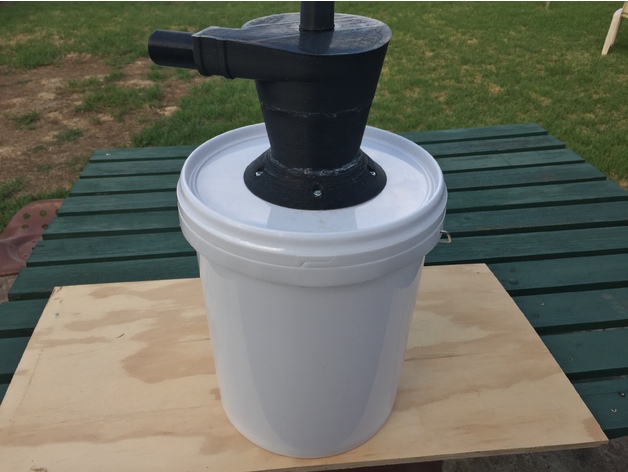

I’ve made a couple of these and pair it with a shop vac off the Primo with a 2.5" hose and works okay.

I printed this one and it seems to work pretty well.
https://www.printables.com/model/74660-cyclone-vacuum-dust-separator
