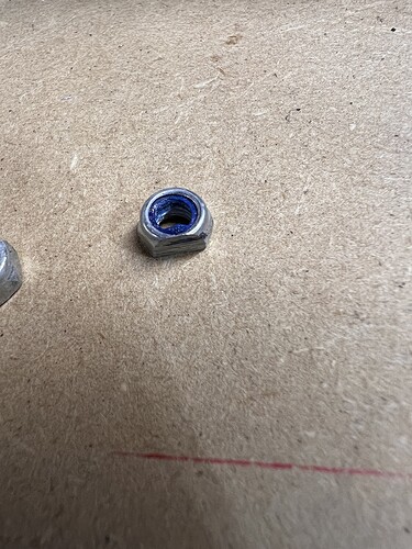

Belt sander!! The thickest part is the side of the nut I think.
The backside not the pretty side!!
There isn’t much to shave off on the back side. I can see the nut though the plastic now LOL. Had to take some off on the fat pretty side. If I was worth a :poop: at remixing I would make it thinner and leave the logo. Good thing is that’s an easy part to swap any time if I ever do acquire the skills
As thin as it can get on the backside, you will need to shave down a face of the nut. 1.5mm thinner.

Edit. Just loaded it into the slicer and now i see what you are saying. Just started a print before I saw this. As soon as its done I will load this up and see how it works. I’ll take a nut to the belt sander and get it to fit. Thank you @vicious1 !!!

Took a little too much off the first one. Sander took it way faster than I anticipated lol. Hopefully the second will be better
As always @vicious1 you are the MAN!!! Gave you no measurements or anything and you nailed it. It doesn’t rub on the core at all. At least not enough to feel or hear in any way. Thank you!!!
