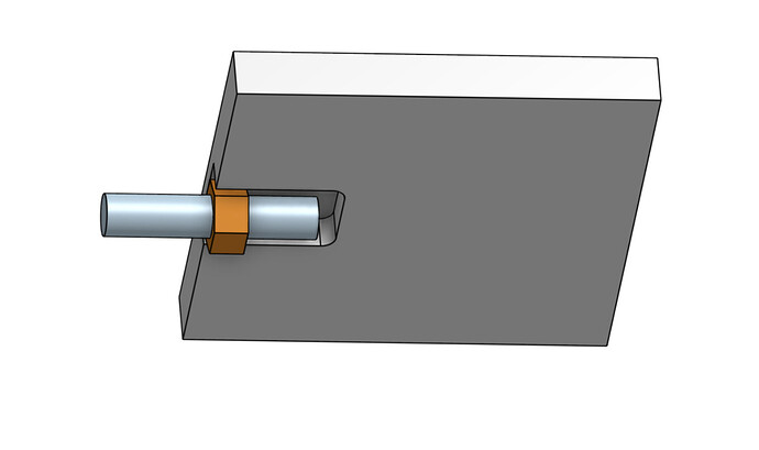

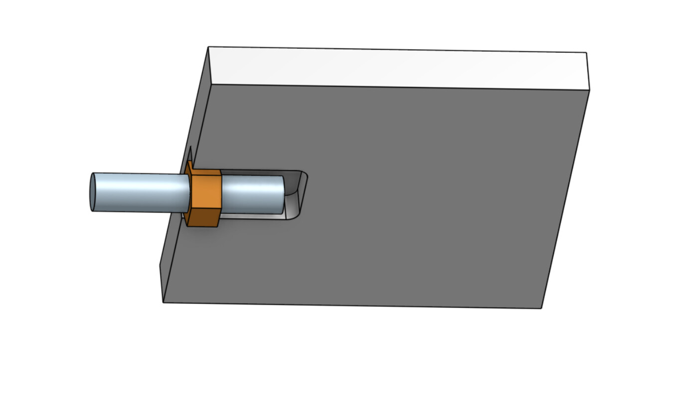

I presume you want to keep that bolt that clashes with the beam!! I think the simplest and nicest way will be to remove the strut, and mill out a little clearance slot, just deep enough to hold the nut captive. You might have to take it all the way to the cutout, but I’m pretty sure that you won’t notice that.
Actually I’m pretty sure that you will and it will haunt you all the days of your life. Cut the screw so you don’t have any excess on the nut and keep the slot as short as you can.

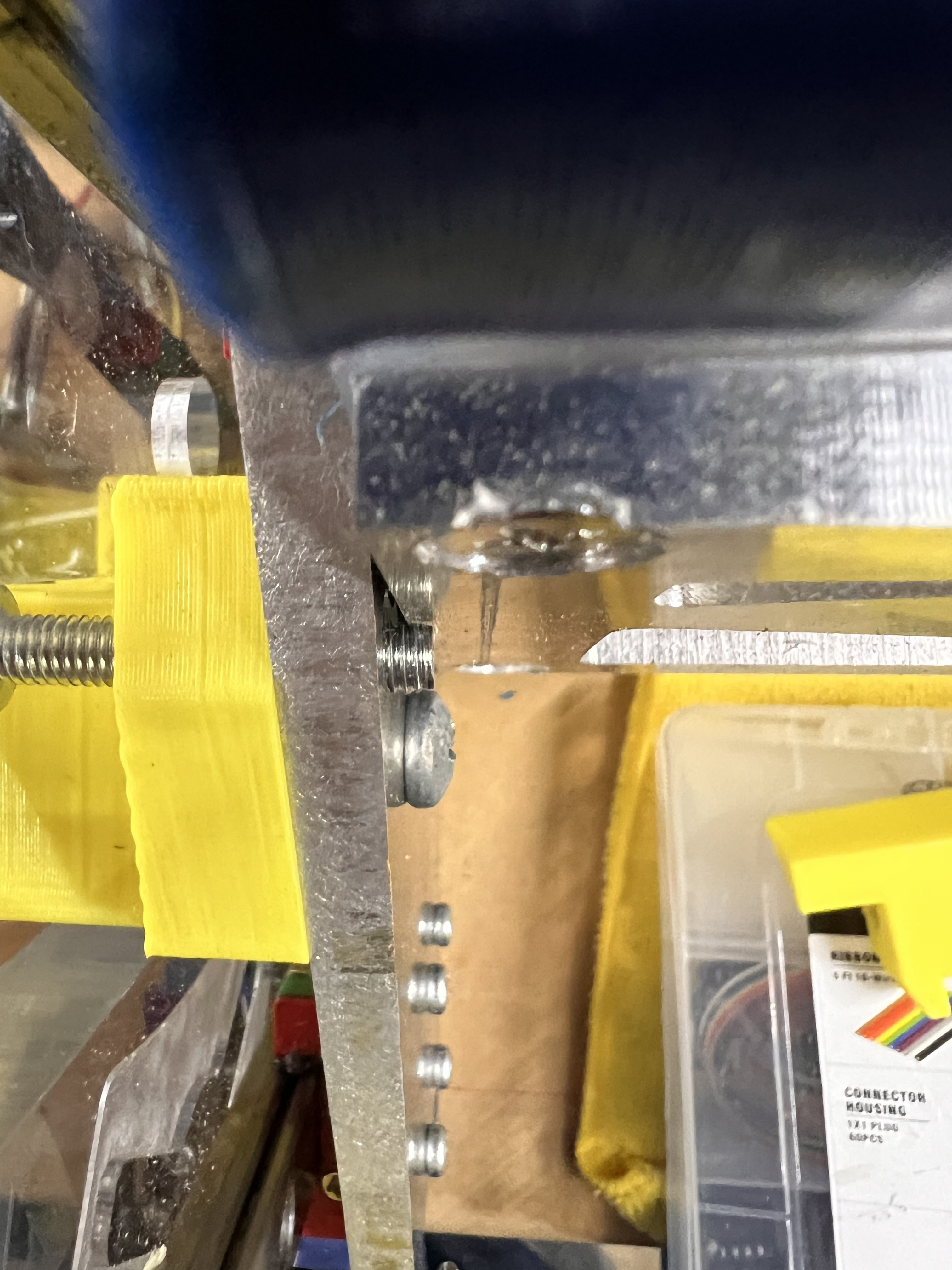

The screw coming in from the side that catches the X belt tensioner is dead tight up against the strut. I’m also noticing a few spots where the idler pulleys on the X motor rub too. I’m afraid its all going to have to come back apart and figure out how to shave another mm or so off of the acrylic to buy some wiggle room
This is the screw that goes into the X belt tensioner. So unfortunately I will need more clearance than just that. I think my only good fix here is to removed the strut and the acrylic and figure out how to safely shave another mm off the notches in the acrylic
lol I’m already looking at how far these screws stick out on the YZ plates and thinking about replacing them with shorter screws
So is it that you have 1/4" of aluminum plus some thickness of acrylic combined to make a strut that’s actually thicker than 1/4"? My struts are 1/4" plywood, and that seems to be OK.
Yes that’s correct. I spoke with Ryan about it and he said I could come out the thickness of the screw heads. But neither of us thought about the x tensioner or the idler pulleys lol. Oh well live and learn. Now to figure out the best way to shave off some of this acrylic

Ah got it. How about just milling a groove in the aluminum strut in the region where the belt etc go?

That is a possibility. Once I have the strut off the acrylic is just sitting there so I will look at that option first. If I cant come up with a way to get it done without wrecking the acrylic then I will look at the option to mill a grove in the strut the width of the belt tensioner
