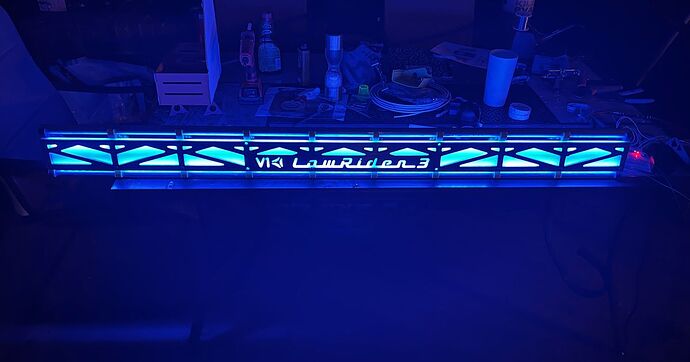

Thank you. It was definitely a TON of work to get to this point but I’m happy with the outcome
And thank you @DougJoseph for the amazing design. Hopefully I did it justice
Beautiful design, and build. How did you mount the lights? Guessing am not the only one you’ve inspired to pimp out our gantries.
Modeled up a mount for the LEDs behind the acrylic. Printed up a test and then made some minor adjustments and printed another. Now the V4 has 6 on the bed to print tonight. Will have to print 3 more in the morning. It fits well and hopefully it will work as good in practice as I think it will in my head LOL.
It needs a tad bit of adjustment and will need the base sketch edited to suit your brace spacing. I will upload it to printables and post the link in a few or in the morning lol.
On mine I have the lights set at 60° I think I should have went with 45°. It doesn’t show up in person as much as it does in the pics but that dead zone in the middle could be better with more angle I think. Should have done an actual light test before just going with it. And the notches for the wires need to be opened up just a touch. Another mm and they would have been perfect. They worked but not as well as they could have.

Thank you both!!! I cant wait to see it all finished up. Going to do some testing later today for the side plates on some scrap I have, see what gives them the best look. Going to see if flame polishing the part where the lights go helps get more light into them, And thinking about spraying the backside (beam side) with some frosted spray paint to see if that makes them light up anymore as well. I like the ones on my smaller LR3 but why not try something new lol.
@azab2c and anyone else interested. Here is the link to printables for the files. You will have to go in and modify the sketch 1 dimensions to suit your brace spacing of course so the .3mf files I uploaded are basically useless but oh well. If anyone tries them out let me know what you think. This model will seem extremely basic to most but it was out of my wheelhouse for sure and I’m curious as to anything I could/should have done differently. Always looking to learn more for sure.
