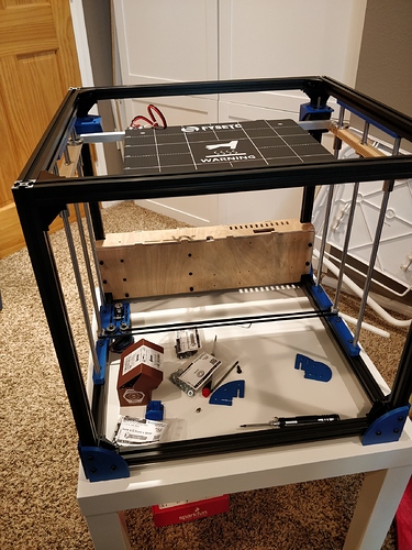

Here is an update from yesterday.
I cut a box from 1/4" cheap plywood. I was considering using some more baltic birch that I have, but the options were either 3/8" or 1/8". I must have gotten one of the CAM files confused and made the tabs on the inner part a bit big. Nothing some sandpaper and elbow grease can’t fix.
I got my bolt depot order in. I was able to finish the Z axis, under the bed. That looks really nice. I found a few more issues with the larger angle brackets I have. So I decided to just follow the BOM and get the smaller ones. Specifically, the front corners need all three swapped, instead of just one, and I am thinking the ones above the XY motors are probably too large too. There is one by the PSU that is keeping the box from sitting all the way down. The ones in the top layer mean that I can’t fit the linear rails in there. :face_with_head_bandage:. The angle brackets win.
I did manage to get the screw locations for the bed clips in the right place, so I can mount the bed next. The SKR I am planning on using is in my Low Rider (and made these cuts). So I also have to convert the LR to the grbl_esp32 board before I can pull that out.

I have freed the SKR from the Low Rider. I have the Grbl_ESP32 installed there now. They apparently have a version 1.2 out now, and I have a 1.0. During testing, I attached it to the Z of the gridbot. It moved. :tada:
I should be getting the new corner blocks today. I am focusing on getting the electronics box finished. The cover (in this cheap 1/4" plywood) has a little twist to it. So I printed up a bracket for the side that doesn’t get held down by the power supply. I am also hoping to fit in a SSR for the bed, so I can play with PID bed heating. I am going to just drill those holes by hand, but I want to dry fit everything first, to make sure I have room (I’m shooting for above the DCDC converter, but I suspect I need to be careful with the AC that is right about there).
