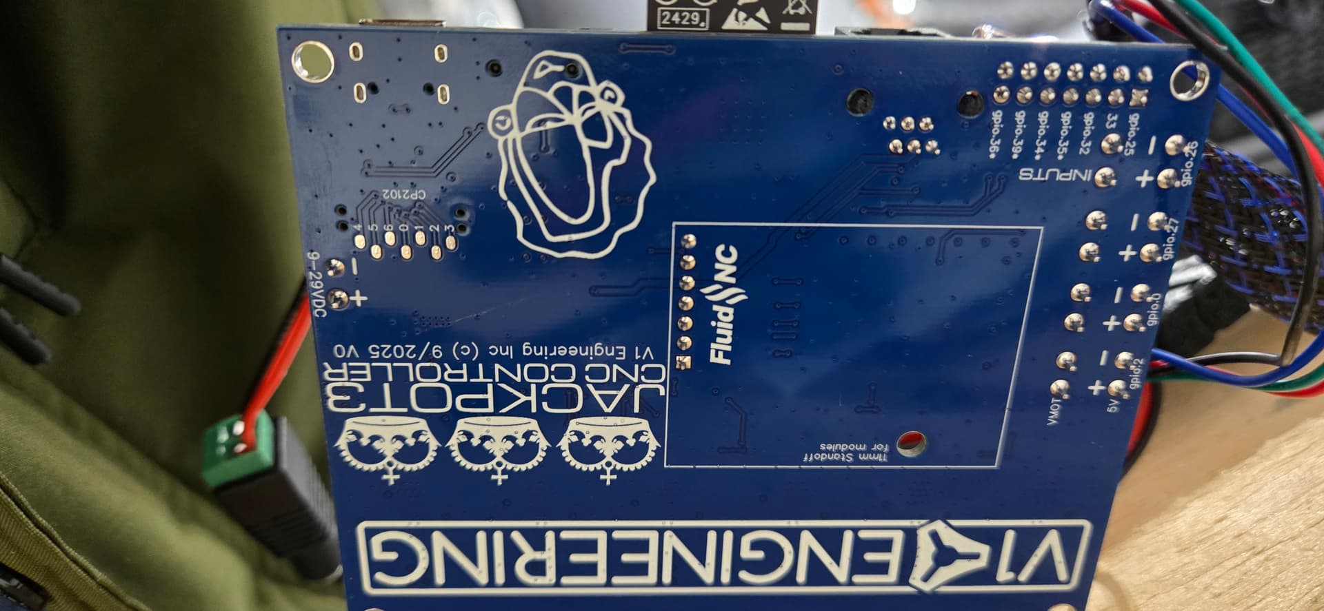

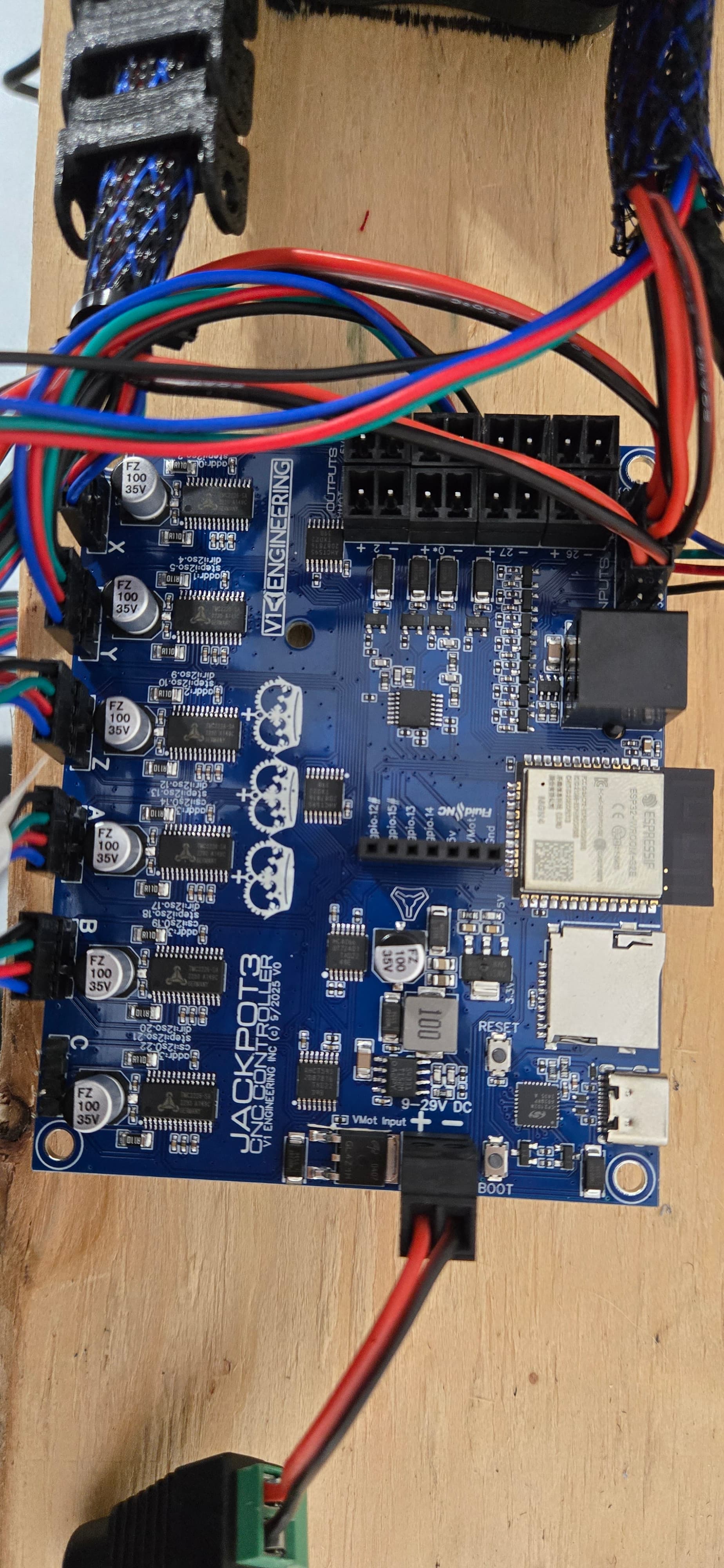

Do you Have hig-resolution pictures of the as-wired Jackpot? That’s a very unusual failure mode.

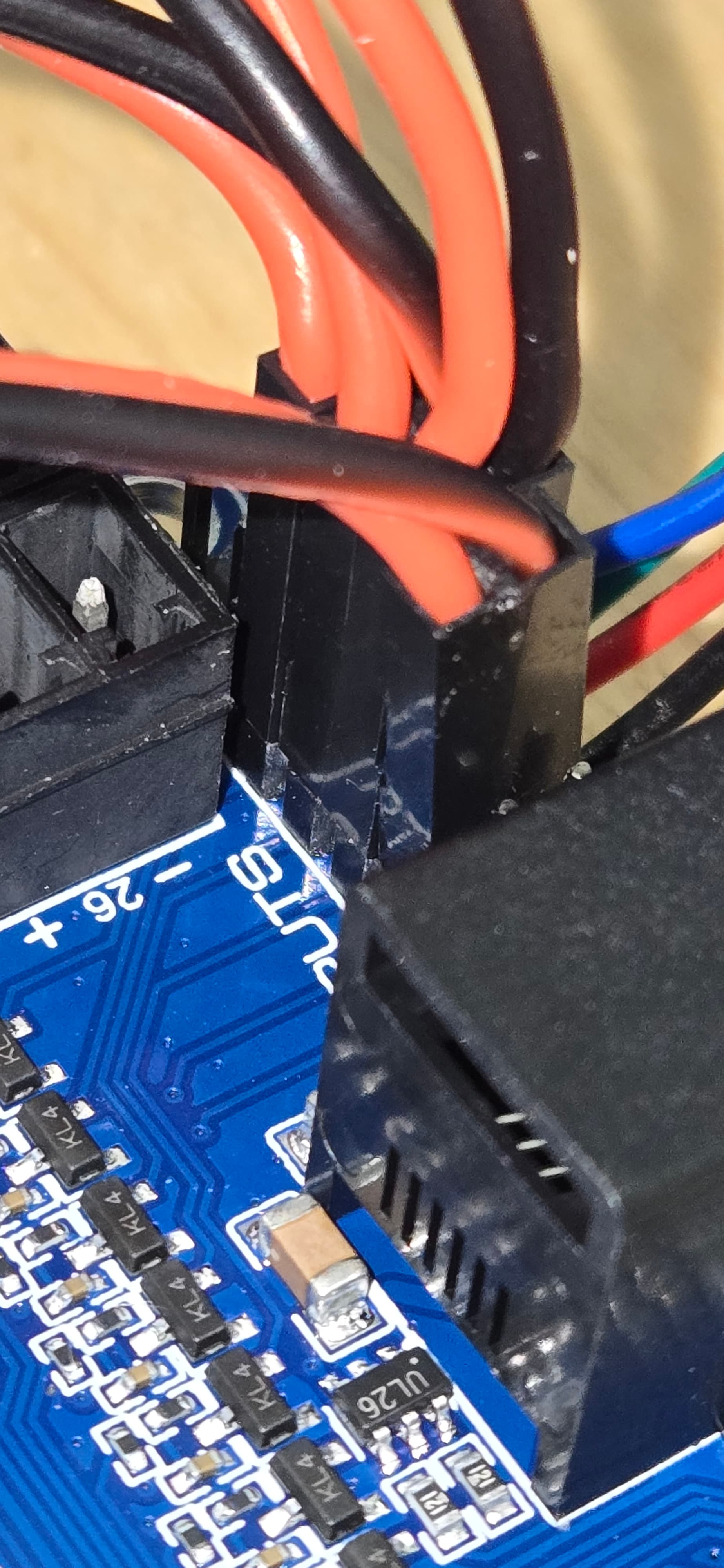

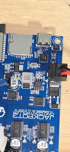

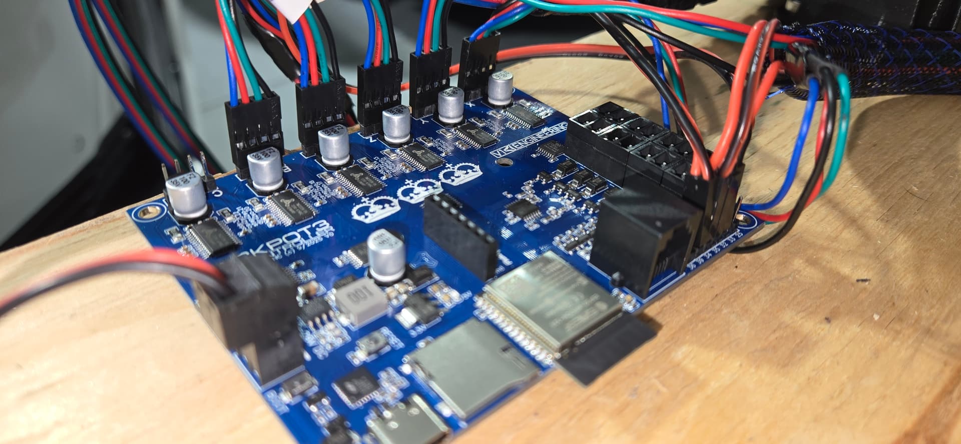

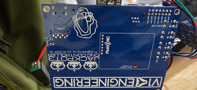

We need to see clear well lit pictures of the top and bottom of the board please. If you have one with it still wired up that would be good to see.
Here are photos of how it was set up when the issue occurred. I tried to follow the wiring instructions carefully, but I wasn’t able to get terminals A and B to work with any of the combinations I tried. That is, I was only able to see one x motor and one y motor working before the board went out

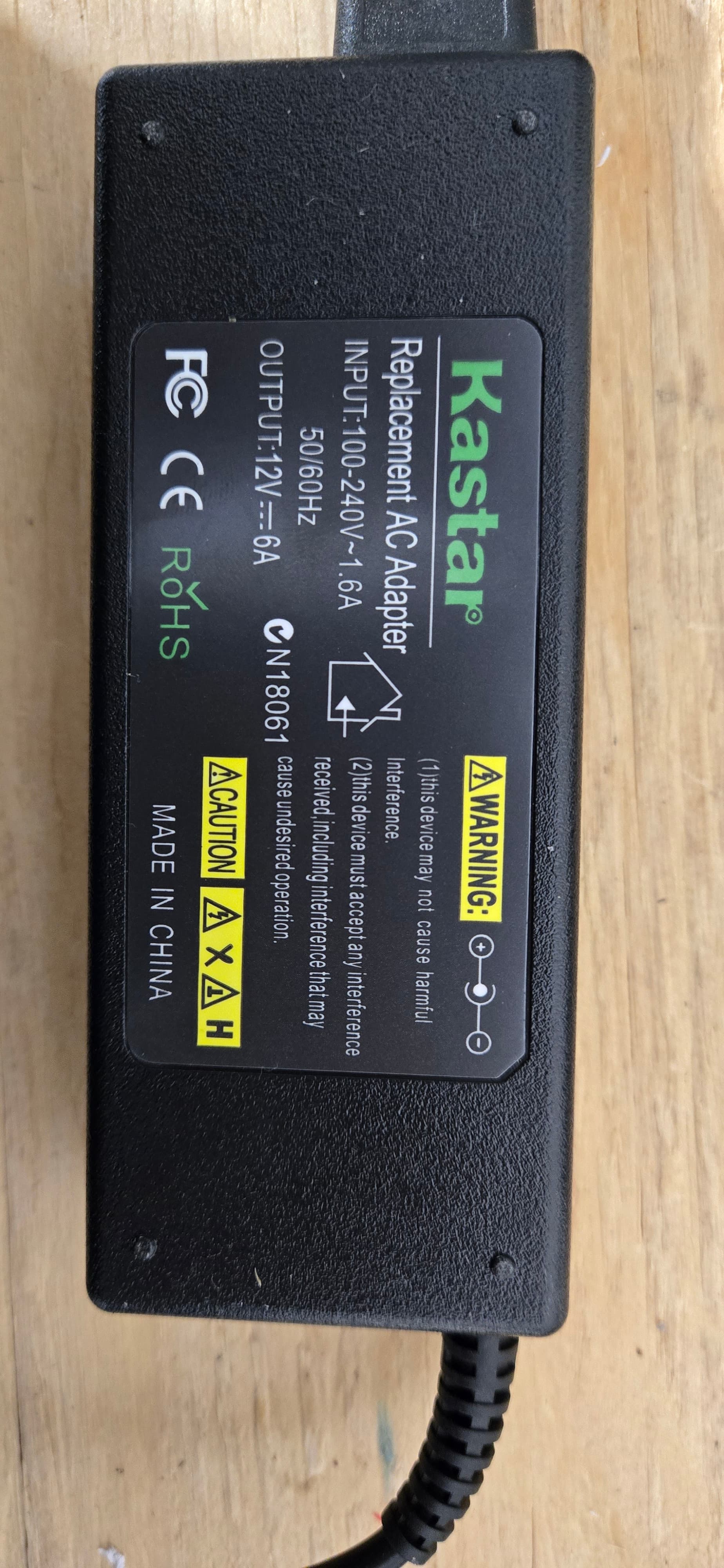

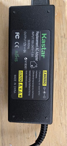

What power supply are you using?

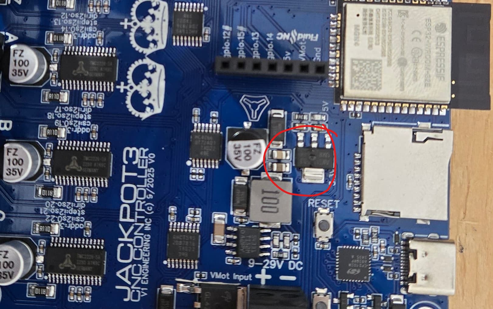

That is a popped 3.3v regulator.
Unsure how that could happen after my full power testing. You will need to send it in for a repair and testing.

This is the PSU, from the MPCNC components amazon link
