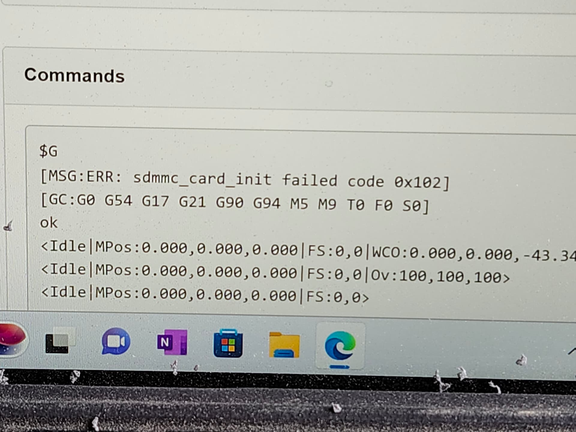

I cleaned up the wiring routed then through the bottom and still doing reboots. I got these errors on a couple reboots.

You don’t have a file system or configs in there. That looks just to be a blank fluid install. You need to also upload all the other file, yaml, preferences, macros. There are two sets one for MPCNC and one for a LR.
That was just one of my reboots. I rebooted it again and it came up fine.
