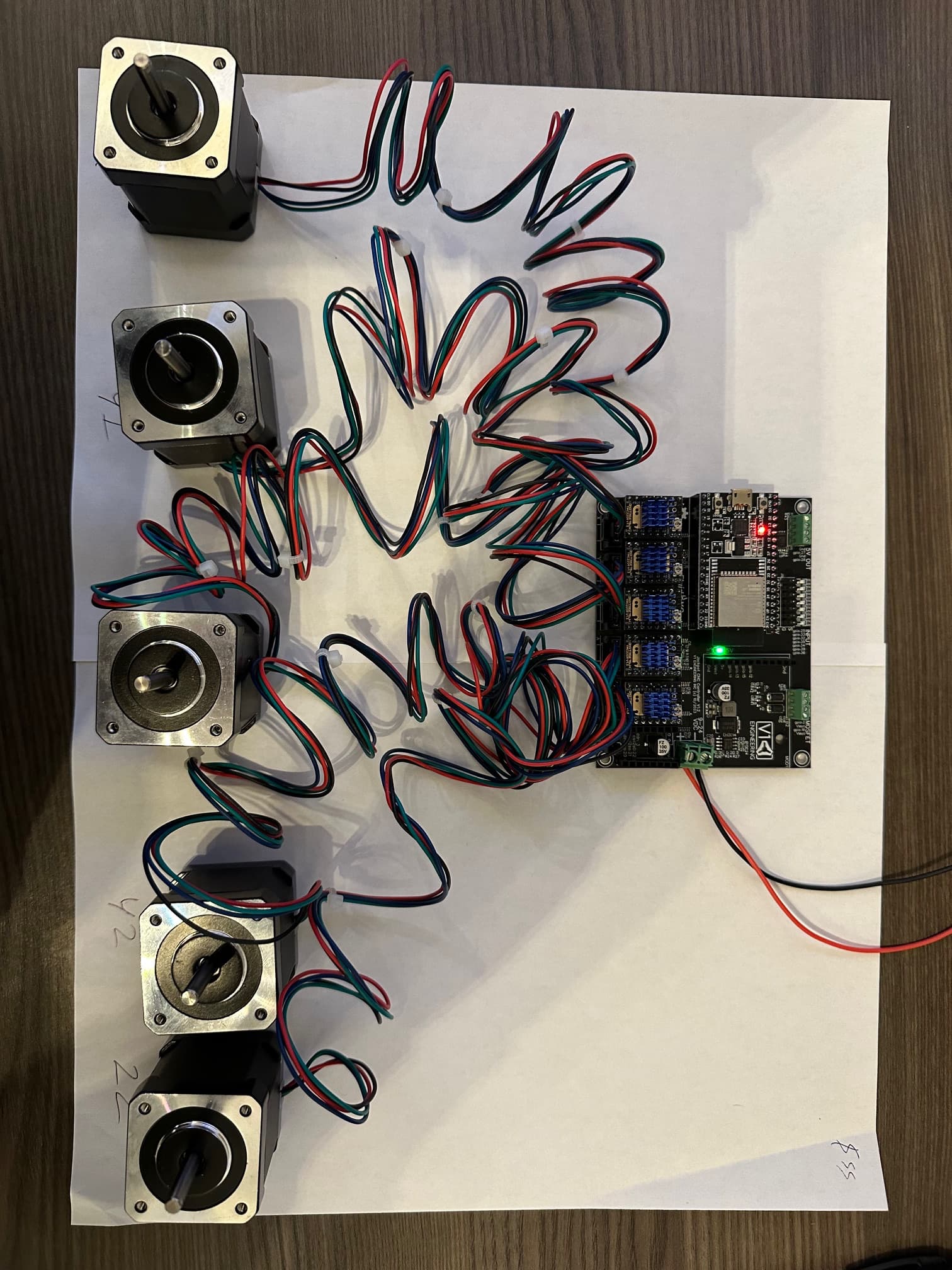

Hi, I just powered up my Jackpot Controller that I received today and I have an issue. The Y1 is not responding to the WEB Ui when I select Y+. Y- works without any issue. The Web Ui shows the the Y+ is incrementing but there is no movement All other axes steppers are responding correctly. I swapped the Stepper to see if the issue was with the stepper but again no Y+ movement. Any help will be appreciated.
Can you post a picture of your board as you have it wired now?
And it is best to post what your terminal shows when you run a $ss command.

Does it work fine now? The $ss looks perfect.
No unfortunately same issue.
Are your endstop wired correctly? If they are NO instead of NC you will only be able to go negative.
My bad you do not have endstops plugged in.
X and Z work fine?
I don’t have the endstops connected yet. I just wanted to check the steppers were Ok.
POwer down and swap your X driver for the Y driver. see if that changes anything.
You have a LR config so you should have two Y steppers moving. Do they both move or just one?
Both move in Y- but only Y2 moves in Y+
I swapped X1 and Y1 and the issue remains on Y1 not moving in Y+. It move in the Y- direction only.
X1,X2 and Z work fine in both the + and - directions.
Y2 also works in both directions.
Its only Y1 which does not rotate in the + direction but works in the - direction.
Sorry my mistake in last post X only has one stepper which works in both directions and Z has 2 steppers which work in both directions.
That is wild… If the direction pin was bad it either would not turn or always turn in the same direction I would assume.
