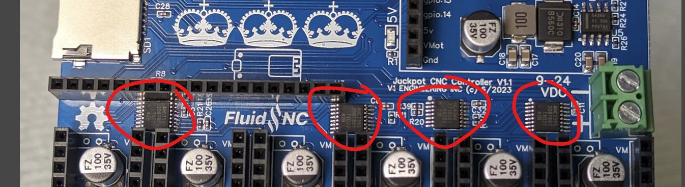

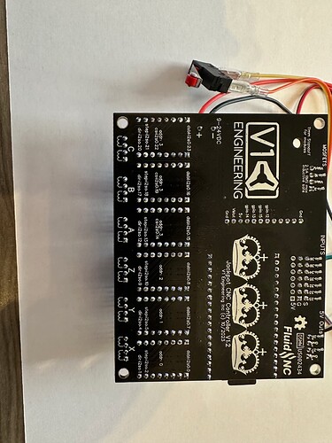

Before we send it back do you want to try and pry off the header of the bad driver jackpot socket and see if the pins are funky?
They are kind of hard to get moving but once you do it comes on and off. I am wondering if that pins is just not making contact. I had one last week that did not enable, the pin missed the header socket.
No obvious solder blobs or anything on the bottom?
Pins all look good and the soldering looks good as well. Its nearly Midnight here so I will have to stop for the night. If you think of anything overnight let me know. It will be a real pain if i need to send this back from Scotland.
Oh crap
We can swap Y1 to the C port no problem. If you ever need a 6th driver we can deal with it then.
Solder blobs on the 4 little chips above the drivers is the only other thing I can think of.
I don’t have an issue using the C port if it can be re-configured. Not sure where I am looking for the solder blobs you mentioned.
We can set you up to reflash it as well, just in case.
The blob would be on these

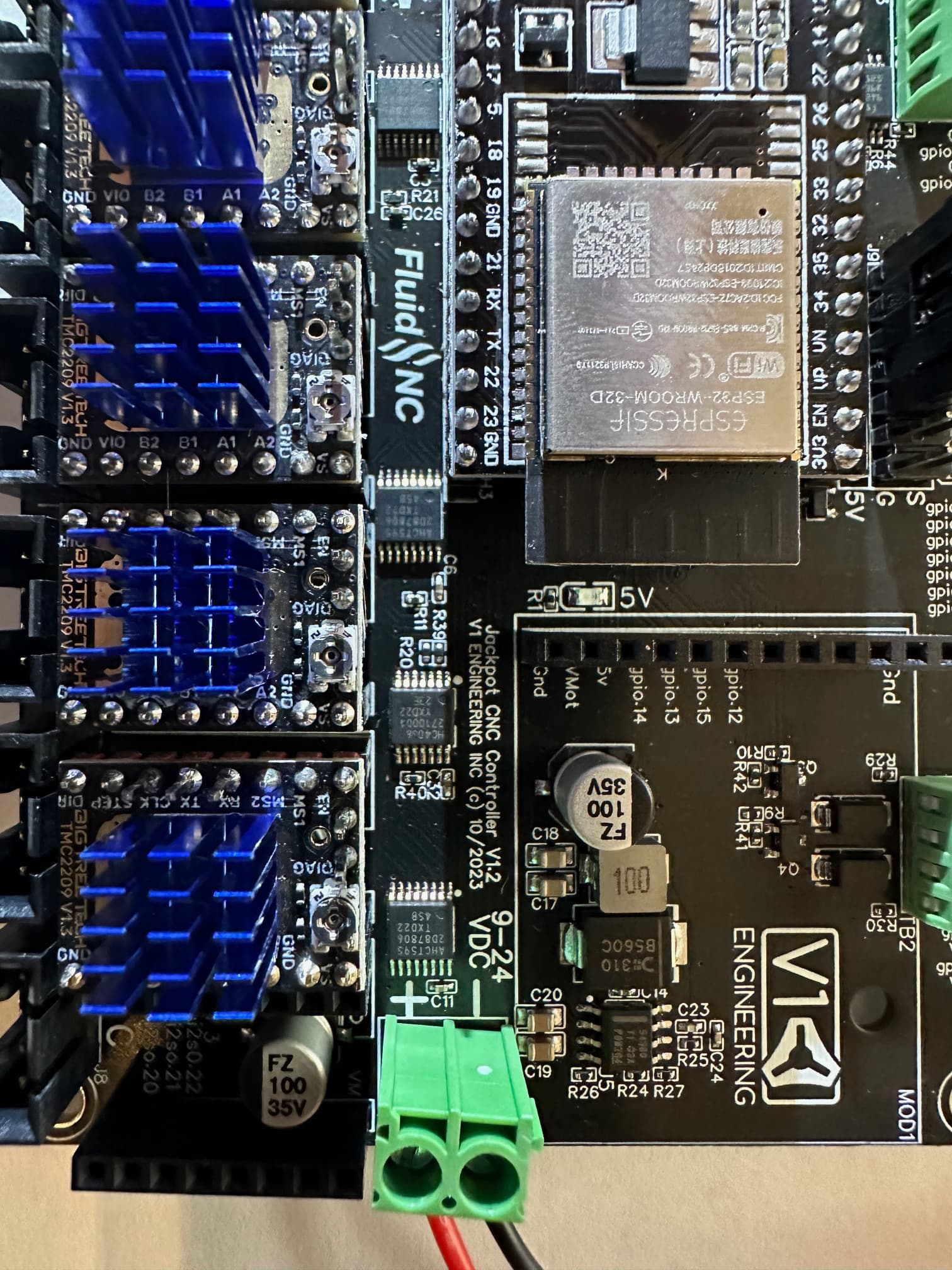

One last note - I’d still like to see close up pictures of the ICs that Ryan identified above, and also of the solder work on the Y stepper driver headers on the back side of the board.

I would appreciate any feedback on the photographs requested. I can’t see anything but I’m new to this.
