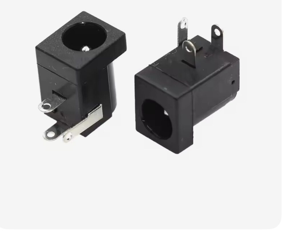

Is something like a pcb mounted 5.5 x 2.1mm barrel connector worth considering? It would be the common connector on 12v and 24v PSUs
Yeah, not very universal, though.
Sizes and polarity vary as well.
I think that’s just asking for someone to inadvertently connect their 5v device to 24v.
I like this idea. I did something like this on my MPCNC with a panel mount jack on the box. You could include something like this to make it universal.

Barrel jacks are fucking awful. Easy to make fail under vibration, zero retention etc. I would very much not want one on a serious machine. I would very, very much not want to use a screw terminal to barrel jack, I’d de-solder it and add a 3.81mm pitch screw terminal that’s the same size pretty much immediately.
