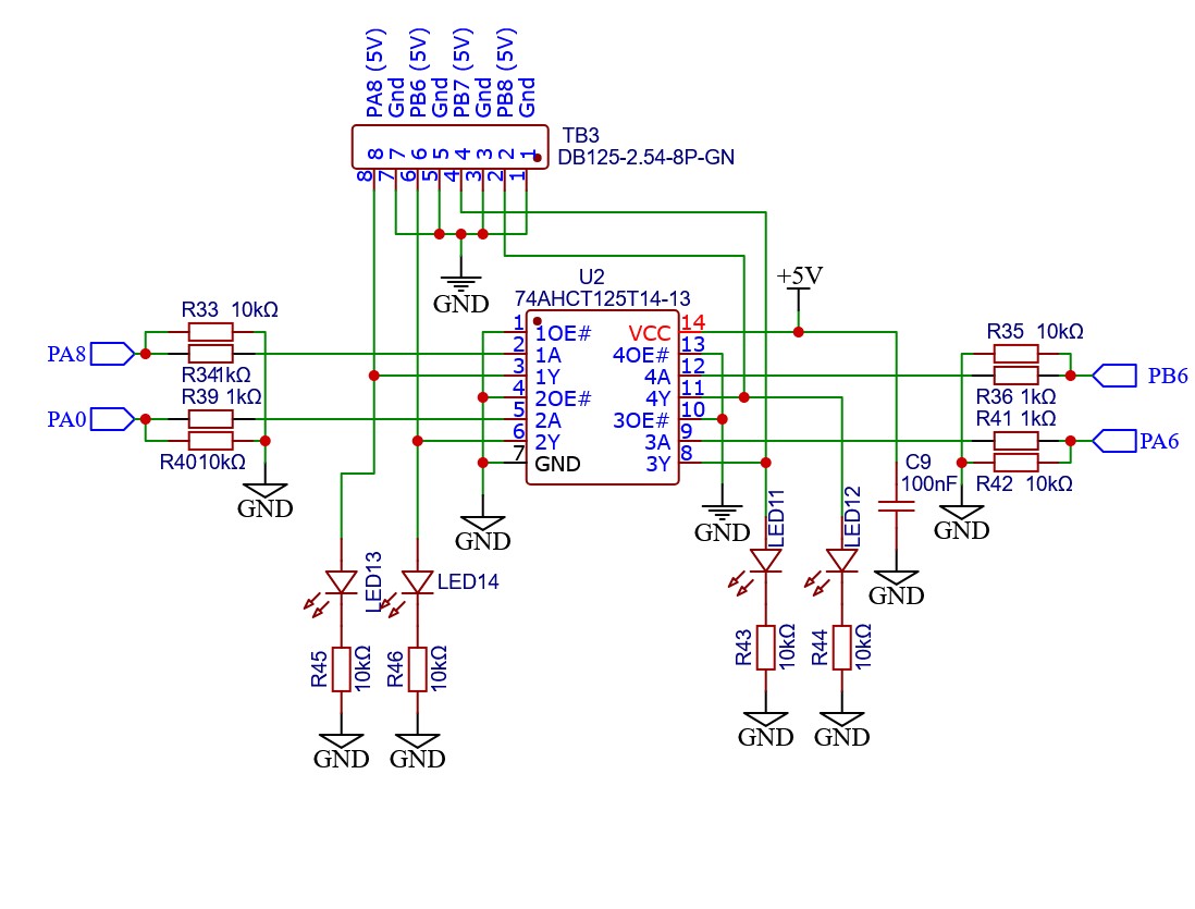

That buffer from the jp1 has 4 outputs, I have no issues reusing that and adding gpio.0 as long as that does not mess with the boot/flash stuff again.
This would be 5v pwm/ttl If I am not mistaken, same as the jp1 5v outputs.
5v PWM to a higher level FET so we can get a higher amperage higher voltage PWM.
Breaking this in two parts to get one clean signal to the appropriate FET, instead of trying to get two FET’s to work with a 2.7v or a 17v signal. We know we will have a 5v signal and a 12-24v output.

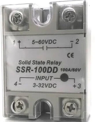

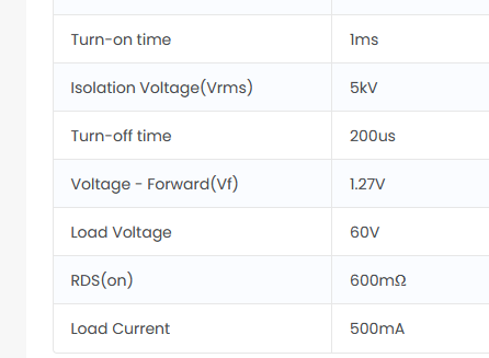

3-32v in, 5-60v out. Maybe they are not fast? I will look for a spec sheet for a surface mount version, I know I looked at them before.

So that would work equivalently to what you’ve got, but is still only a single contact output and likely a very high capacitance one. You’d need a pull-up or pull-down to make a logic signal out of it and would inherently always have a slow edge.
I cannot imagine they’re super fast and may also have significant skew between rising and falling edges, so a turn-on may be delayed compared to a turn-off or vice versa.
There’s nothing in that module that would be much different at all to your existing setup… Edit: Aside from isolation, which can actually be a decent way to get high side drive, but you’ve got other options that are likely better there, anyway.
yup, too slow.

So the buffer from the arendale cost 30% less than the one from the JP1.
I am seeing a pulldown and current protection on the esp32 pins. That makes me nervous for GPIO.0. Can we leave it without a pulldown so it boots and flashes right, then specify :pd in the firmware for that output pin. I am guessing that makes this a flaky output but if it is used for non-critical things who cares if it blips on for a bit, (like pin 26 already does).
The esp32 gpio.0 boots high, low signals flash mode (it is tied to the boot button that pulls it down when pressed).

all fine as long as you use a high input impedance driver or buffer that won’t impact boot behavior. declare what the output can and can’t do as described above
Done, io, 0 and 6 are for dumb stuff.
I guess I model it up, when the testers get here if :pd does not stabilize it, I just remove it. No harm in trying.

That’s a big ‘maybe’, but I very much don’t like doing that. Leaving inputs undriven can cause some wacky behaviour. I would sooner pull the pin in a direction that it needs, such as a pull-up, and then include a warning that this maybe glitch high briefly on startup so it should be used for low-stakes control like lighting or a fan, definitely not spindle control etc.
Another approach is that you can control the output enable line so that on boot the outputs are disabled, then it doesn’t matter as much that the inputs are floating. It’s still not ideal but it’s better. That would need something like pull-downs on the output as well.
They also don’t have anything between the logic output and the header which is something I dislike. Bare minimum there should be a resistor there, ideally resistor capacitor, even more ideally resistor, capacitor, ESD/surge protection etc. etc.
Edit: To clarify, leaving a logic input in an undefined state can cause worse things than just an undefined output, it can lead to it oscillating and max output frequency or drawing significant current. For a brief period on startup it’ll likely be fine, but it’s definitely not ideal.
At the very least I would consider trying to find out how much pull-down you can get away with. It may be that the ESP32 is ok with a 1Meg pulldown on that pin or something, which would still be a lot better than nothing given that the input leakage spec on the 125 buffer is 1uA, so 1MR should be enough to keep it defined to 0.8V or below in most cases.
