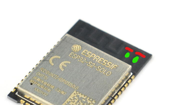

Can the external not be soldered onto the two pins coming out of the PCB antenna and the rest of the antenna trace be cut? It is a pretty large set of pads.
