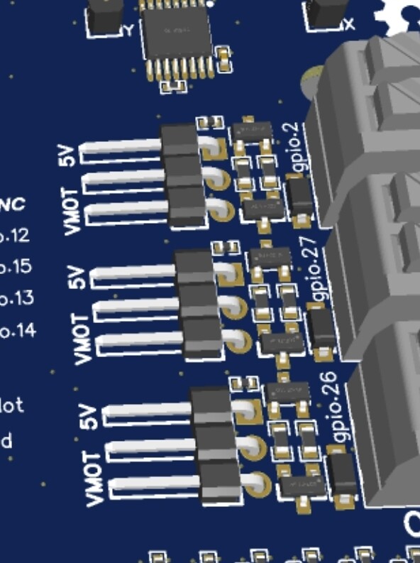

Is there enough room for those to be right angle pins? It looks like the module pins are in the way.
And where’d gpio 16 go?
There is a lot of room.
We lost an output to the gpio.0 pin. But since I don’t think many if any used all 4 we now have three more useful selectable outputs.

Can you leave an SMT pad near the diag pin on the socket?
I could, but it is a pretty tight spot, right in the mix of all the driver stuff. It anything It would be a via to the bottom but that seems less useful.
That would work fine.

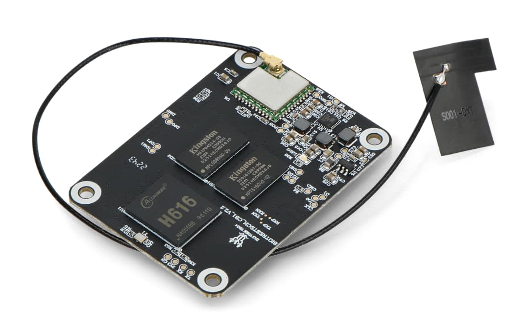

To bring up the elephant on the board: I think this should have an embedded ESP-32 with the PCB antenna, with the antenna hanging out from the outline of the jackpot PCB.
I think as shown with the external antenna, it will be an unmitigated disaster. Too fiddly and prone to user errors and problems.
The current jackpot puts the antenna in the center of the board, with the jackpot pcb just under the socketed module. That isn’t ideal either, but is because the usb connector on the ESP-32 needs to face the outside of the board.
Going to an integrated ESP-32, why not try to use it as it was intended with the antenna protruding just beyond the rest of the board?
Also, just to say it- you’re begging for regulatory attention if you package antennas and esp-32 separately.
I’m struggling to see how that’s likely to be the case? Those connectors are small but they snap on in quite a positive way and then they have good retention. The main issues are usually trying to unsnap them…
This would be bettter but it’s still remarkable how much more garbage the chip antenna is vs even a basic external whip. At my place that’s the difference between -88dBm and high packet loss to -60dBm and 100% reliability for one module. I don’t know that it’s ‘that’ important when you can run an AP nearby, but then the whole station-only approach seems mildly distasteful to me anyway so I’m probably in quite a different boat.

As for the antenna, the little external bowtie these would come with is an improvement overall vs the stock PCB antenna, but isn’t nearly as good as you say- getting even a little stubby monopole to mount on the outside of the enclosure.
I’m not super convinced the bowtie that much better than just moving the ESP-32 to the edge of the PCB and giving the stock antenna good line of sight to the outside world.

When I built my MP3DP v5, the Manta board with CB1 came with a crappy external antenna like this
I upgraded mine to one of these
and it made a massive difference in the connection strength that I had to my home network.
