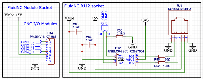

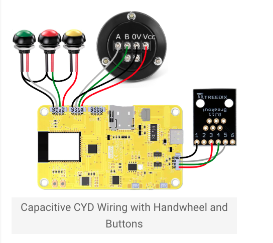

How do you have the cyd pendant wired for the JP2? There are only 6 wires for the cyd. The JP2 uses gpio.12 and gpio.15 which are in location 6 and 7.
yup, 12 and 15, gnd and 5v
I meant what is the order of the pins?

If I plug in my RJ11 breakout into the JP2
pins 4 and 5 will be on gpio.13 and gpio.14. Not gpio.12 and gpio.15.
I’m not sure how to get the RJ11 to work on the JP2.
There is a built in RJ12 jack on the JP2. You wont need Barts add on board like you do on the JP1.
gpio 13 & 14 will still be on the expansion slot like it is for the JP1
Ok, thanks @Jonathjon .
I was thinking that all 7 from the expansion slot would be in the RJ12 also, and it had to be configured for 5v vs vmot and gpio 13,14 vs gpio 12,15 somehow.
Here’s the latest I have for the Jackpot V2 schematic. I believe this is current and correct for the J2 boards that are in the shop.
NOTE: There may have been a pulldown or pullup resistor added as a manual rework that is not reflected yet in the schematic! (It’s already in there- R56). Ryan is on top of it.
As you can see, both VMOT and 5V are present and available just as they are on Bart’s expansion module.
If you are building a CYD, you must only wire 5V to the system.
If your are building an M5 stack, then you can use either (I would prefer VMOT for that application).
Thank you @MakerJim
Now it makes a lot more sense to me. I can unplug my cyd from my LR4 or MPCNC and plug it into the JP2 RJ11 jack.

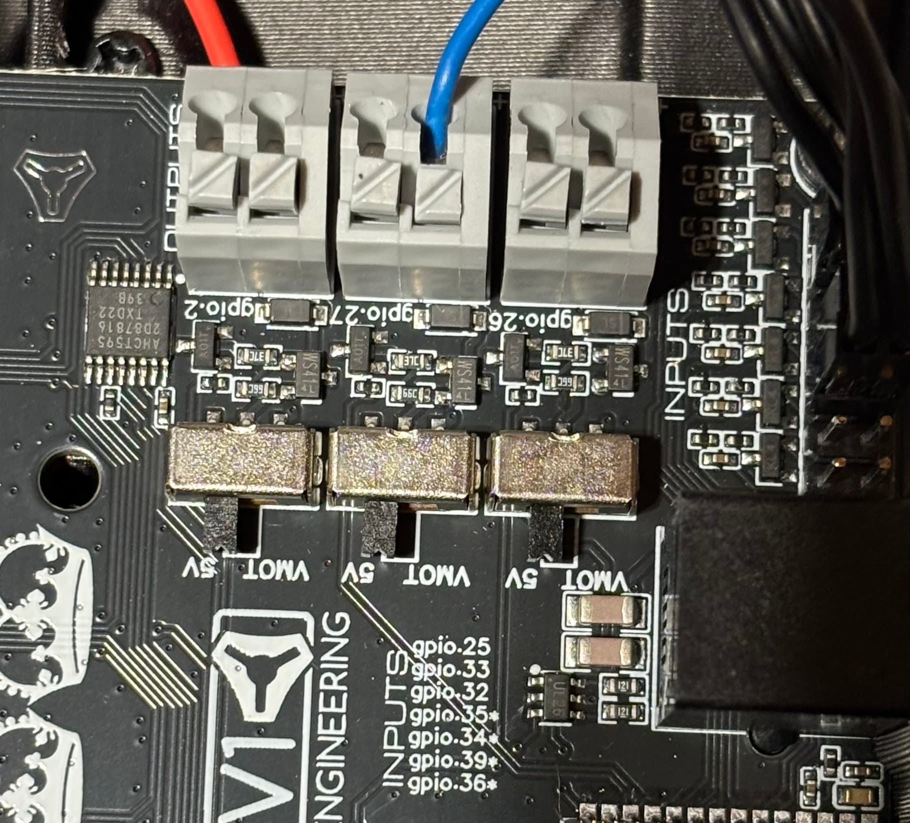

I swapped out the JP1 for the JP2 on the MPCNC with a laser. I connected Lightburn and opened a project that I’ve used several times. I framed the project just fine. Then I ran the project and noticed it was a LOT darker than before. I stopped it and changed the percent from 33% to 18%. Then I reran it and the engrave was just like the first try. It appears that the laser is always at 100% regardless of my settings in Lightburn. I changed the little toggle switch to 5V before I connected the pwn wire to the laser.
Any ideas on what I can try to get it to send the correct signal to my laser?
Laser:
  pwm_hz: 5000
  output_pin: gpio.27
  enable_pin: NO_PIN
  disable_with_s0: false
  s0_with_disable: true
  tool_num: 0
  speed_map: 0=0.000% 1000=100.000%
  off_on_alarm: true
It is set as a digital pin, I think you have to set it to analog pin? That is a quick guess. I am looking into it.
