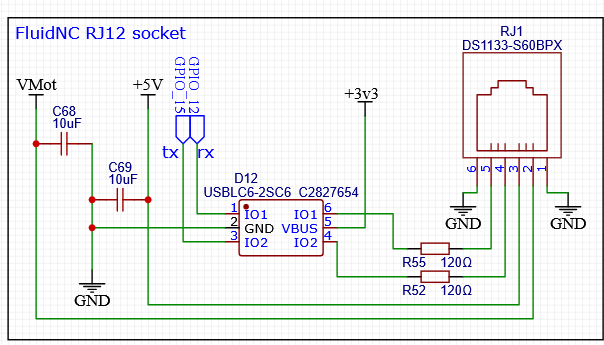

Houston we have a problem. The new boards are here but the pendant is causing issues.
I can make the pendant work just fine, all that is functioning as it should. So I have to assume the wiring and firmware side are as they should be.
The jackpot does not like to boot right with the pendant plugged in. Matter of fact it draws nearly twice the current that way and does not seem to fully boot.
If I boot and then plug in the pendant it works fine, shows no significant current increase maybe just 0.01-0.02A extra if the meter is even that accurate.
The other issue is if I leave that plugged in the 5V 3.3v PS section on the jackpot starts to get real hot.
So maybe that protection chip is going around the isolation diodes or something?? USBLC6-2SC6 | Datasheet | TECH PUBLIC | LCSC Electronics
Vmot is not being used, nothing soldered to the pendant end.
The voltage on the lines seems fine, 5V is steady (probably need to put the scope on it.)
gpio12 and 15 have 3.2 and 3.1v on them (odd that it is not 3.3?? or is that becuase they are data)
So the pendant has Fluidnc, correct. I wonder if it seeing that is causing the boot problems. Is there a way to turn the comm to pendant on at the end of boot???
It has fluidDial on it, but It should boot just fine with it plugged in. I assume the host esp32 boots before it enables the uarts by a smidge.,
In Discord, they are mentioning needing capacitors, but that is too far from this network engineers background!
Wait it appears that I do not know discord either. It took me out of the pendant section. There is talk of capacitors for boot problems though :slight_smile:
yeah boot caps are normal…and touchy that is why I moved one of our outputs.
I guess I can pull off the protection chip and straight wire it and see if that corrects the issue. To at least narrow this down. I will try that first thing in the morning.
