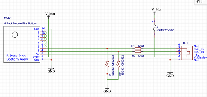

More notes:
The pendant expansion module by itself is available on elecrow for $8.
Mitch used a pair of SD03C_C502532 (LCSC C502532) plus a pair of 120 ohm series protection resistors. The diodes for ESD, the resistors for current limiting. Schematic below.
This warrants a check in from @jono035 , this isn’t likely the ideal protection for the IO. It does seem to be effective for Mitch and Bart to drastically reduce blown ESP-32s.
Source:
This further cements two options for us:
A user wanting only the pendant can get the $8 module, plug it into the jackpot (v1 or V2) expansion header then use the standared curly RJ2 cable to connect to a pendant.
A user wanting the Airedale could use a cable to tie a Jackpot expansion header (either V1 or V2) over to the Airedale input connector. They also use the curly RJ12 cable from the Airedale to the pendant.
For us, though, the question is do we want to still keep the series current protection and ESD mitigations? Probably.
Note: EDITED. VMOT is available in either scenario, the expansion board adds a fuse for VMOT
What are those going to, just plain GPIO pins? It’s likely fine but I’d guess that the 120R series resistance is doing most of the work there. I’m never a huge fan of using bidirectional TVSs like that, nor of keeping the TVSs on the microcontroller side of any shunt impedance.
ESD strikes can be either polarity so a negative voltage strike relative to 0V will see -4V on the TVS before it starts to conduct, which means the entire burden of that strike is likely in the parasitic diodes or ESD diodes of the ESP32 itself.
It’s not ‘bad’, as such, it just gets a little weird. ESD can and will hurt SMT passives, just usually less so than semiconductors. A big strike could easily take those 120R resistors and increase their impedance by damaging the film.
I also typically think of TVSs on lines like that as a bit of a brute force ‘coarse’ protection. I’d put them directly on the ‘world’ side of the circuit, then put the series impedance, then go to a shunt impedance as some kind of filter for any input line. Given the short-term and relatively low total energy of an ESD strike, a filter actually works marvelously to limit the overall voltage seen by GPIO pins. A TVS will absorb the majority of the energy and ‘clamp’ the impulse in the 7-10V range while the filter then takes that impulse and flattens it out to only a volt or two. That’s not as effective for fast circuits where you can’t filter them as much but it works great for slow GPIO. It’s also less effective for surges than it is for ESD but still.
The ‘gold standard’ for ESD suppression in my opinion is to use a dedicated ESD array that connects to +V, 0V and the lines. It’s way more effective to shunt the ESD strike current to a voltage rail and large capacitor than it is to try dissipate it in a TVS, then a TVS can be used to keep the voltage rail from running away on you. That option is also usually MUCH lower capacitance than an equivalently sized TVS so is more appropriate for digital signals, although that’s more of a USB/Ethernet scale consideration or fast CAN etc. but would still be applicable to a high baud rate UART due to the lack of configurability in terms of when line states are sampled etc.
In the past I’ve used something like a Littelfuse SP3002. They’re a nice part to use because they have 4 IO pins but you can just parallel up any that you’re not using, so they’re a nice layout with 2 lines because you can just route straight through them and potentially not even mess up the impedance of a balanced pair, even. I would always include a good quality decoupling cap right at the VCC/0V terminals, too.
https://www.littelfuse.com/assetdocs/tvs-diode-array-spa-sp3002-datasheet?assetguid=c8b2f2f8-79d8-4a9c-8435-7393b0361abe
Both sides it goes ultimately to an ESP-32. In the Jackpot and in the pendant those are UARTs TX/RX pins. (yes, I find it ironic that the pendant has every bit as much compute power as the jackpot host. Maybe more humorous than ironic. )
I agree if using a TVS it should be on the world side downstream of the series protection resistors.
The littlefuse part is nice. It’s half the cost of the TVS. 53 cents for the littlefuse and 42 cents each for the two TVS.
Anything we think a user might regularly connect or disconnect we should have some kind of protection for.
Maybe the best option on further reflection would be for Ryan to carry or make the expansion board himself and tell either pendant users or Airedale expansion users to always get the expansion board.
I’m also not completely sure that the fuse for Vmot is necessary given that we’re usually using current limited supplies anyway… That appears to be a 200mA Ih polyfuse. At 2A it’ll take ~100ms to trip which is plenty of time to have browned out the supply and reset things anyway.
I really like the idea of including fusing, especially resettable ones, but it’s SO difficult to do in a way that actually protects anything at that scale, I mostly end up not bothering. If I decide I do need current protection then these days I’ll do it with something active because you get other capabilities like the ability to do high-side switching, adjustable current limit vs time and potentially current draw feedback.
