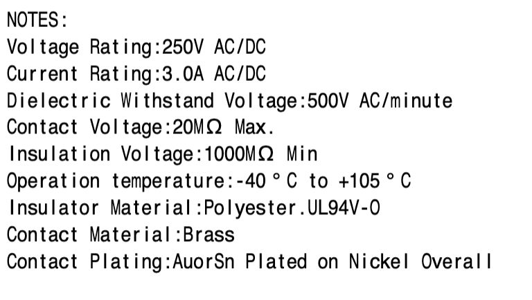

That’s not the case for this connector.
The data sheet is attached below. The header contacts are rated for 3.0 A, 250V. I have similar connectors running hot ends on the TAZ5 printer (In parallel, and at 24V, but still…)

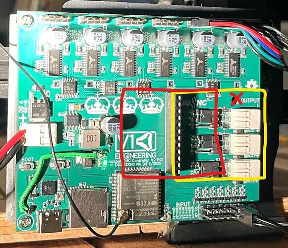

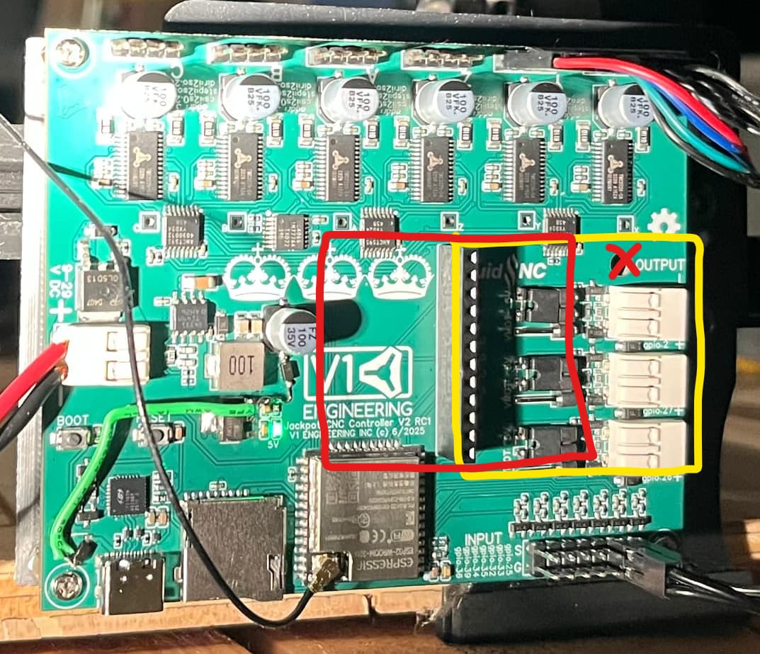

I was looking at the board and need some opinions from you guys that use the module socket.
Jim had a simply amazing realization that I do not need the full sized header for the socket. So now my question is, should I move the socket back from the edge of the board? If it is at the edge of the board you need to cut a hole in the box to fit out whatever connector you are using. If I move it in the wires can be turned inside the box to come out a provided hole.
So move it back or do you want the edge access?
edit…on that same note I might have to move it back. I am not sure how tall the new connectors are…shoot. Glad I made this post.
I have Barts board for the pendant in mine, with a RJ12 cable plugged in and the wire turns to come out of the provided hole on the side of the box. Its tight, but not impossible.
My only thoughts are if we shrink it will ALL of Barts different add on boards still work? or are we limiting people? Also need to make sure that any pins sticking out of his boards that wont be in the socket anymore don’t end up touching things in a bad way :poop:
Yeah all the modules will fit, anything with 4 IO or less. His new socket only has 2 IO so in a way we are more backwards compatible.
Definitely keeping it clear under the other pins.

Header has already shrunk.
I checked the new output blocks are too tall to fit under so I HAVE to move the header and mount hole back a bit. Bummer, but I will do it. I think that also means I should spread out the Stepper drivers a bit, squeeze out every degree of performance I can that adds zero cost to production.
