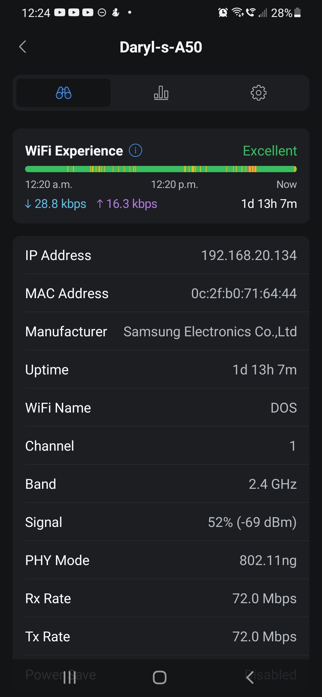

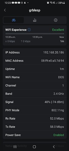

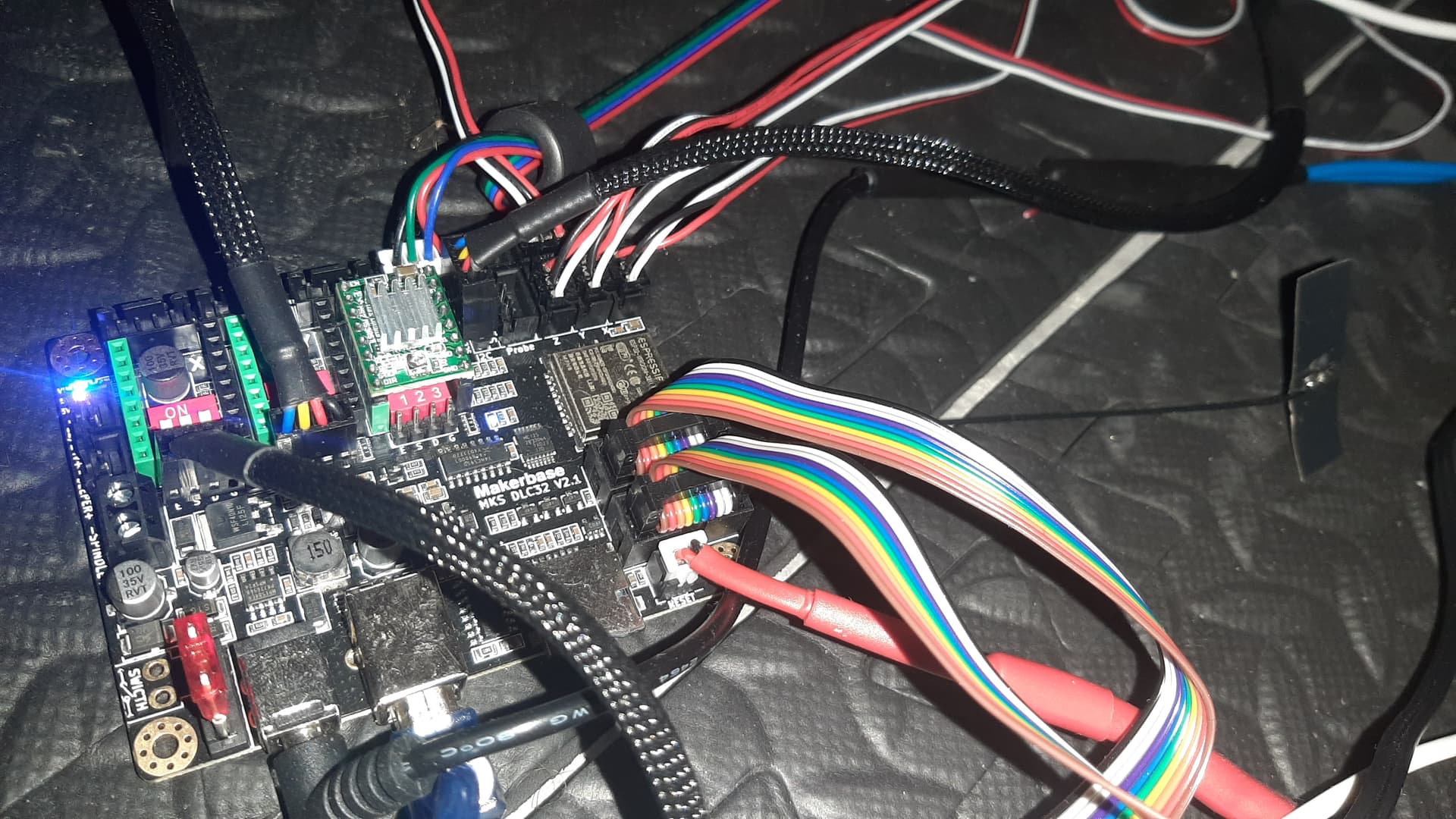

For what it’s worth (probably not much) I get craptastic signal with the external bowtie antenna that came with an MKS DLC32 with an ESP32-WROOM-32U in a totally temporary and not at all permanent setup:

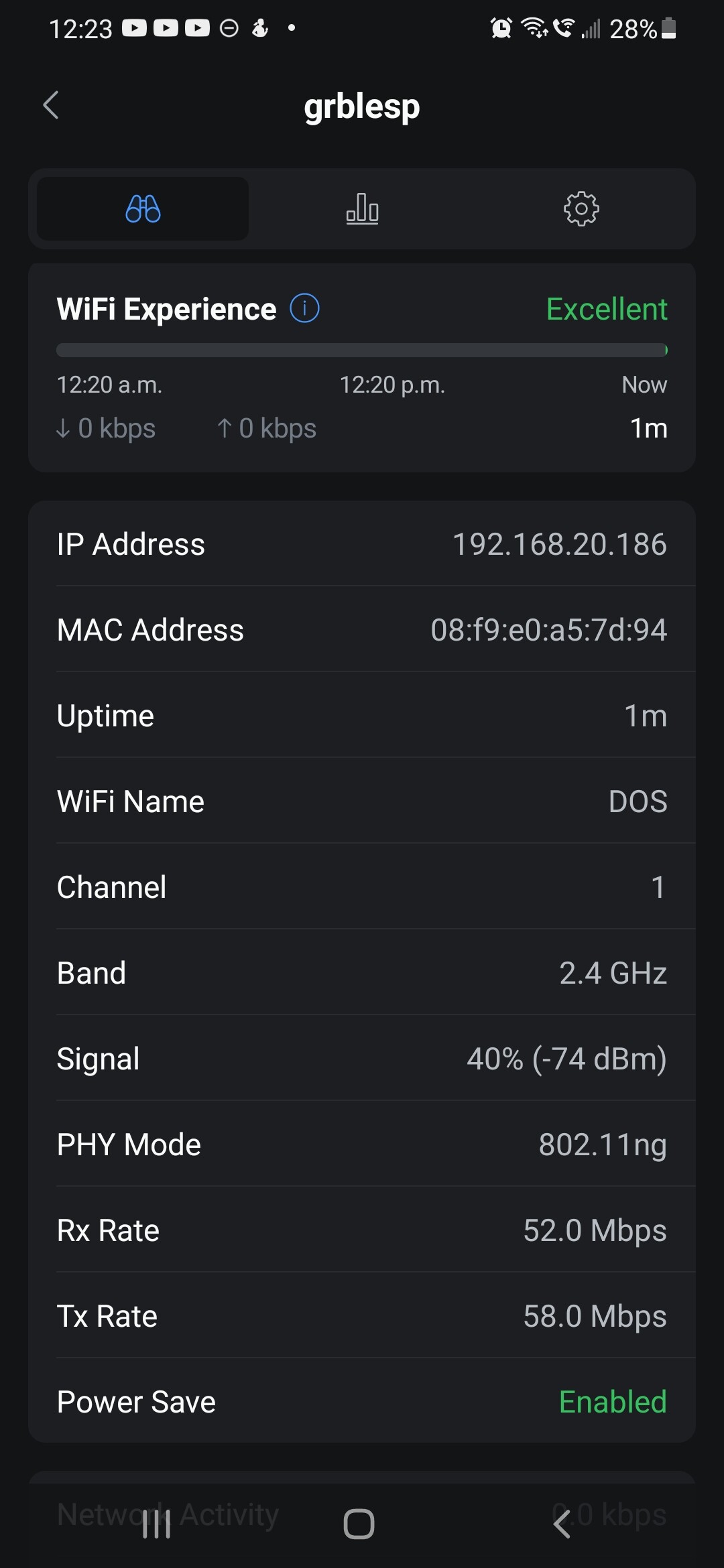

Connected to a Ubiquiti U6 Lite, about 30 feet away, through a wall, some metal storage racks, and the top corner of an HPE server rack:
Compared to my Samsung A50 phone in the same location:

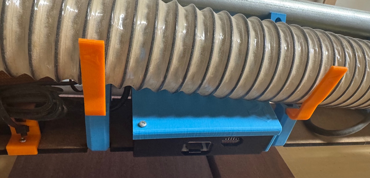

Most of us (I think) have the Jackpot in a case sitting underneath the dust hose like this:
I don’t know how much interference that really causes compared to open air or not…

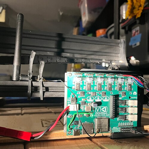

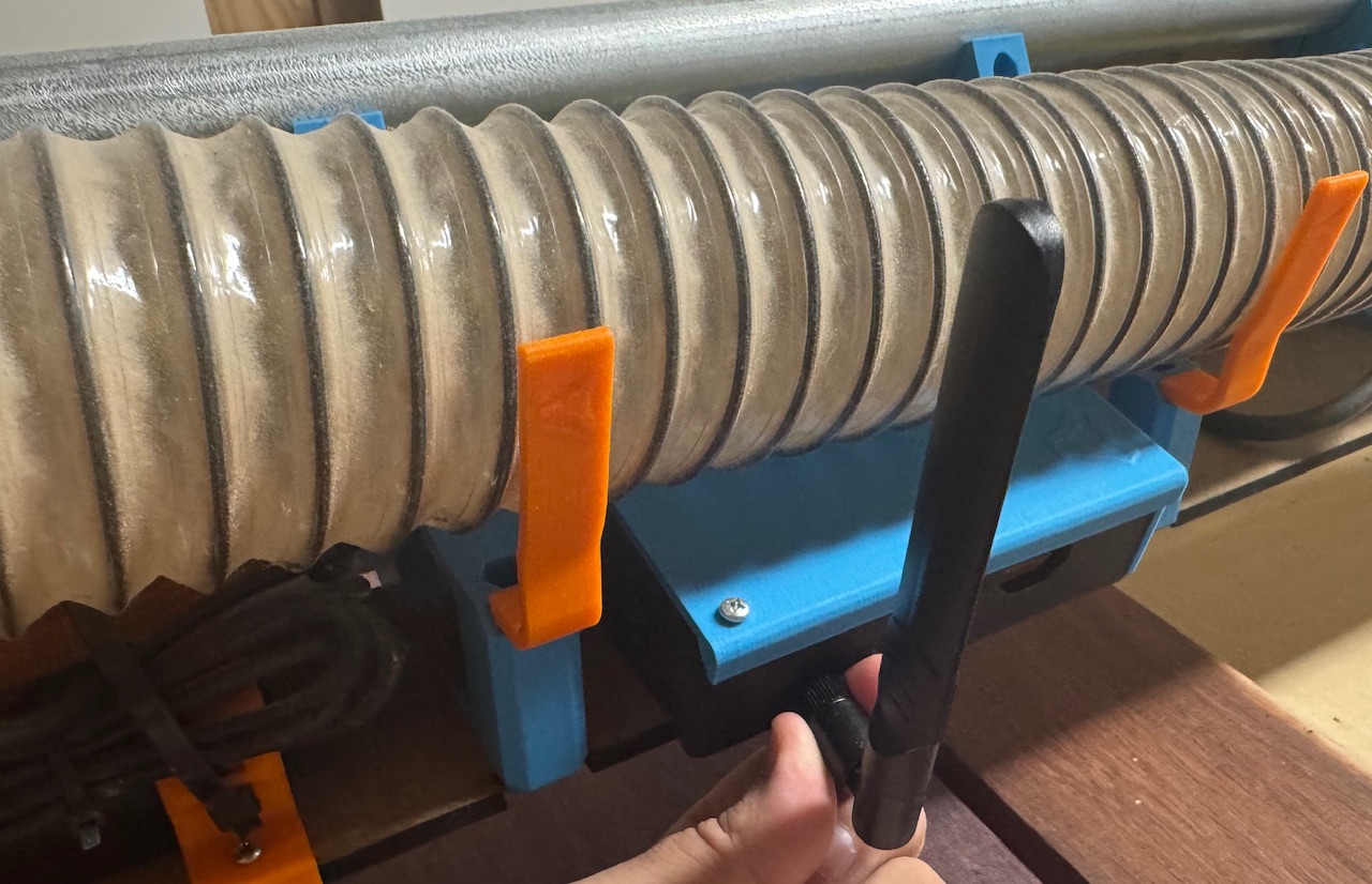

I am interested to see what it would be like with an external antenna coming out the back of the case like this:
Seems like an easy case mod, and the antenna is out of the way of anything hitting it, at least in my case.
I’m about to order some ESP32 DevKits with the external antenna to give it a shot.
I know that doesn’t necessarily mean anything as far as the Jackpot V2 is concerned, but if I get a chance to do this test, I’ll report back.

That antenna configuration is exactly what I was supposing up above when noodling about this.
Get the antenna into clear air with good line of sight to the rest of the environment.
Maybe with some kind of printed captive part so the antenna cant droop around and end up getting stuck on the workpiece.
This model that I have, at least, is not one of those smooth motion ones that tends to get loose over time.
It’s very tight and has some little detents that make it rest in 90/45/0 etc positions, and feels like it’s pretty stiff to get to move from one to the other. As long as the ring doesn’t loosen and have it twist into the workpiece, I think it would be ok.
But something printed to guarantee it would probably be a good idea

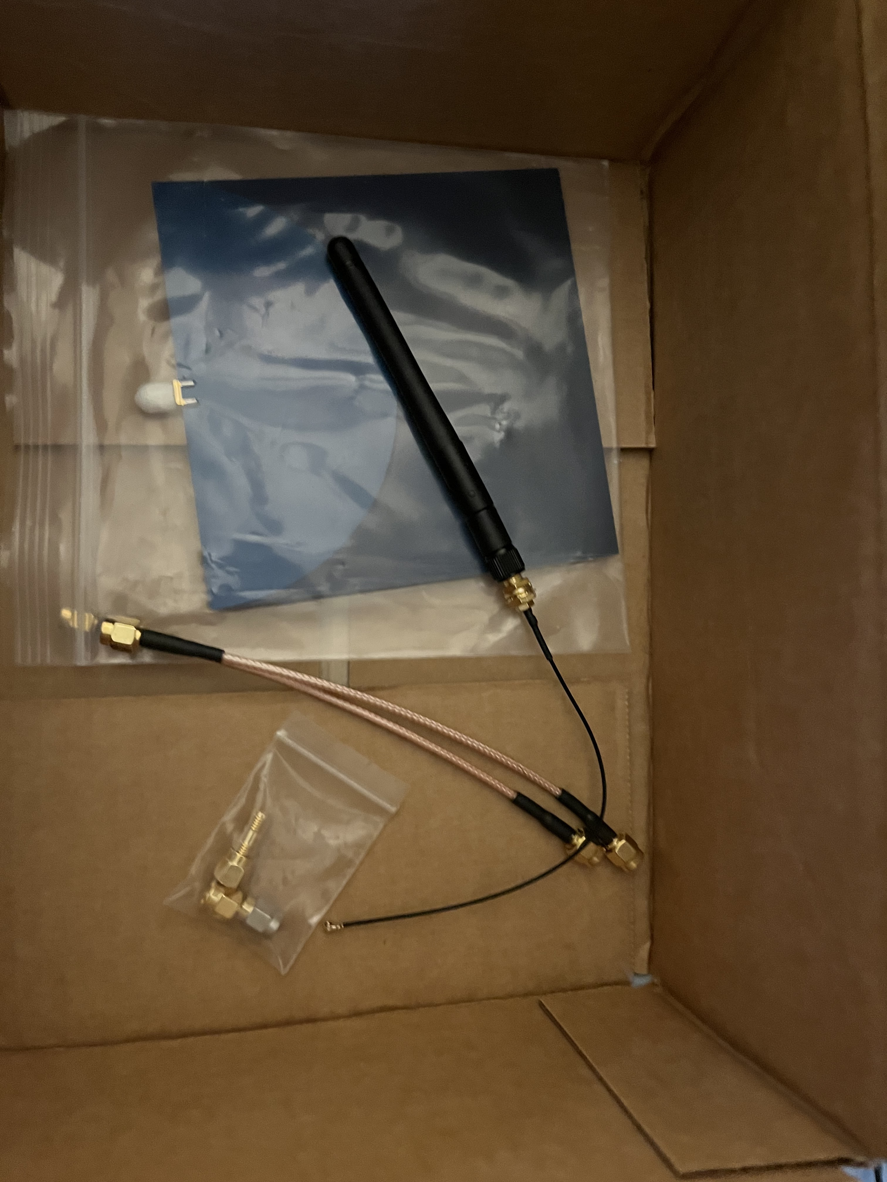

Found the esp-32 antenna in a random box of stuff with some ham gear.
Will do a bit of testing shortly.

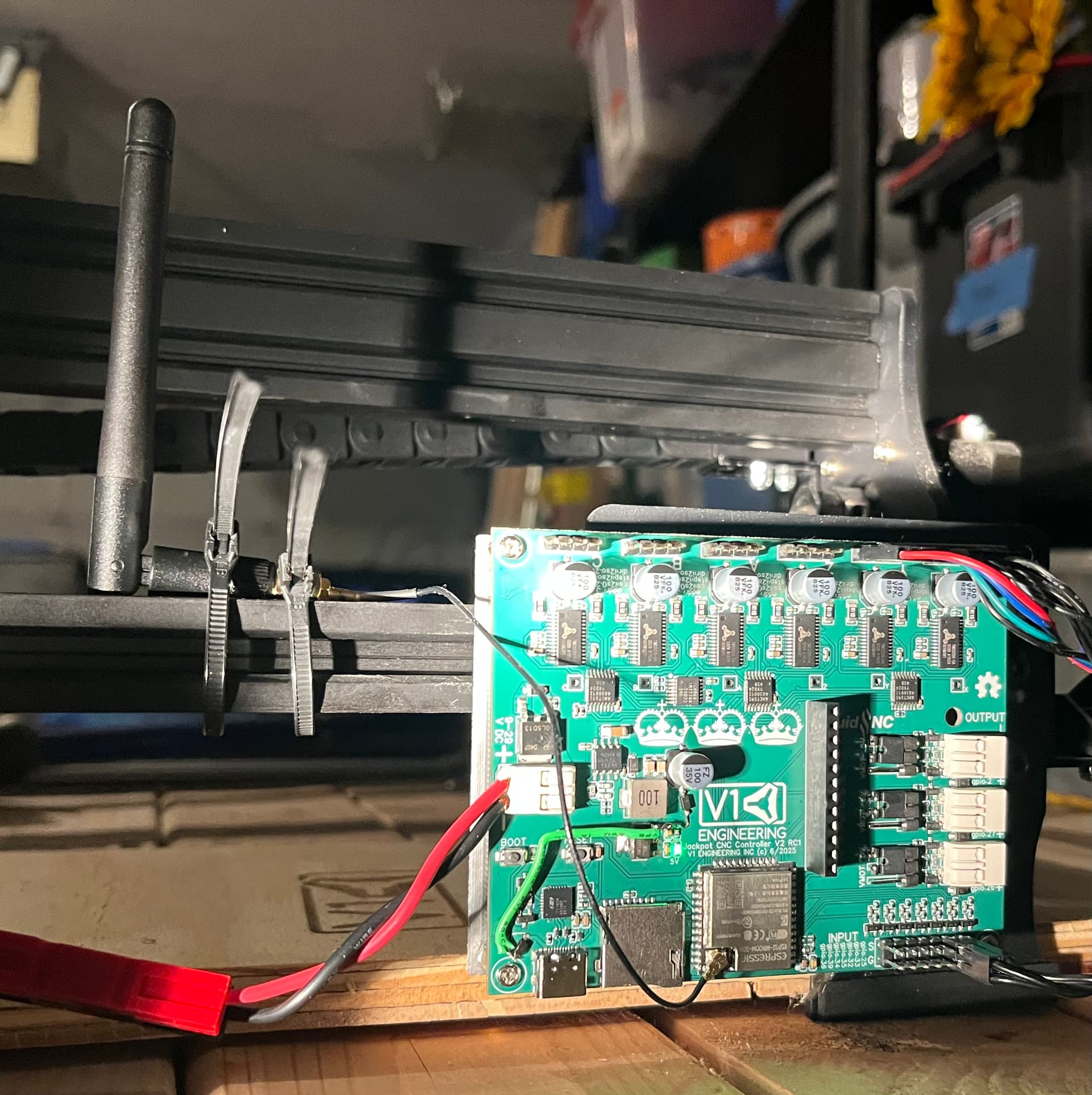

OK did a bit more testing.
Short version- signal strength improved, but isn’t better than the Jackpot V1 with a genuine Espressif ESP-32. It is now good. Quite usable.
Longer story:
Antenna is attached with the “Super cheesy double-zip tie on a 2020 extrusion” mounting method. Not as good as having it sit on a good ground plane, but way better than some of the other quick hack methods at hand.

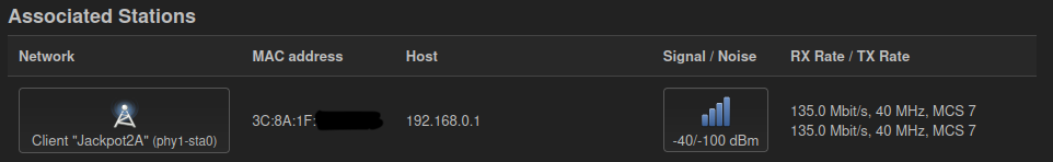

Refresher: With the bowtie antenna, this board was achieving around -44 dBm to my MR8300 client.
The Jackpot V1/Genuine ESP-32 chip antenna was getting around -39 dBm in the exact same setup.
With the alternate antenna, I’m now getting around -40 dBm, so it’s a notable improvement over the bow tie, but not quite as good as the genuine ESP-32. It’s about a 2.5x improvement in power. Quite a substantial improvement. I think this points out the inadequacy of that bow tie antenna.
Also, points out that antenna line of sight is important. (We already knew that :slight_smile: )
Note that I have a great noise floor here at -100 dBm, so this would have no trouble working well for me. (Frankly even the less performant bow tie would work for me in my environment.)
I’ll fiddle more, maybe fab up a ground plane, or will look to see if I have any other SMA anetnna options.
