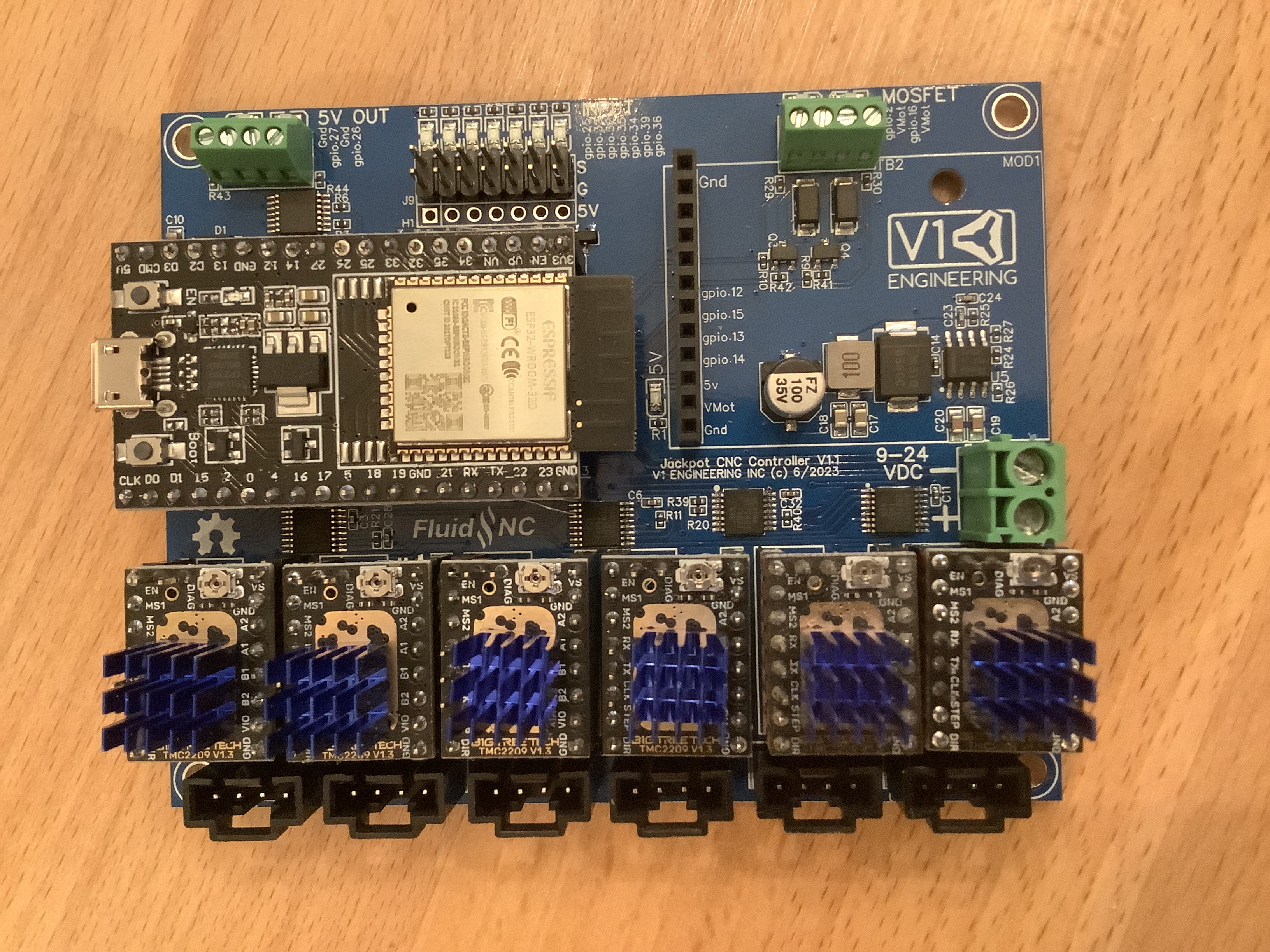

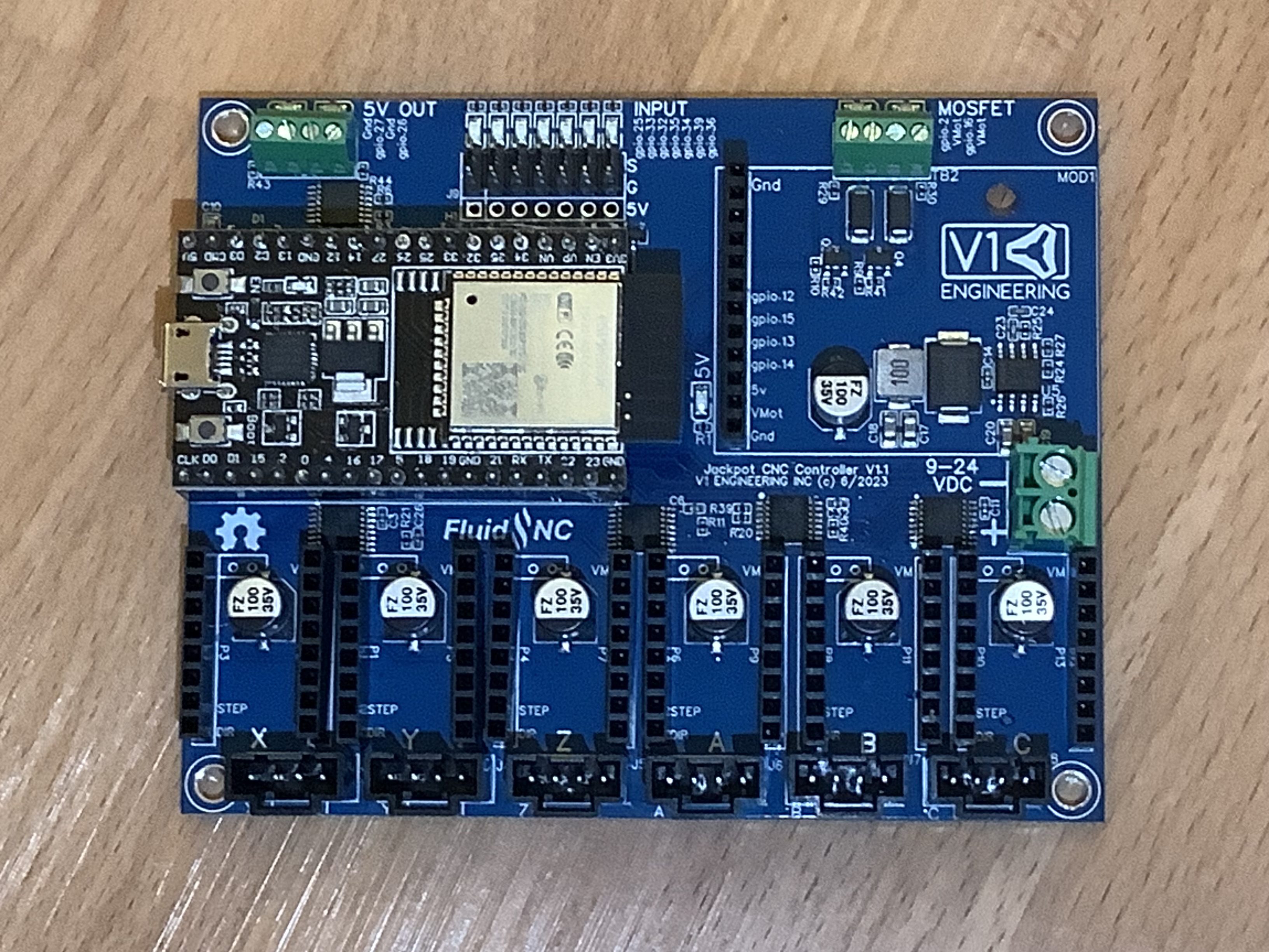

Jackpot unboxed Easy setup except Y2 won’t turn

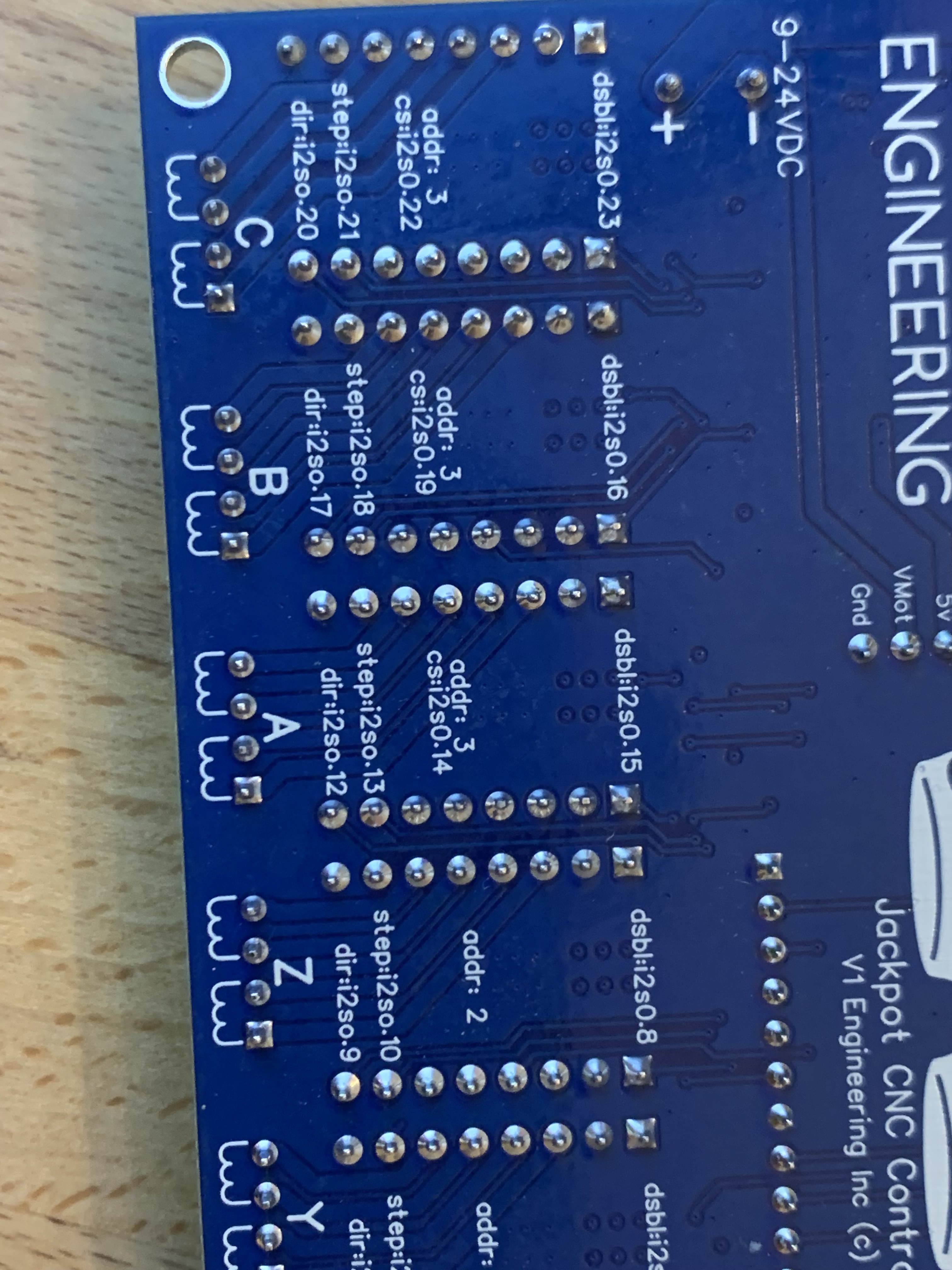

Can you post good clear well it pictures of the top and bottom of your board with nothing plugged in please.
The 3rd picture is the best focused.

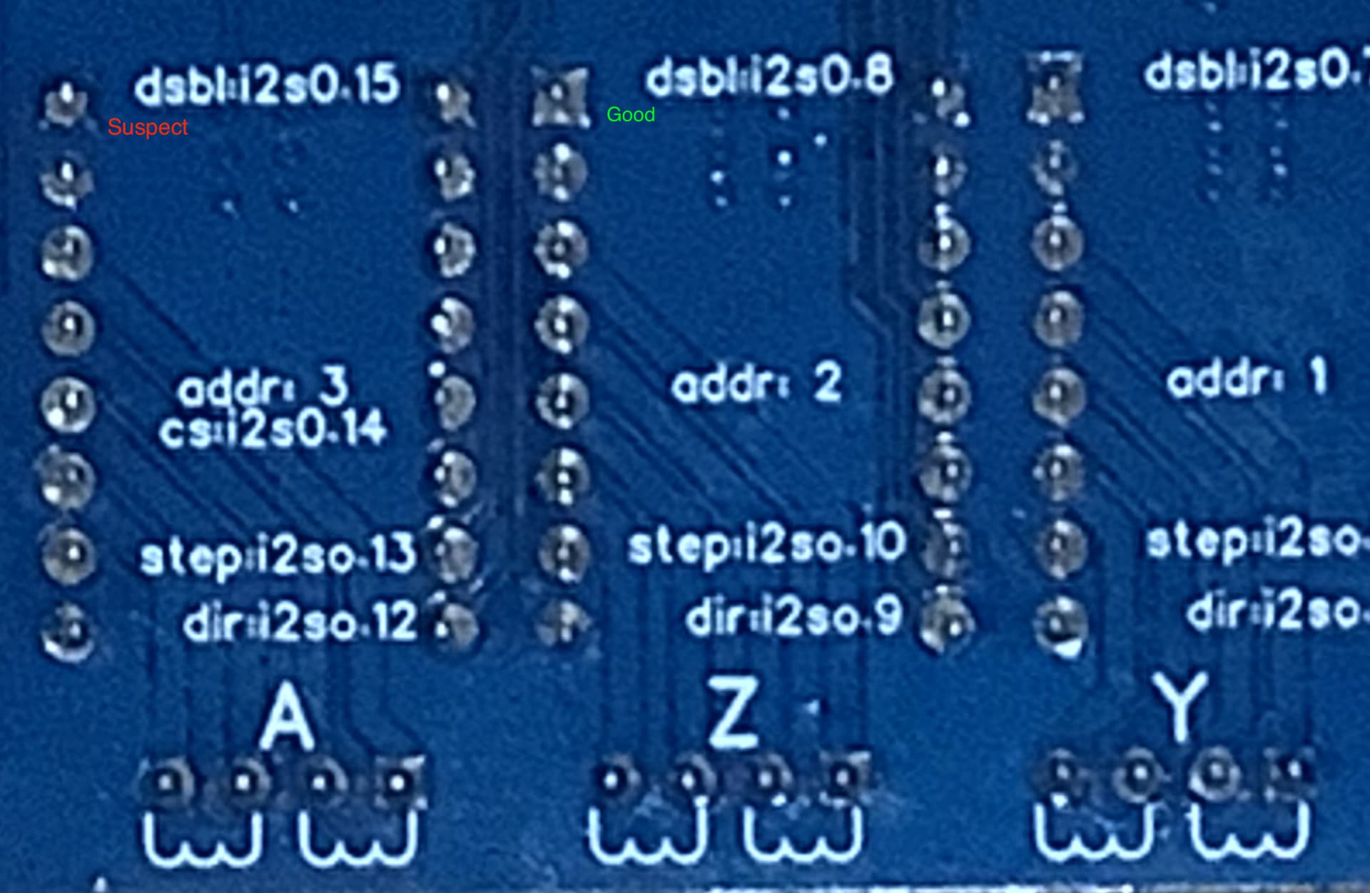

On the rear of the board, it’s a bit fuzzy, but note there appear to be differences in the solder wetting on the A stepper. Can you get a more clear close up of this portion of the backside?

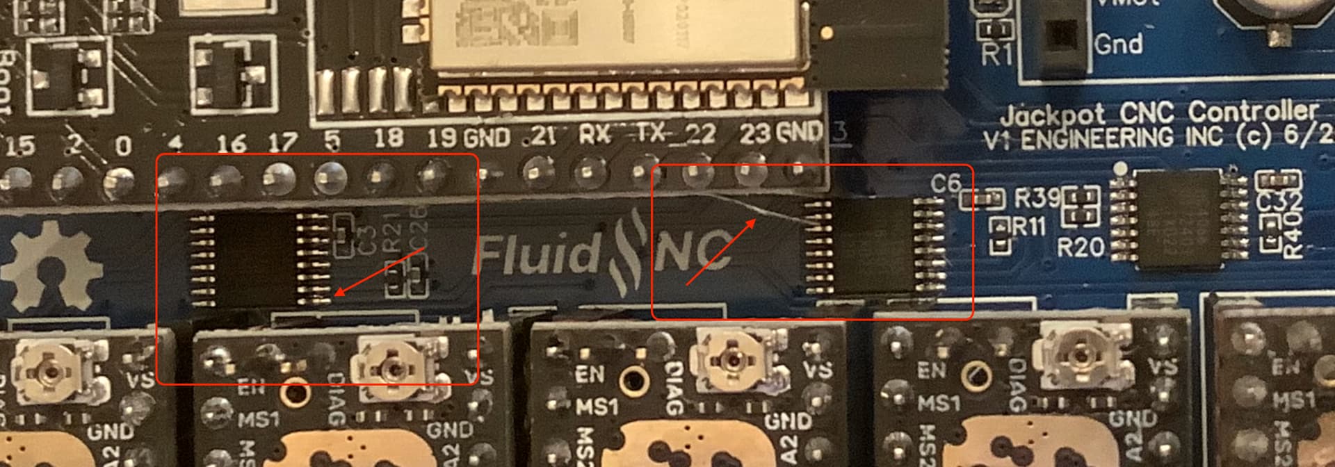

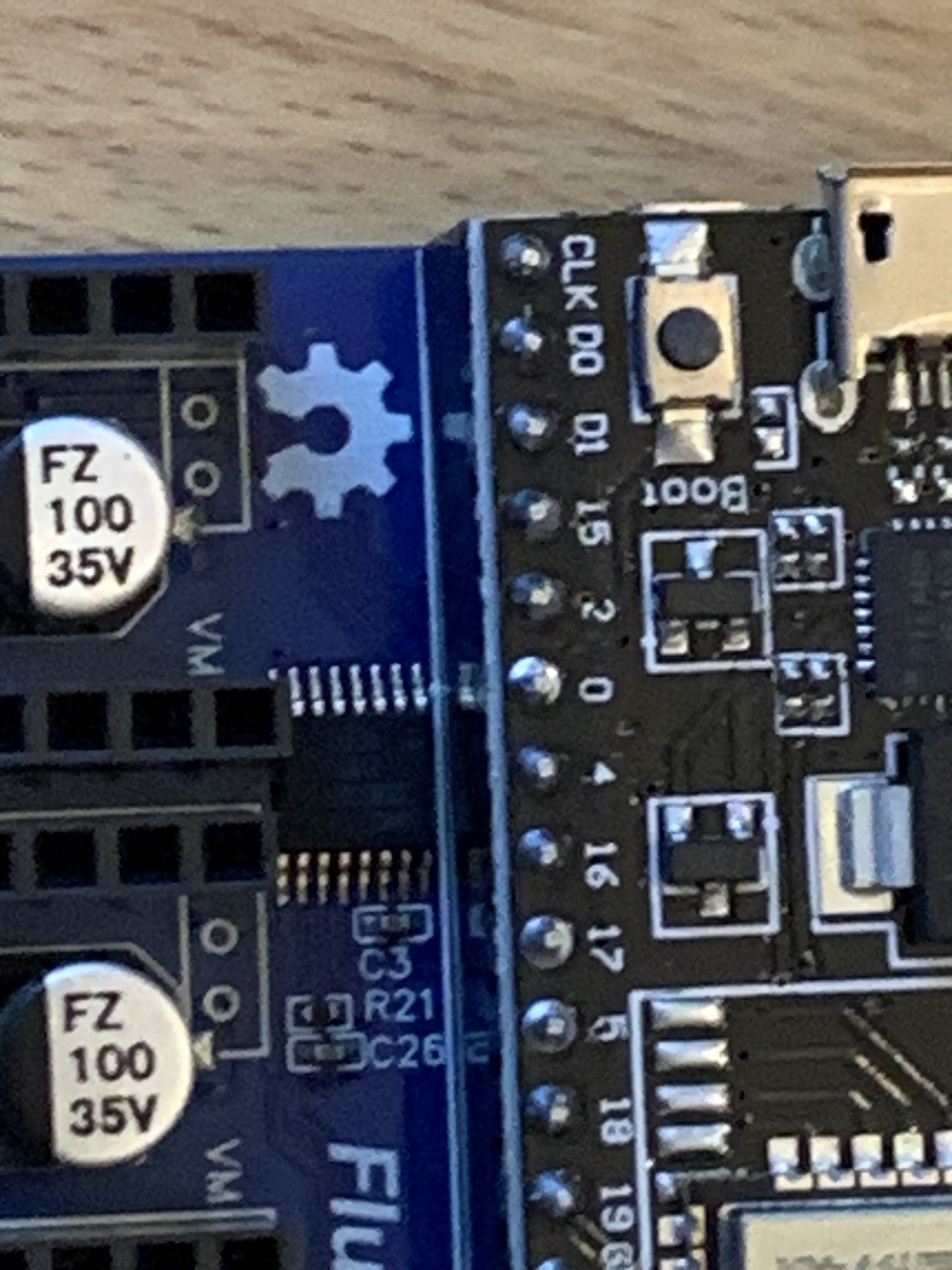

Also, in looking at the front, I see some things I’m curious about along the row of ICs above the steppers.
Can we see better detail here as well?
How is that?
It’s an improvement. Solder on the A TMC socket doesn’t look as bad in that view.
There’s an apparent scratch on the front side that I find pretty suspect, and I don’t like the solder work on the IC next to C3.
We’ll see what other folks think of this.

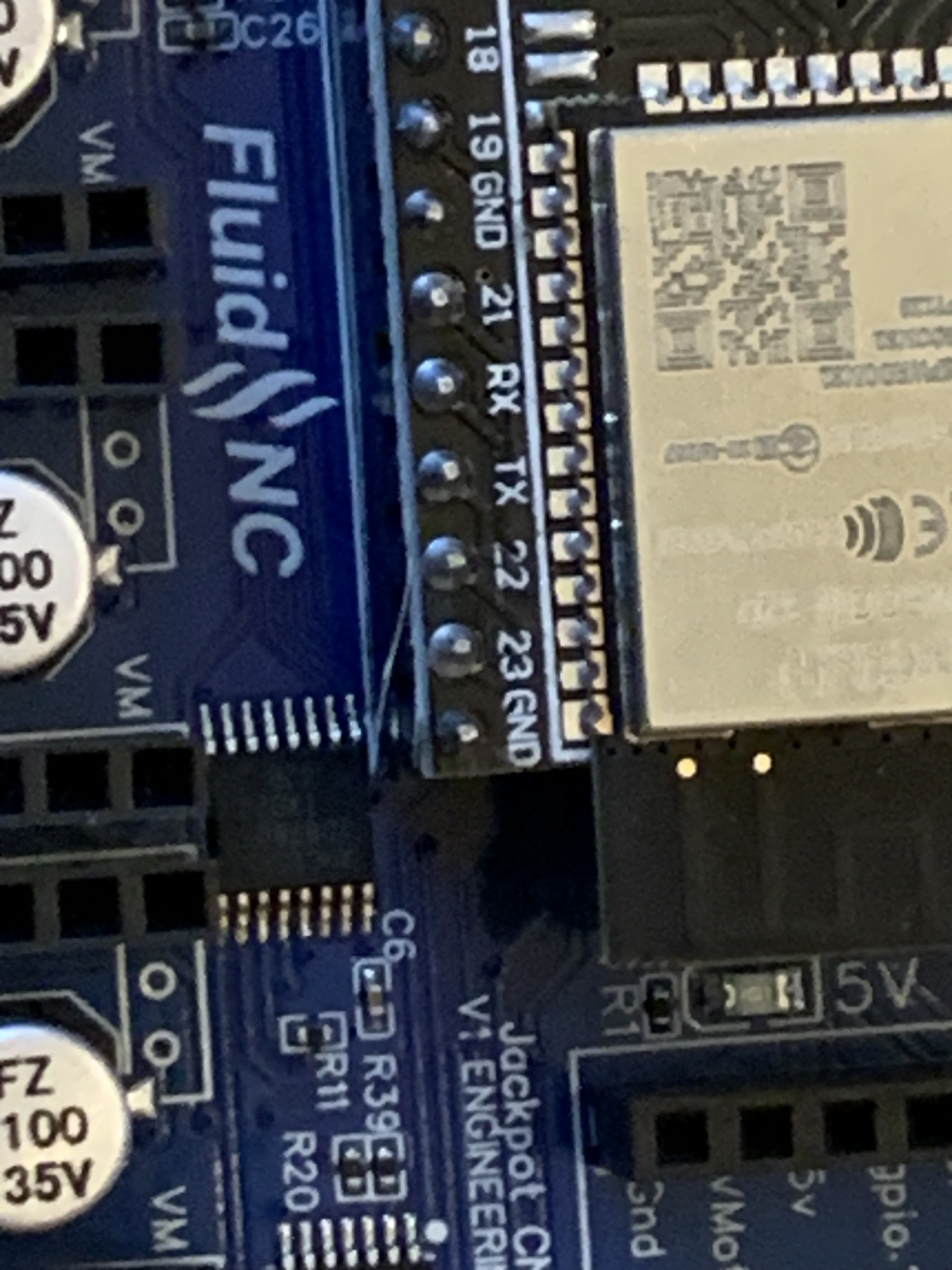

The scratch and solder work next to the ESP32 remain suspect to me and would potentially be impactful to A/B/C positions. If there’s an issue with solder or cut trace it seems this is the area to look at.
The solder on the back side doesn’t look as bad to me across it in the additional images as the first set did. Those pins remain not well focused so it’s really hard to tell- these are difficult to get good shots of.
Did you try using Ryan’s config file for this $ss? It would be nice to figure out if this is misconfigured or a hardware issue. If it still gives you that TMC driver not detected with Ryan’s config, then something is busted on the board.
Looks like a PCB thread hanging off the esp, unless it is a scratch?

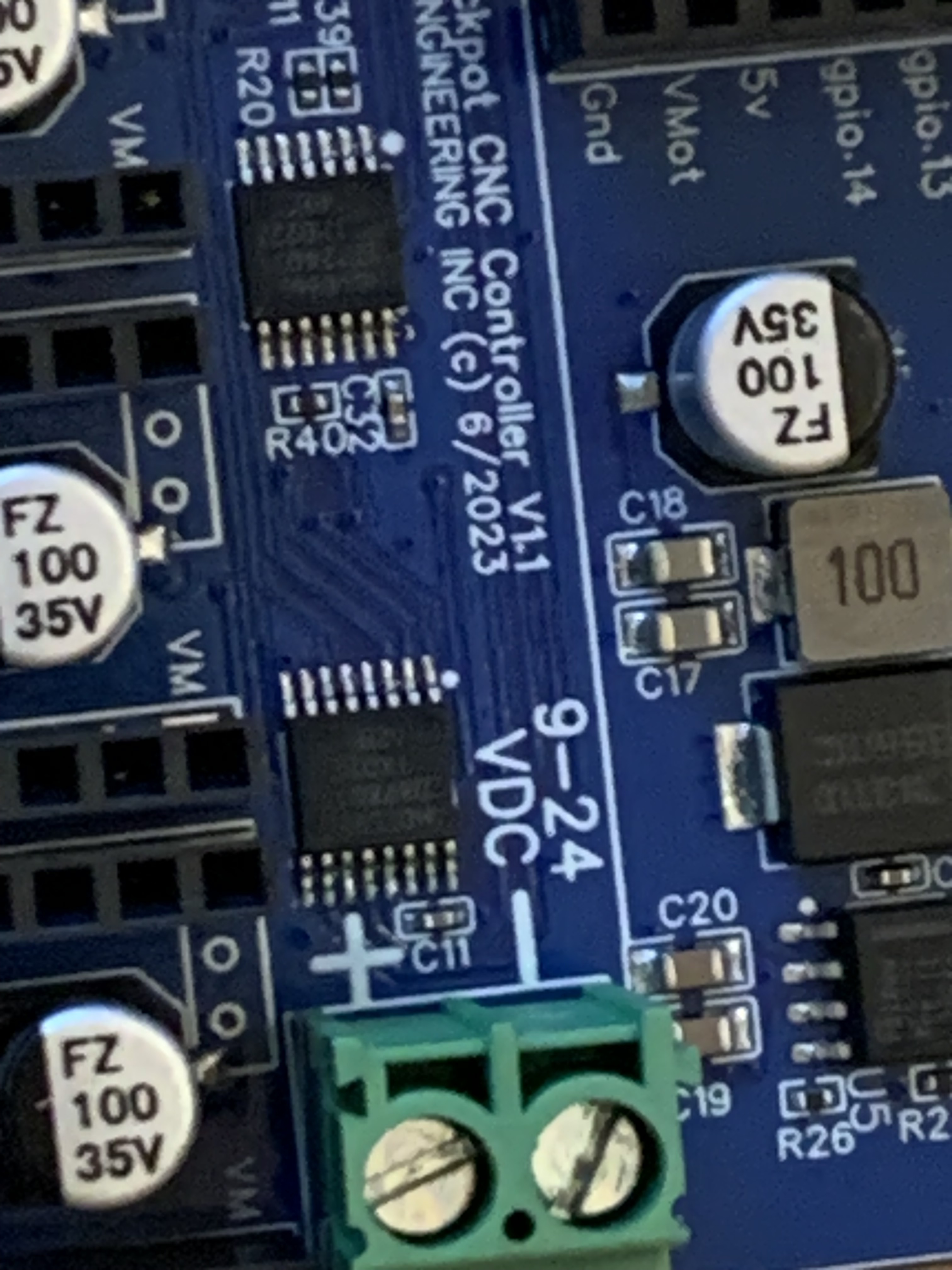

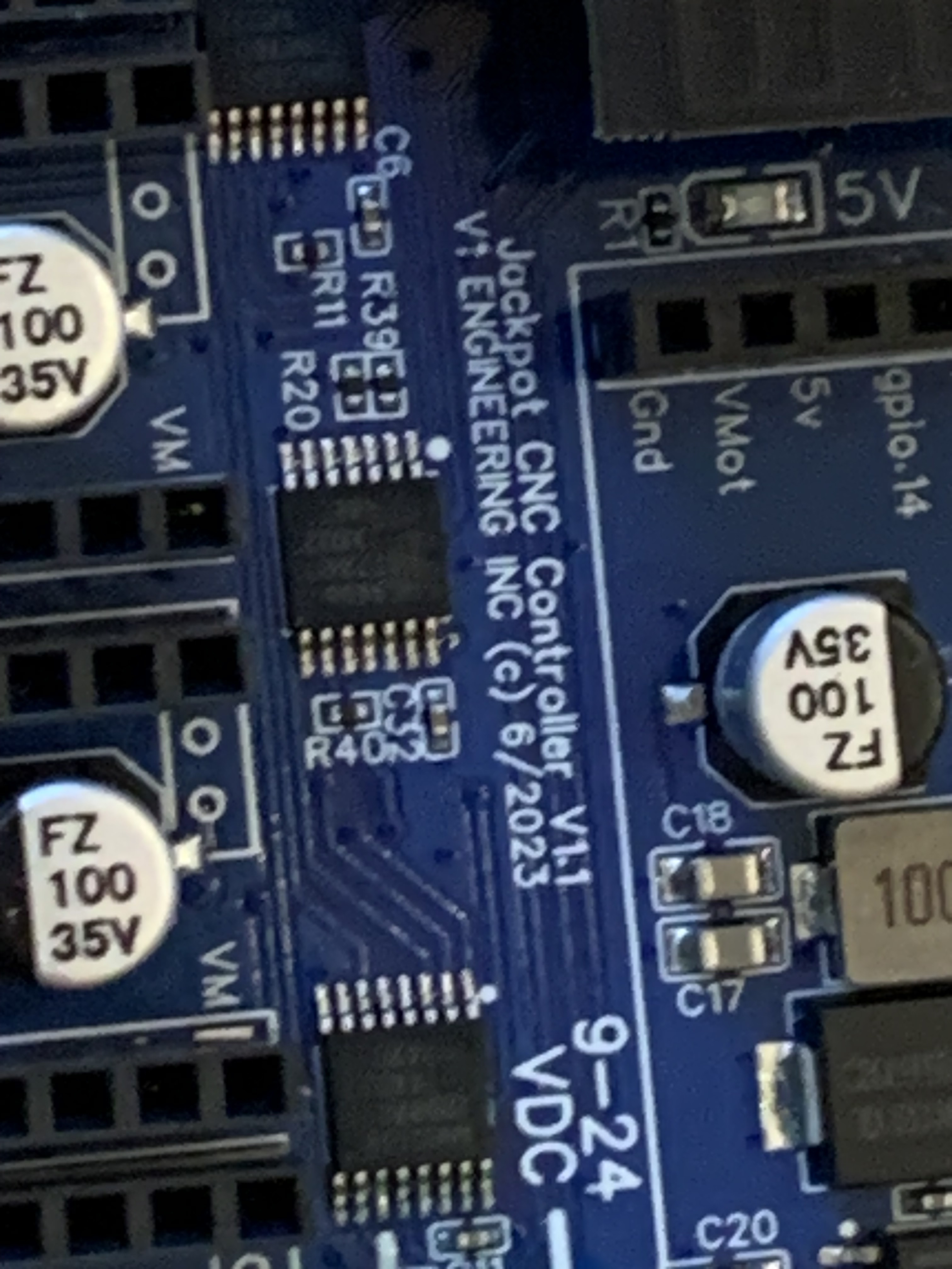

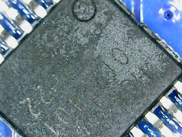

Swapped the esp, different drivers, I pulled off the headers, inspected all the traces, solder joints, and chips.
Best I figure is something happened to this chip, this thing looks a little toasted. The others are clearly legible, I even cleaned off the top of this before the screen grab, obvious issue inside.
1334343526881
Thanks for the patience, and the learnin’. I now test the boards very differently and working on an even better test jig. New board headed your way shortly.
Wow! Extra crispy
Done blowed up!
